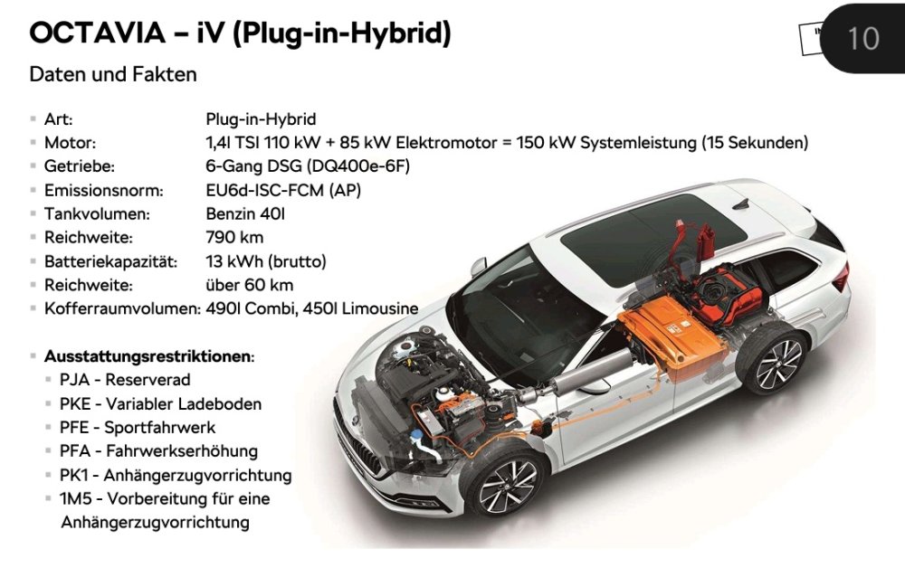

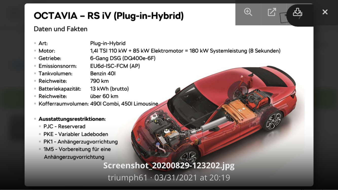

interestingly, the vrs is slower to 200 kph than the none vrs iv if you just keep your foot planted, see below:
 the max motor boost to 245ps is only for 8 seconds. Then it drops to like 180 bhp or something. The normal iv has max boost to 202ps for 11 ish seconds. Then drops to the same 180 ish bhp.

Actually just saw, the regular iv has full boost for 15 seconds, rather than vrs’ 8.

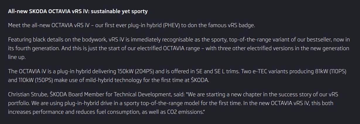

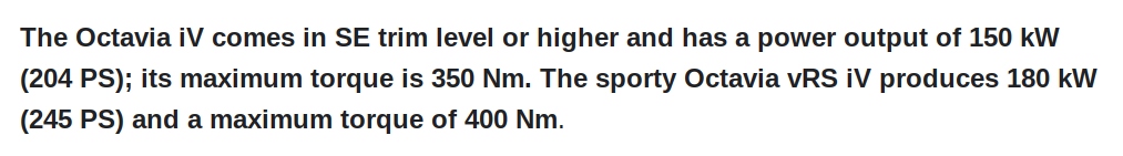

At the presentation of the car in Spain, Skoda told reporters that:
This maximum power of 245 hp is maintained for only eight seconds, seven seconds less than the 204 hp of the "normal" Octavia iV. Of these eight seconds, the power must not exceed 190 hp, which means that it can last 25 seconds. If we continue to accelerate at full throttle after these 33 seconds, we can only achieve the maximum power of 150 hp that the internal combustion engine delivers. "
