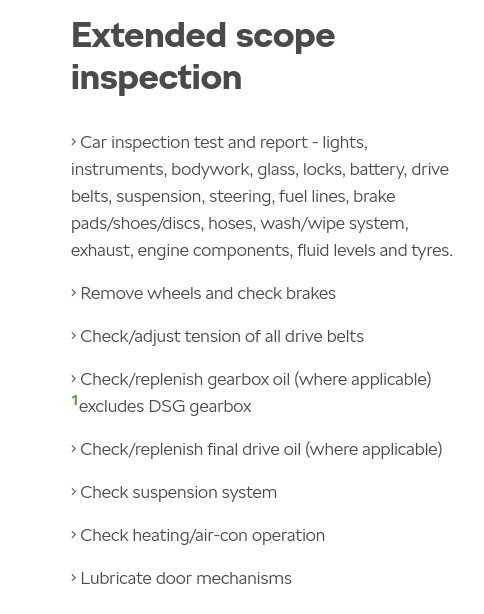

What does the service history show as done so far?
Even if aFull Main Dealer Service History, that can be a history showing what has not yet been done.

To be honest I have just purchased a fuel, pollen, oil and air filter for her, the oil itself was the last piece of the puzzle. She has had 2 Skoda service visits and "allegedly" a service by bcm, given the wheels were welded on through oxidation between the alloy and the bolt mount I suspect the bcm service was non existent. Thanks for taking the time to reply guys
Road wheels are not removed during a service, if they were we would be reading of wheels falling off after servicing on a regular basis, instead we get oil over/underfilled, differential oil drained instead of Haldex and the diff seizing etc etc.
They dont even remove the sump drain plug but that doesn't stop them from charging you for a new one which hasn't replaced the old one which wasn't removed. It's just as well really or there would be 10 dry engines seizing for every dry differential.
