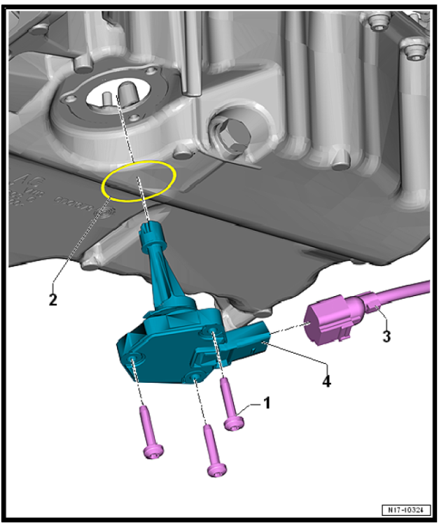

Four weeks ago I started to get a warning of Oil Sensor Workshop. It was very intermittent, it would appear and disappear multiple times during a journey. A search suggested it could be water in the connector, which my local garage found (unprompted) when I took it in. They said it had water in the connector, was giving an excessively high temperature reading and after drying and greasing gave the correct value.
Four weeks on and the warning is back. Can anyone tell me where the connector in question is please so that I can check it for water again, and try to determine why it has reappeared so soon?

Perfect, it is where I thought it would be, but here is image of locatation, bottom of the oil pan sump
895405038_Oillevelandoiltemperaturesender-G266-.thumb.png.748474f43e587fed04b3426bafa0e3da.png

Have you got an engine undertray fitted?
This should protect the oil sensor from water splashes.

That's brilliant, thank you. It's where I suspect it would be from what little I'd found online. Time to find a friend with ramps!

Should be. I did hit a 1-2 inch deep puddle on the offside about a week ago so perhaps that's the trigger. On three short journeys yesterday and today the warning hasn't come up. I'll still see if I can get a look at it though.
