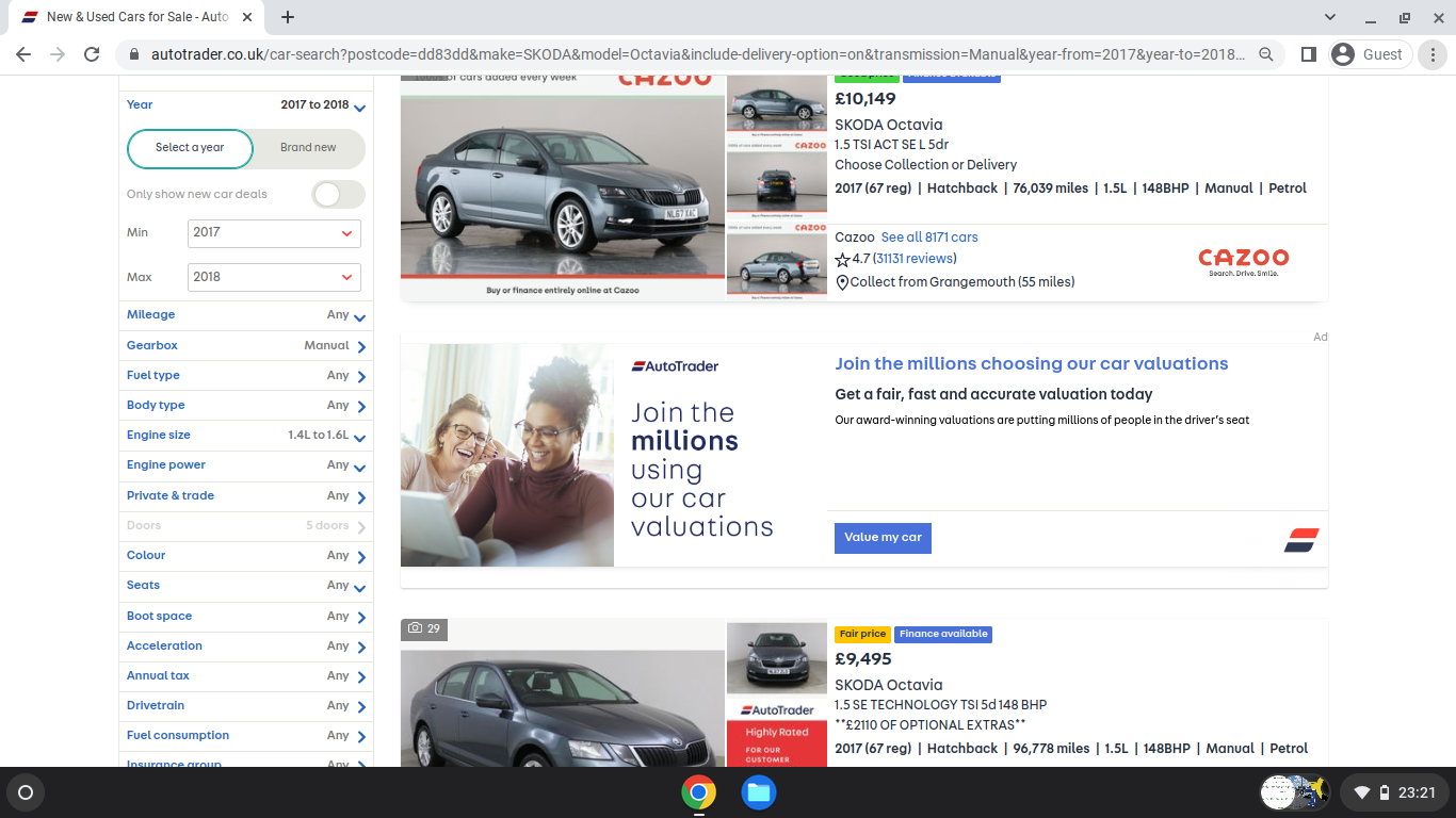

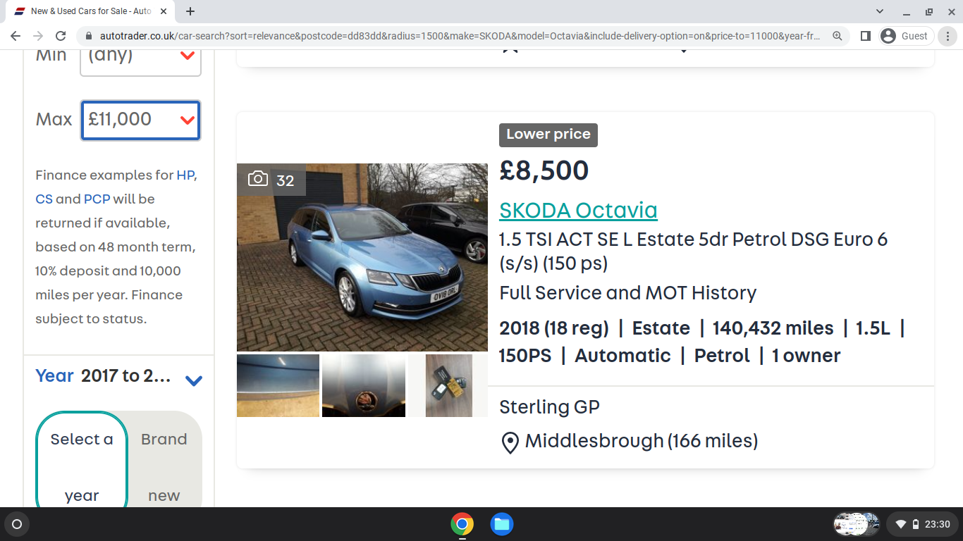

There are issues there long term with 1.5 TSI's.  & we have not been long term yet know how they go.
There was the early Kangerooing.  That should be sorted, not all are.
They are more complex with ACT, but fingers crossed.  They have a GPF, time will tell.
The Cam Belt and tensioner replacement at 5 years is more expensive than with a 1.4 TSI.
So hopefully newer is better, but that is not always the case. Tried and tested can be better on the wallet.
I don't think it's a problem here - don't think the budget of £10k would be enough for a later 1.5tsi.
It will come time with the early ones that were rejected, never addressed and in the trade and still kangerooing.
Barge poles come to mind.
Be sure to get a good long road test starting from cold, Do not let the sales person warm it up.
Edited by toot

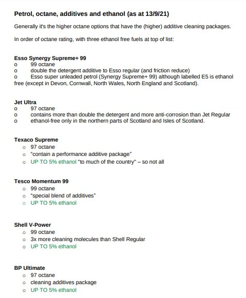

@Phoenixboy You have a pretty new car.  You should not have issues, not even the slight ones you do have.
You are only about £2.50 a tank more for Sainsbury Super Unleaded 97 min or Tesco Momentum 99,
maybe even no more expensive depending where you buy your E10 95 ron.
Cold weather is really not that relevant to if you feel any benefit from using it.
Edited by toot
