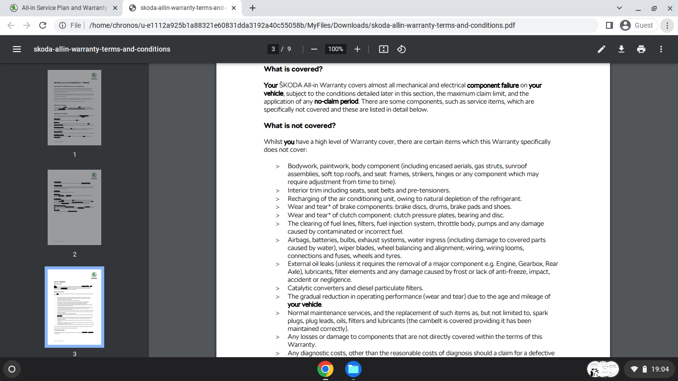

Does the T&C's of the 'all in service' really cover a clutch / flywheel replacement?
Wear & Tear exclusions.

This is why I'm asking really as I thought the same. The guy at the garage assured me that if there was evidence of something such as a leak of fluid on to the clutch / flywheel assembly then they would honour it. However, I have to agree to the £450 to find out.
