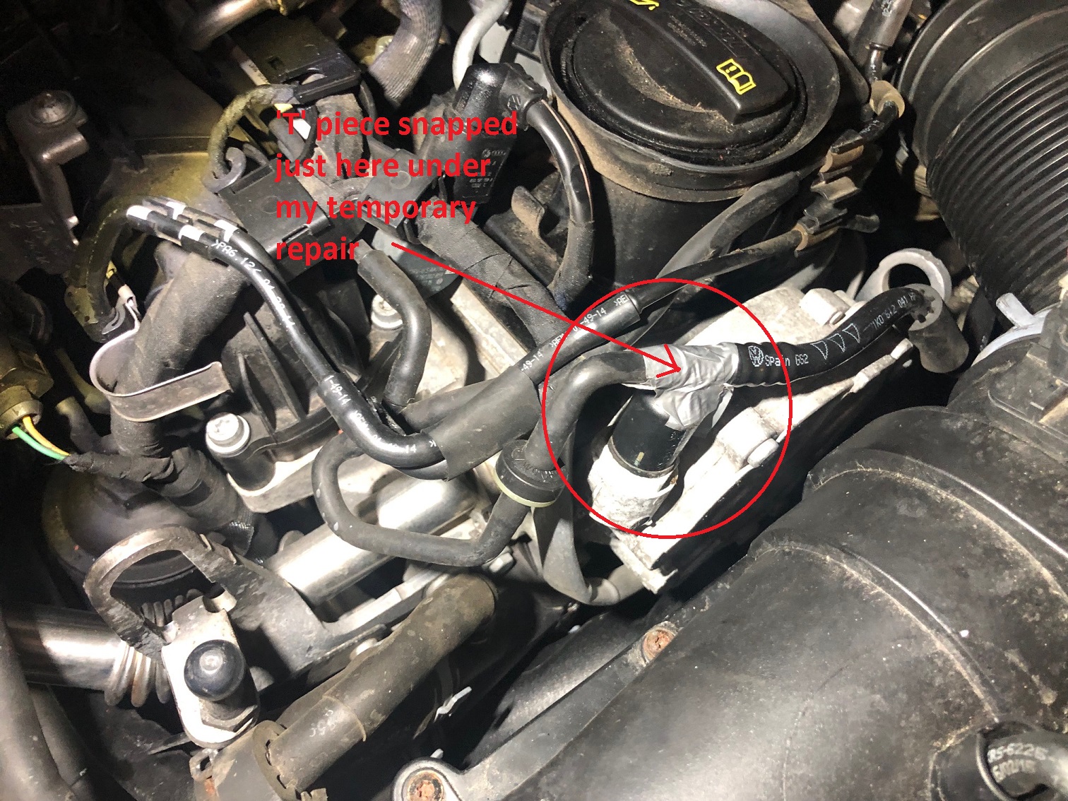

Hi All,
Whilst undertaking the dreaded EGR cleansing, my magnetic torch dropped from where it was secured on the bonnet and landed on a hose.
The result was a broken fitting that is allowing air to enter the system.
I have tried to Google the part with no luck, just wondered whether anyone here would be able to help with a part number or advice please?
Photos attached, Nick

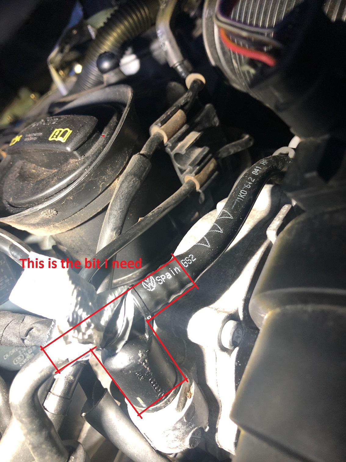

Engine code off your V5 will help, CAXA12345 for example.
Part number is on the hose 🤔
I hadn't seen that 🤣, thanks
I think that part number is only for the hose itself... so you still need the actual bit you broke (though that might have PN you need)
Managed to find a complete pump with hose attached for £10 on eBay incl postage...that'll do 👍
