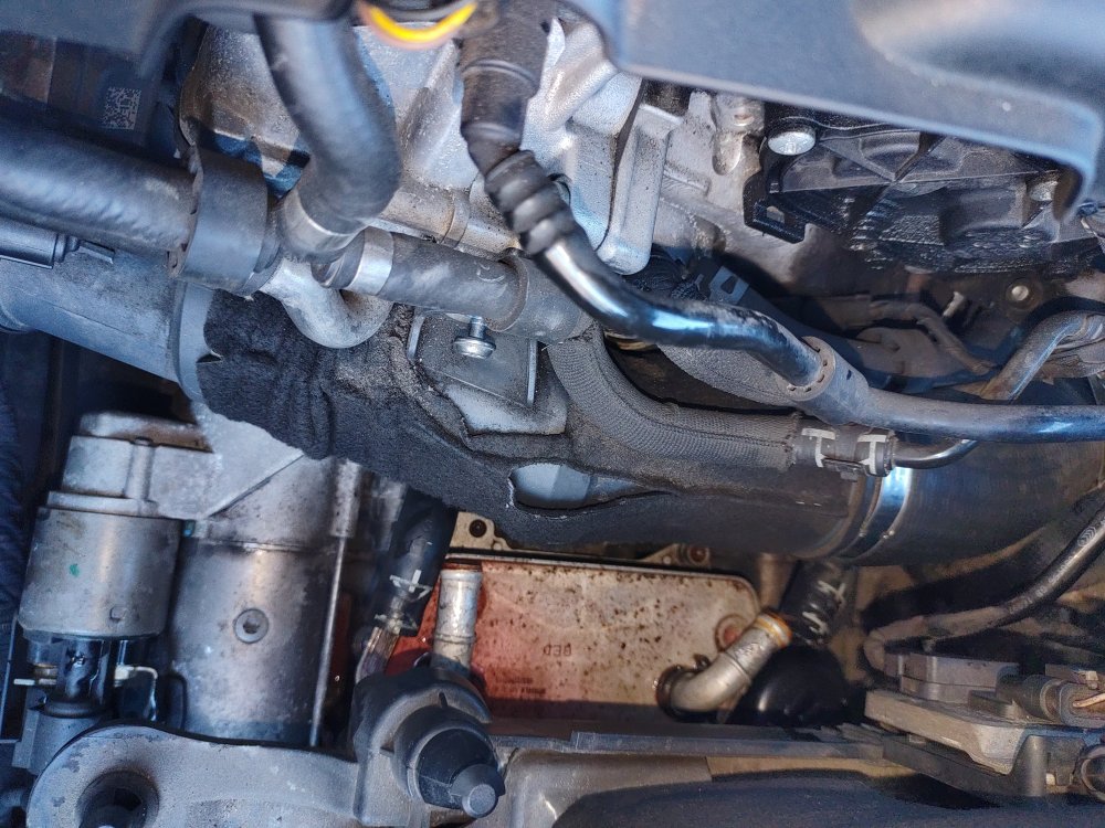

New to the forum. I have a 2016 2 litre diesel Superb and suspect my dsg thermostat needs replacing. Temperature guage up and down, as is the actual temperature. I followed some links and videos, have removed airbox, can see the dsg intercooler, but still can't see the thermostat. There is a long solid hose which I think is blocking it, don't want to go to the bother of removing it, only to find out it's not there!

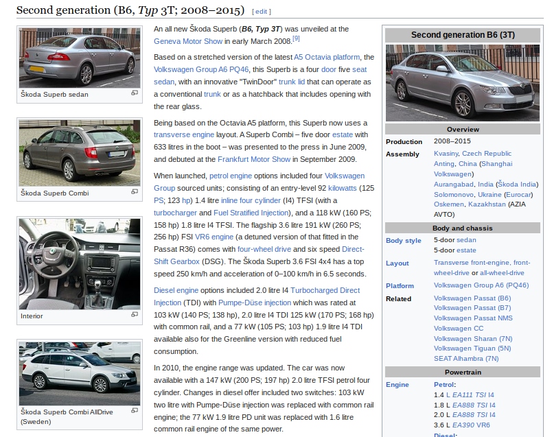

4 hours ago, MarkyG82 said:
Look again. Plenty MK2 dsg superbs on autotrader.
Oooops.......I am, of course, mistaken.
