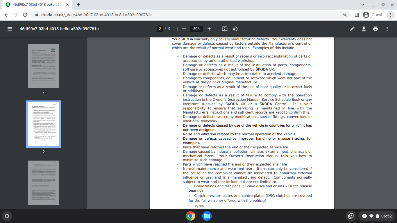

Would warranty actually cover clutch packs?  Dealer would say that’s wear and tear.

@DonweatherDealership staff and Skoda employees do indeed say the clutch packs are excluded in the warranrty.
THEY NEED TO READ THE WARRANTY THAT CAME WITH THAT VEHICLE, THEN CALL A FRIEND, CALL ANYONE, BUT GET THINGS RIGHT.
(Bottom line of current screen grab is a current UK warranty.)
The T&C's in the Manufacturers warranty and the Approved Used Warranty and the Extended Warranty are what matters.
DSG is not excluded now and there have been times in the past when not.
Then the Warranty at the time of purchase is what matters.
If an Extended Warranty covers a DSG then it is 'Simply Clever' to buy one IMO.  Running a DSG without one has been a risk with a DQ200,
and now with DQ381,s i would not take the chance.
