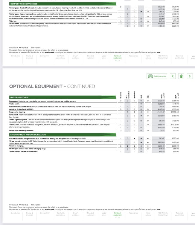

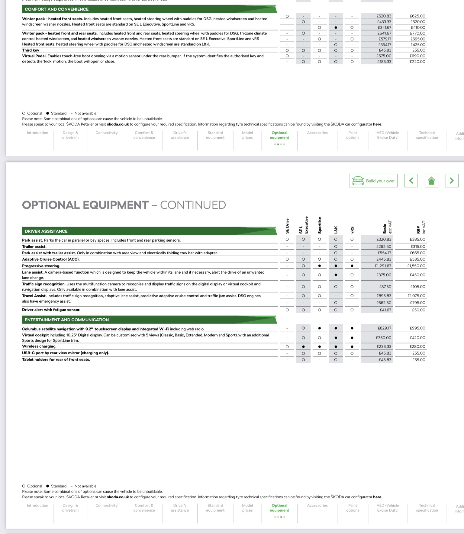

According to the August 2021 brochure I have,  Blind spot was a £575 option, or you could get Lane assist and blind spot for £1000.

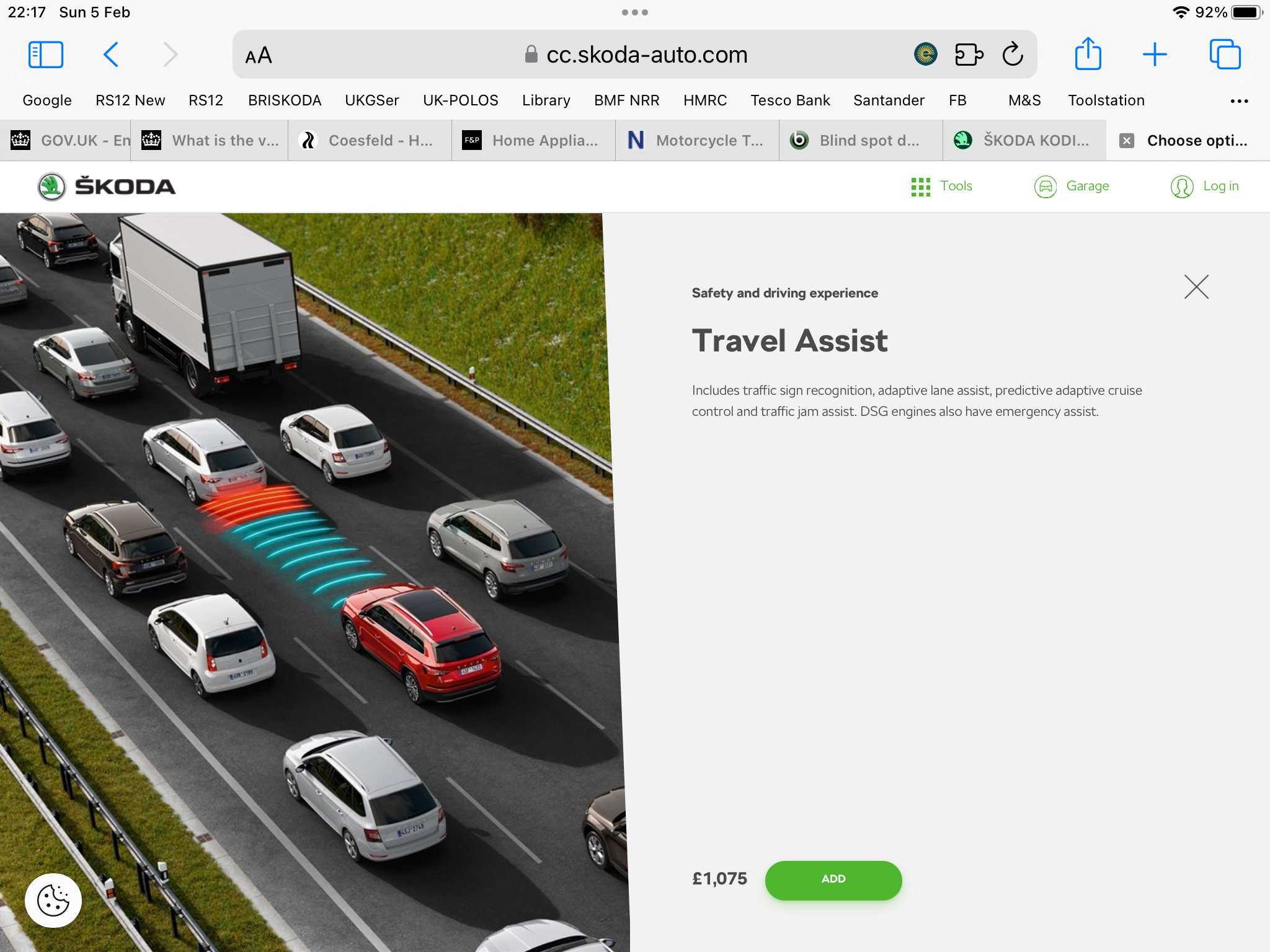

The Travel assist pack was £1020, and does not include Blind spot detection.
Attached is from November 2022 and as you can see the Blind spot options have disappeared. The Travel assist pack is still available, but as before does not include Blind spot detection.
