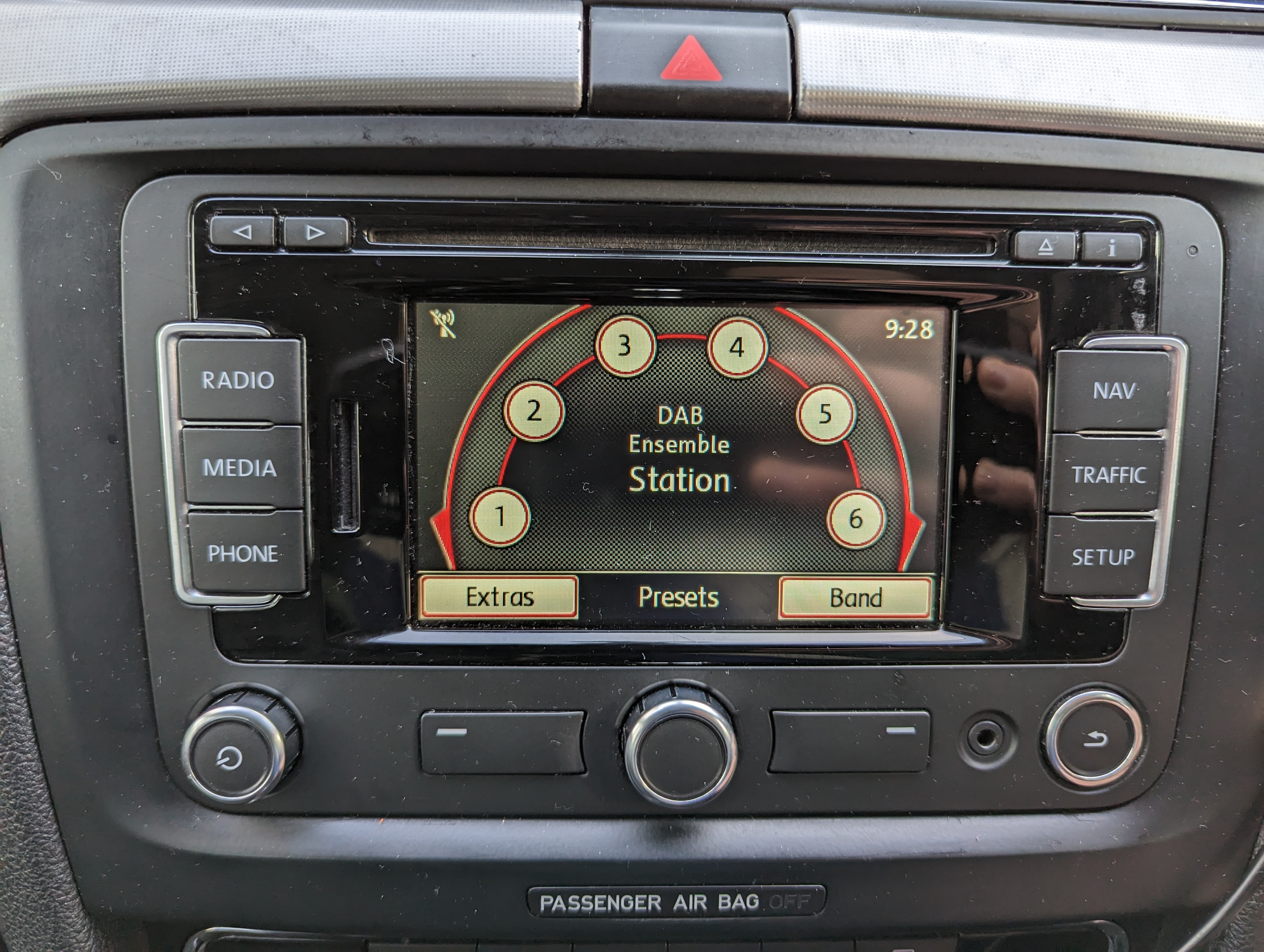

Hi there,
My MKII Superb came with the incorrect head unit. It works completely fine, but my OCD doesn't like it not matching perfectly 😂
It's currently got a VW branded RNS 315 unit. Which as I said, works fine. But the lights are the wrong colour etc etc.
I want to buy a Skoda RNS 510 Columbus. Which is what the car would have originally come with.
I have conflicting information on how complex this is to do. Some videos look like drop in replacement (unplug replug jobs done), others mention "coding" something I am very unfamiliar with.
Any information would be MASSIVELY appreciated before I try and buy and sell the units.
I have also been confused by the existence of "codes". Which appears to be some kind of password that the units can have on them.
I have attached a photo of the currently installed unit incase I got it wrong.
Thank you very much

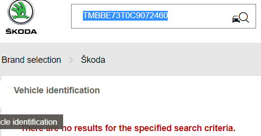

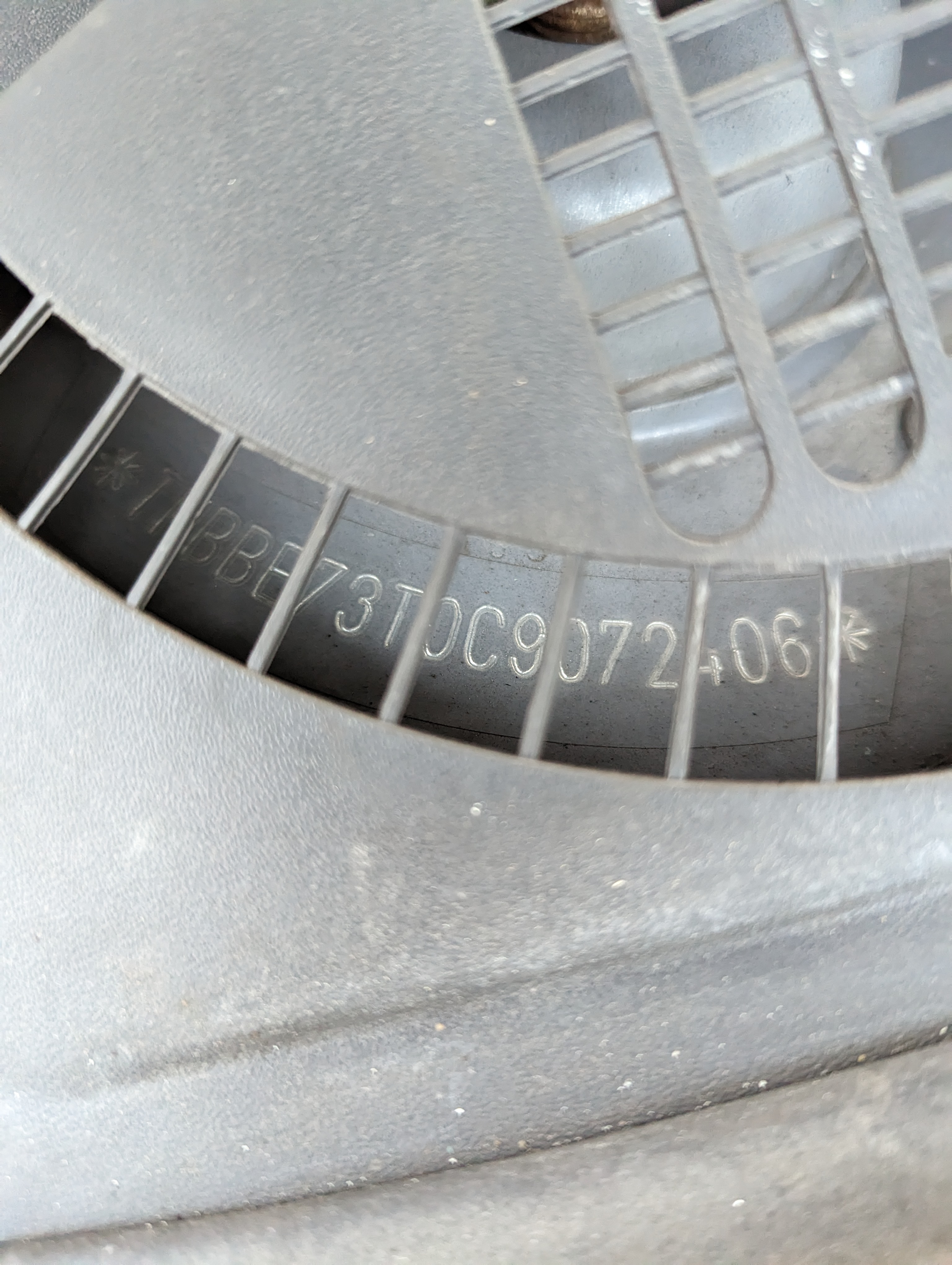

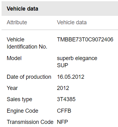

VIN?
TMBBE73T0C9072460
31 minutes ago, pab567 said:
VIN?
Realised I didn't reply it to you haha
TMBBE73T0C9072460

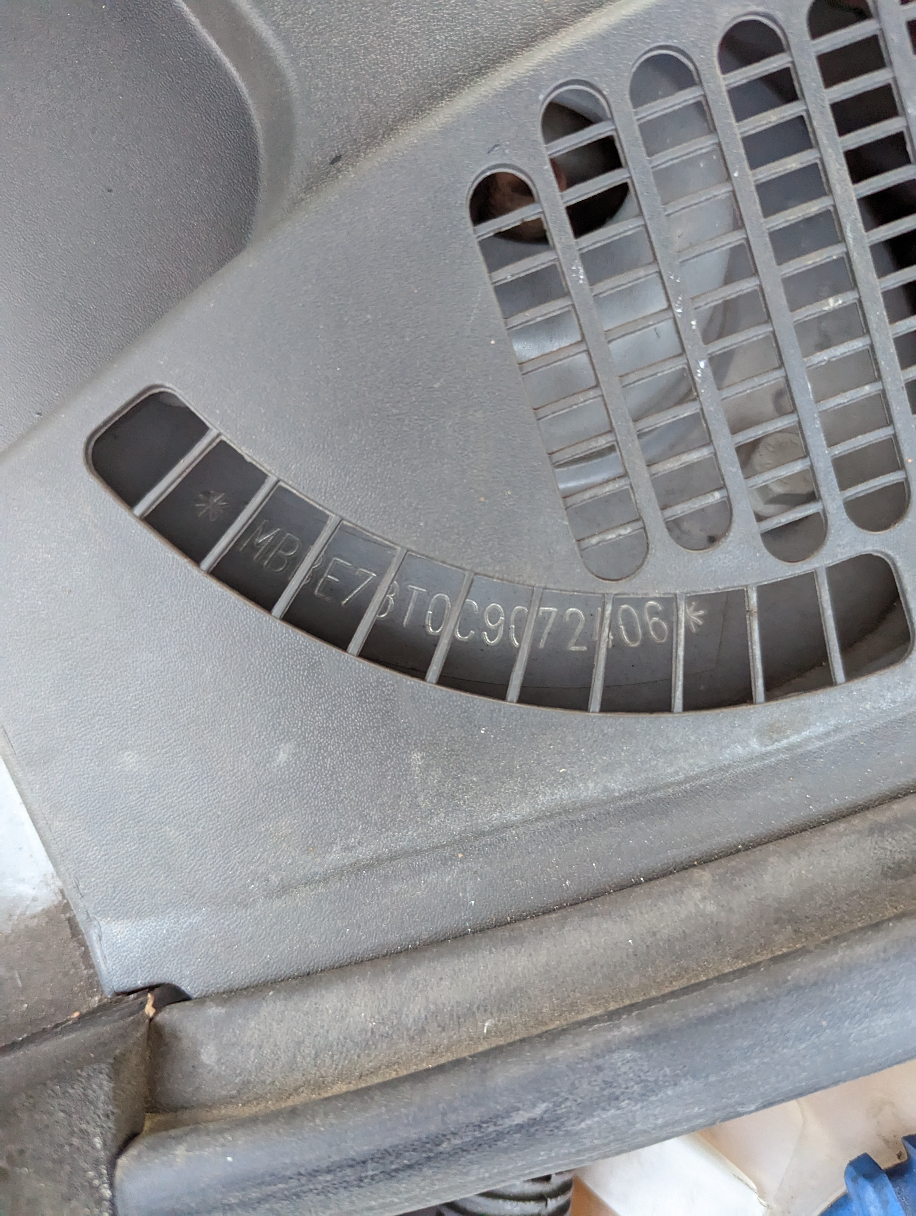

Wrong VIN, pls x-check
39 minutes ago, AverageMax said:
TMBBE73T0C9072460
TMBBE73T0C9072406
Now it's OK:

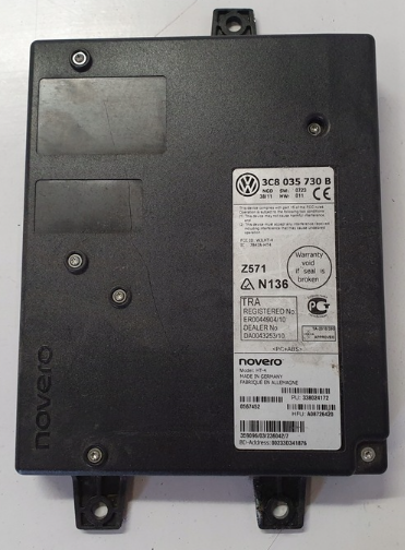

Originally your car was equipped with BT module 3C8 035 730 B ,do you know if this is still the case?

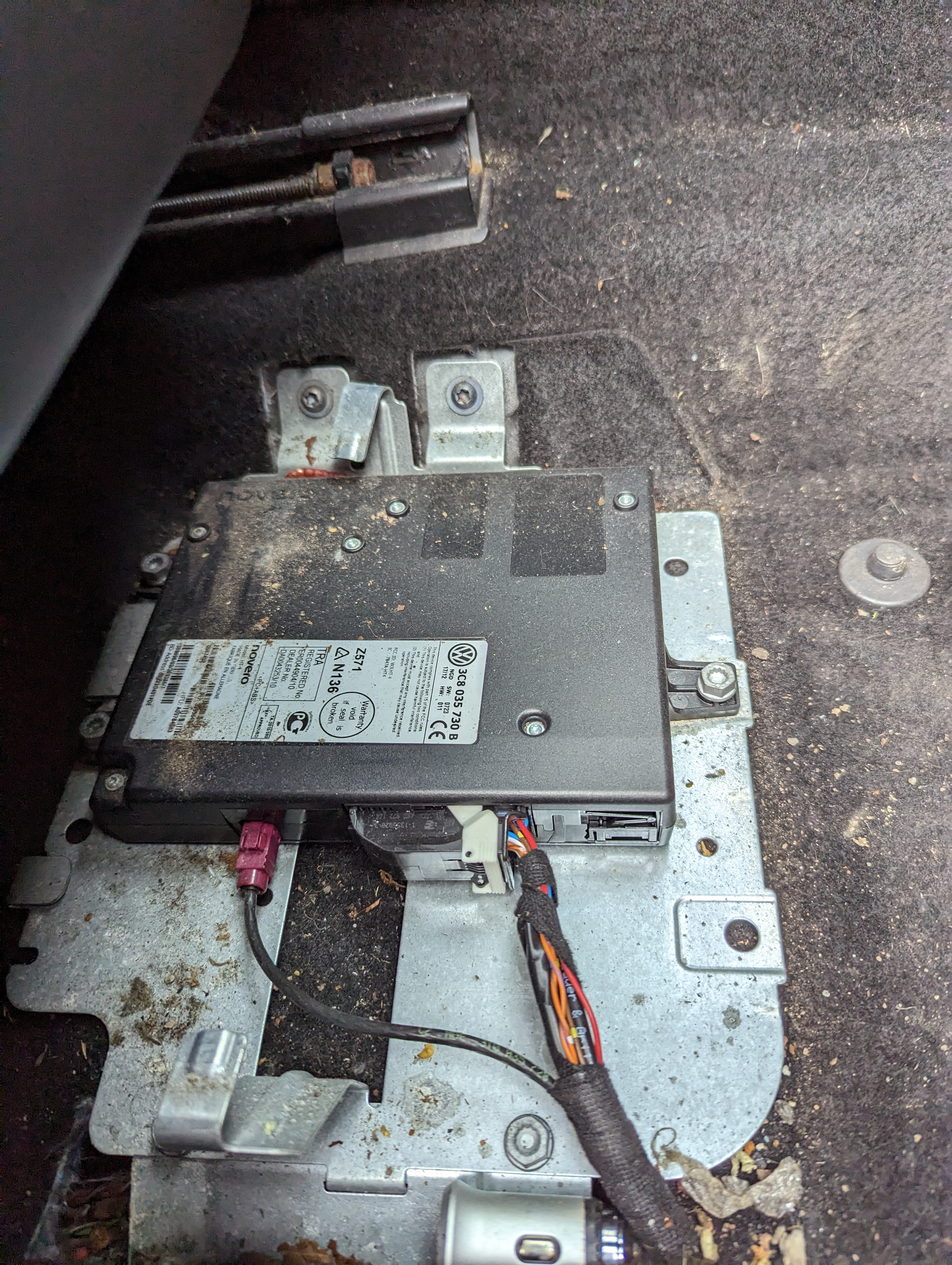

What about BT module? Do you have VCDS. Vag Can Pro, OBD Eleven, or ODIS? If not, pls check if you have a module under driver's seat.

Both work the same way so it's really crucial to determine if you still have the original one under the seat.
I will have a look in a bit. What am I looking for exactly.
The name of the Bluetooth device I'm connected to is "SKODA_BT" if that's any help for now
Doesn't help too much.
This is how it looks, it shoul dbe located under driver seat, inside additional plastic cover
/cdn-cgi/mirage/6e1ec32684f68d3ea617cbded7624430e54d028498d7355e814863efae33c436/1280/https://www.briskoda.net/forums/uploads/monthly_2023_02/image.png.48ea89504a471e2868298b7b315ed6ef.png
Do I need to remove anything? Need any tools?
Or should I be able to see
The plastic cover removal does not require any tools and then you shoul dsee BT module under it.
I have the module
Good news! In such case you will need Columbus RNS510 model number 3T0035686x (x - any letter). This is unit with DAB/DAB+ receiver, be careful NOT to buy any other model number (e.g. 3T0035680x, 3T0035681x) as they don't have DAB/DAB+ receiver.
Instead of buying Columbus you can also get some MIB STD2 PQ unit, from Yeti FL, which will then give you more features, e.g. Android Auto and Apple CarPlay, and will allow you sell current BT module as these units have BT module integrated.
