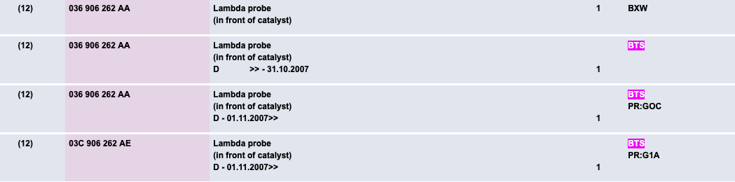

Which one of these is the right part number please?923993123_Screenshot2023-02-24at15_28_03.thumb.png.88145a832e391ce06e00fdf6f155f89e.png
PR: G0C = 5 Speed Manual
PR: G1A = 6 Speed Auto
So part will depend on your gearbox

No idea where you are finding the information from, here is screenshot from catalog with RO (Roomster) 2008 MY (8) and the dates line up with your build date.
MY is +1 depending on when it's made (switches roughly mid-year)
If you are trying to fit an aftermarket cable, then maybe there is differences in length?
The part number does fit many other models yes.

Anyhow, as you see from new post, the same probe is used for a wide range of VAG vehicles, so plenty of choice.
If you see another make/model and wish me to check it is same for SEAT for example I can verify.
