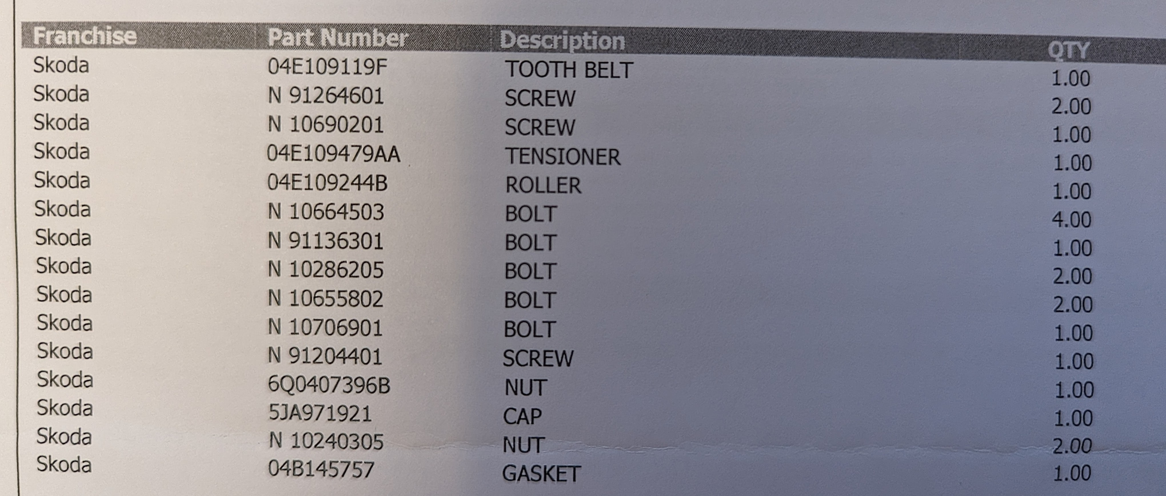

I'm trying to find the similarities/differences between the work done on my car and the work done on yours so we can try and narrow it down - do you know if your garage used genuine Skoda parts for the cam belt and what the part numbers are? If we are both genuine Skoda parts/same part numbers then it's maybe a duff batch of parts that we have both been hit with? I'm presuming that they are also following the Skoda issued guide/instructions for the work? Wonder if there's an error in the instructions? (Seems a bit unlikely but you never know...)
@MB21790715644_PXL_20230515_1930408912.thumb.jpg.84be0cd48b7decb0aacf851bed9394ca.jpgFor reference, this is the parts list that was included in my paperwork from the garage - be interesting to see if our parts list matches
