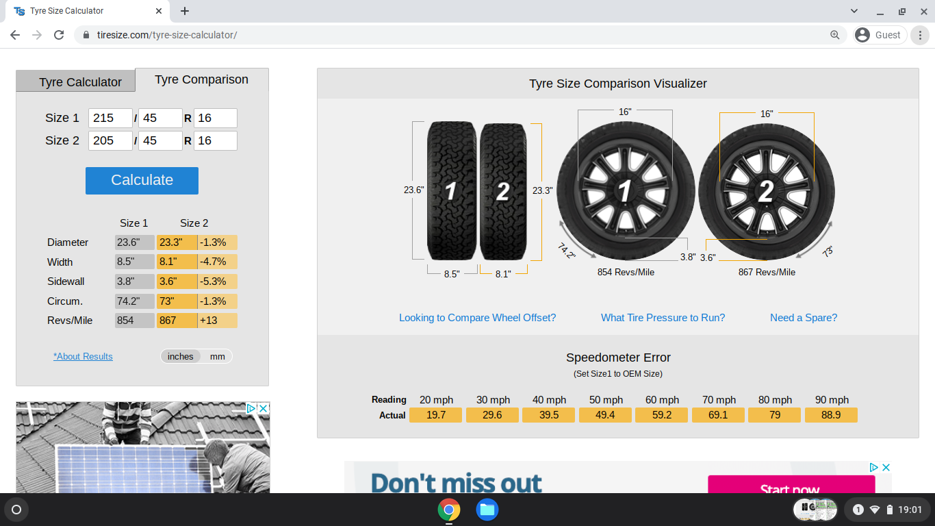

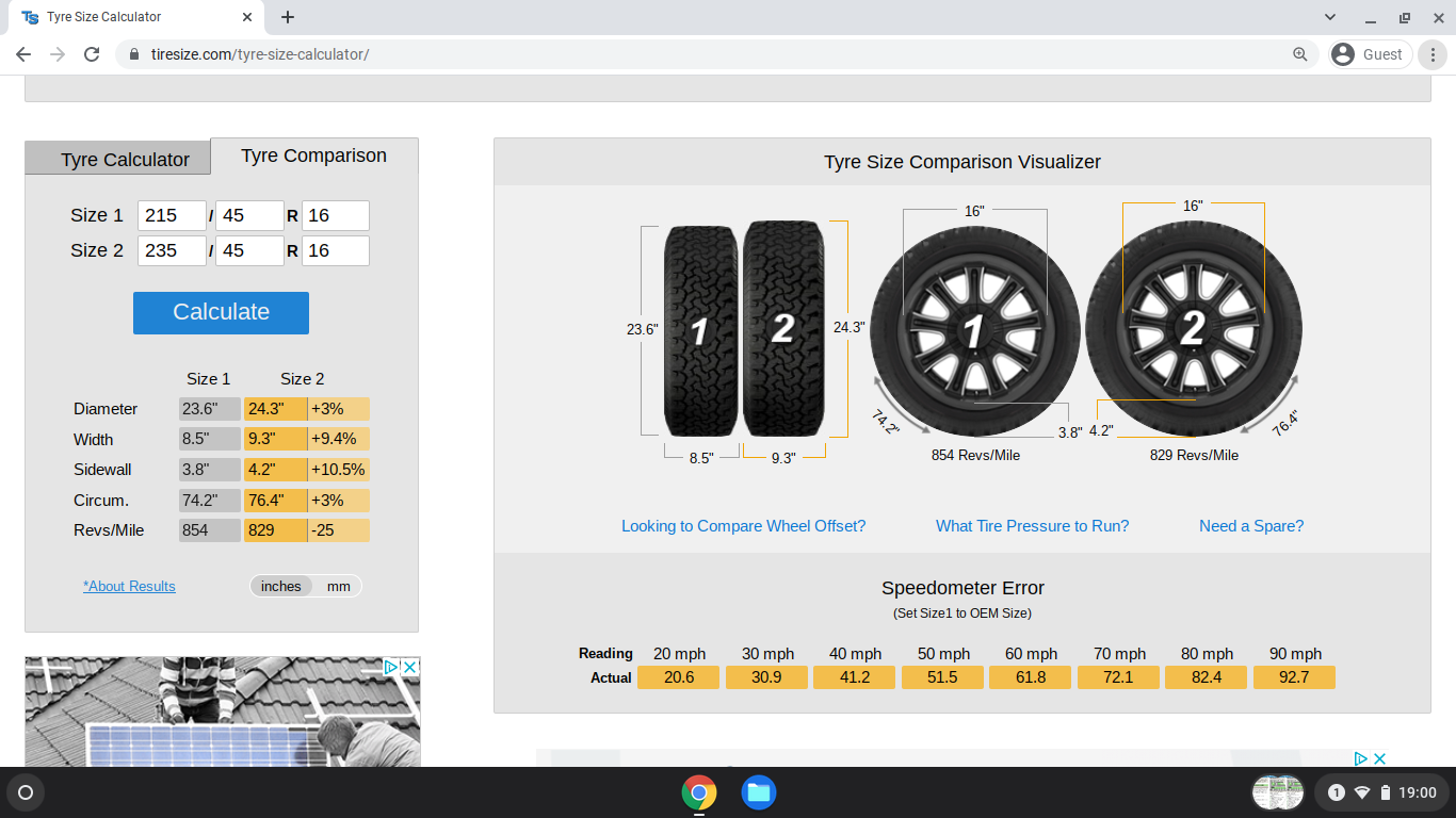

I'm looking for some advice on tyre sizes. Recently bought a staggered set of wheels that were originally for another project but I think I'm going to put them on the Roomster. They're 16", fronts are 7.5J so I was thinking 215/45 16, rears are 9J, would 235/45 16 work? Not interested in the stretch look. Think I've worked it out ok going by standard 16" Roomster size of 205/45 16 on a 6.5J wheel.

A bit big tyres size for the rear, but someone will be along with the knowledge and experience.
Also maybe someone with all the figures and no experience.
Fronts are et 35, rears are et 15
They're Schmidt Modernlines
