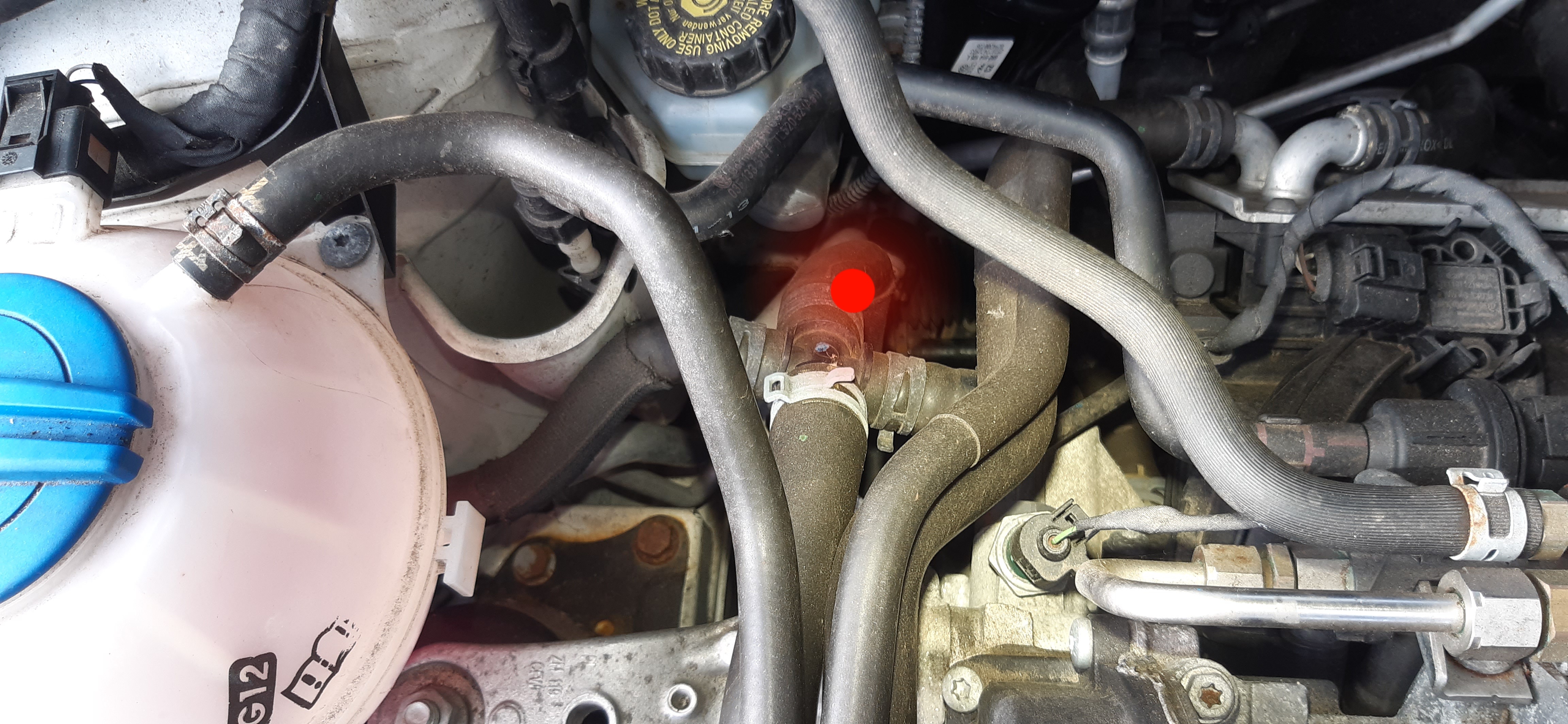

Hi,
I have a leaking coolant hose but can't find it on online diagrams to order a new one. My Rapid is 1.2tsi. I've marked the hose with a red dot. Any help would be appreciated.

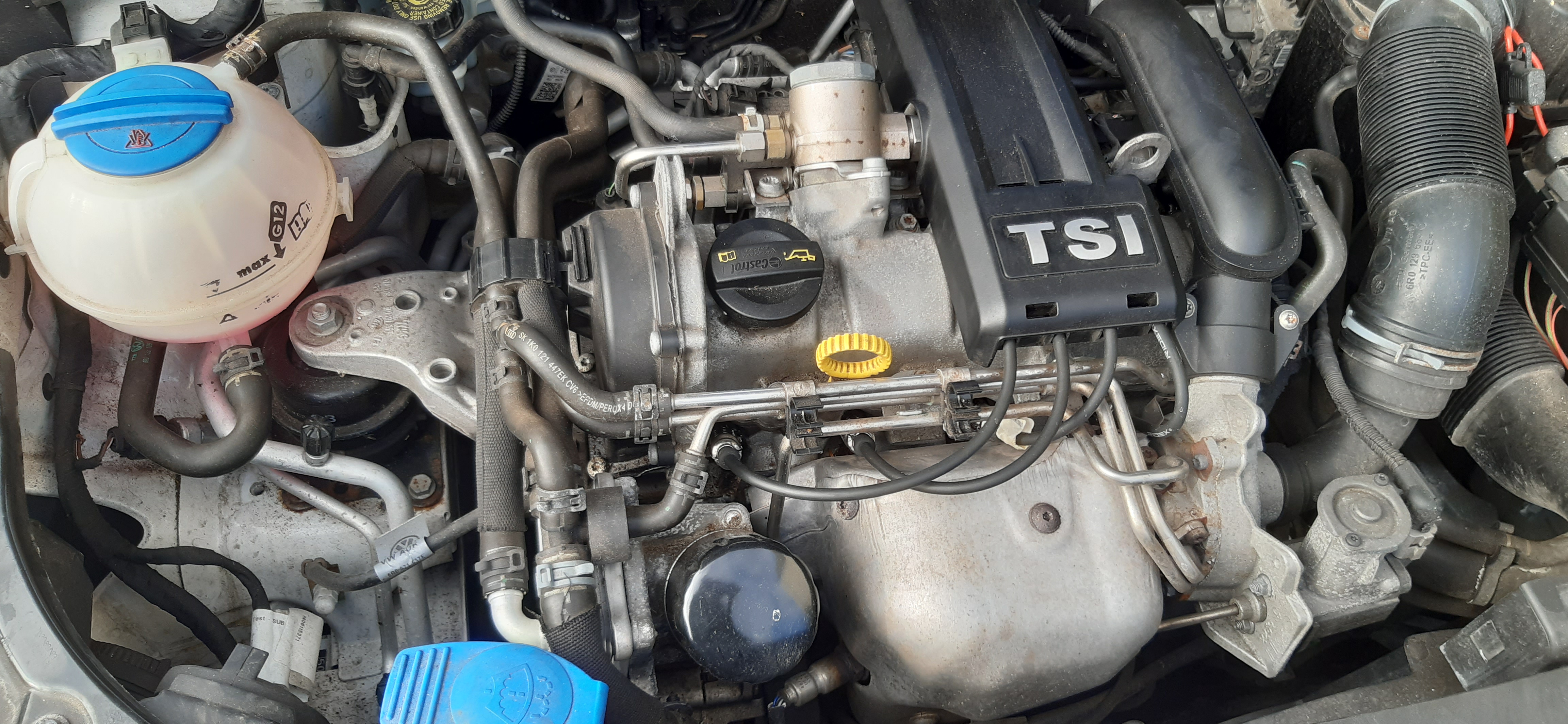

iam having a small issue with a smell of coolant,
On 06/03/2023 at 23:14, inspectorman said:
The online diagrams are pretty horrible without the engine in  front of you but this might be your engine - CBZA or CBZB
image.png.80c081140307c36c631d963a8bd7378d.png;
Doesn't look like it comes as one hose.   Link for all these coolant layouts is at https://www.lllparts.co.uk/catalogs/skoda/CZ/RAP/740/1
