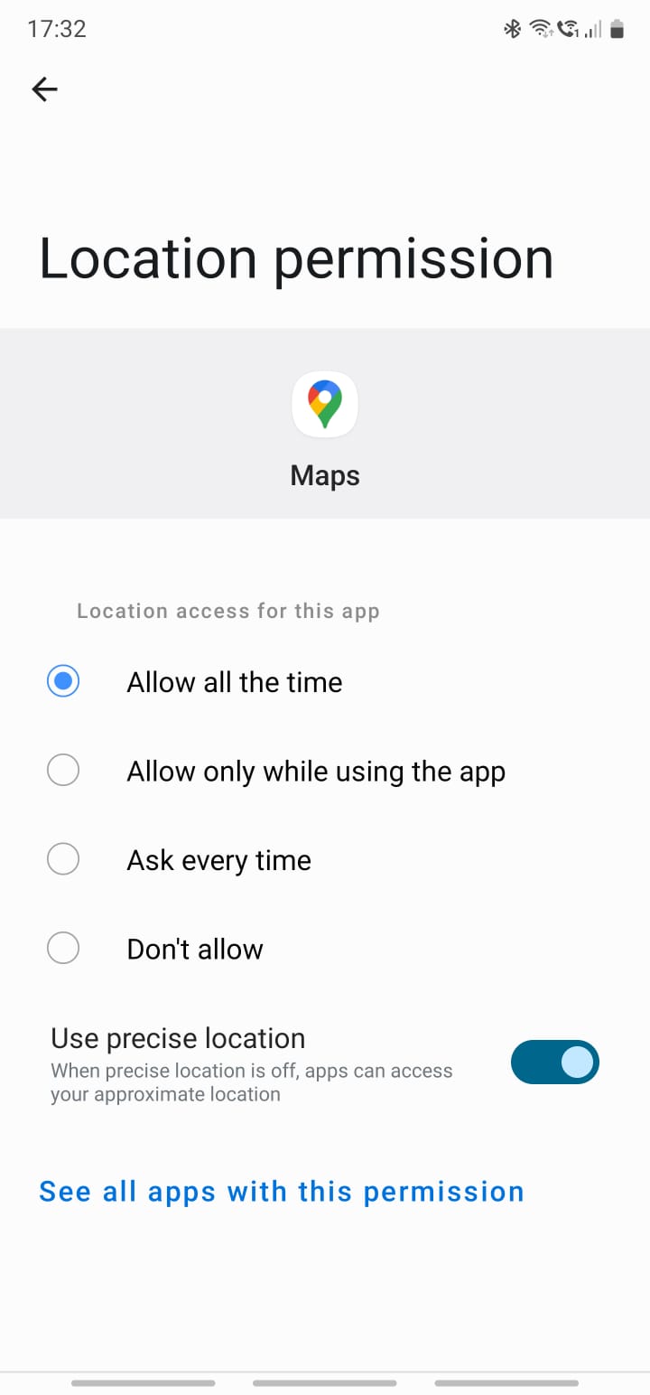

On your phone go to settings then to 1.apps
2.then find maps
3.then to permissions
4.then to location permissions
5.at top should say Allow all the time press on that so it  turns blue
That should solve your problem it did myn let me no how you get on ok
2.then find maps

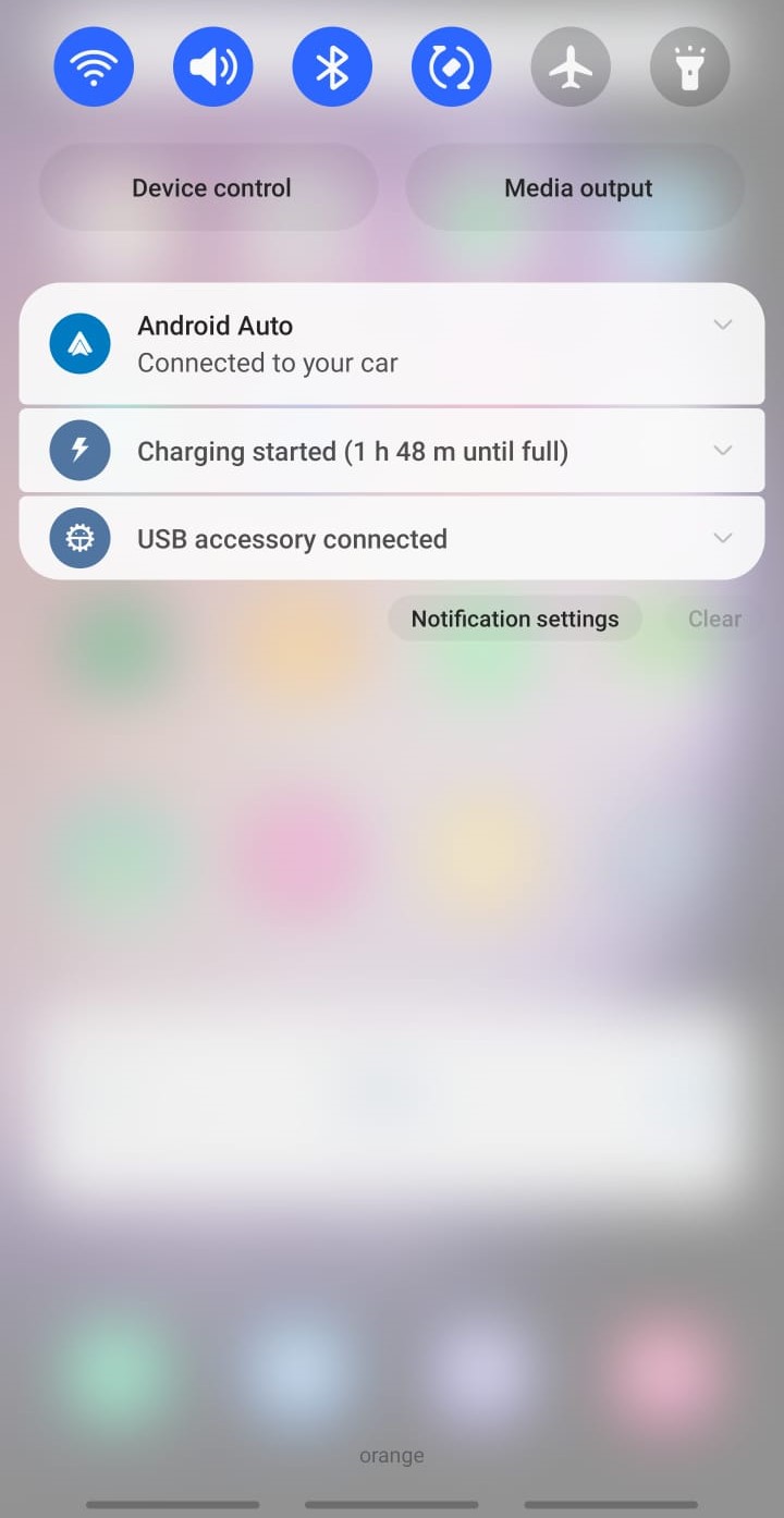

Not working, as i told you it is Android Auto that does not seem to start, cannot see the solution in setting Google Maps with permanent location permission.
Thanks anyway.

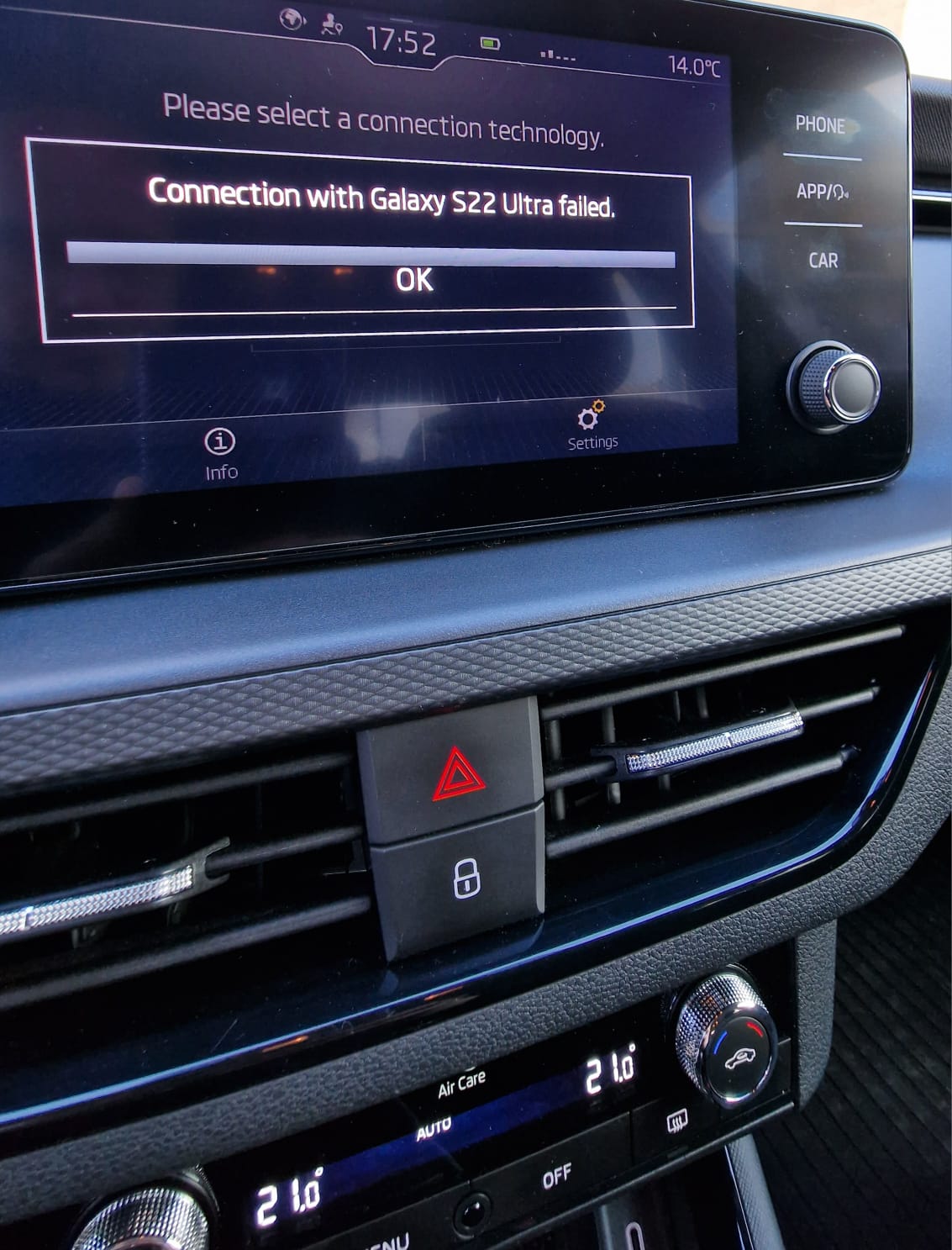

I have exactly the same problem with an S22 Ultra.
Android Auto works fine with a Samsung Galaxy S9 and an A52s

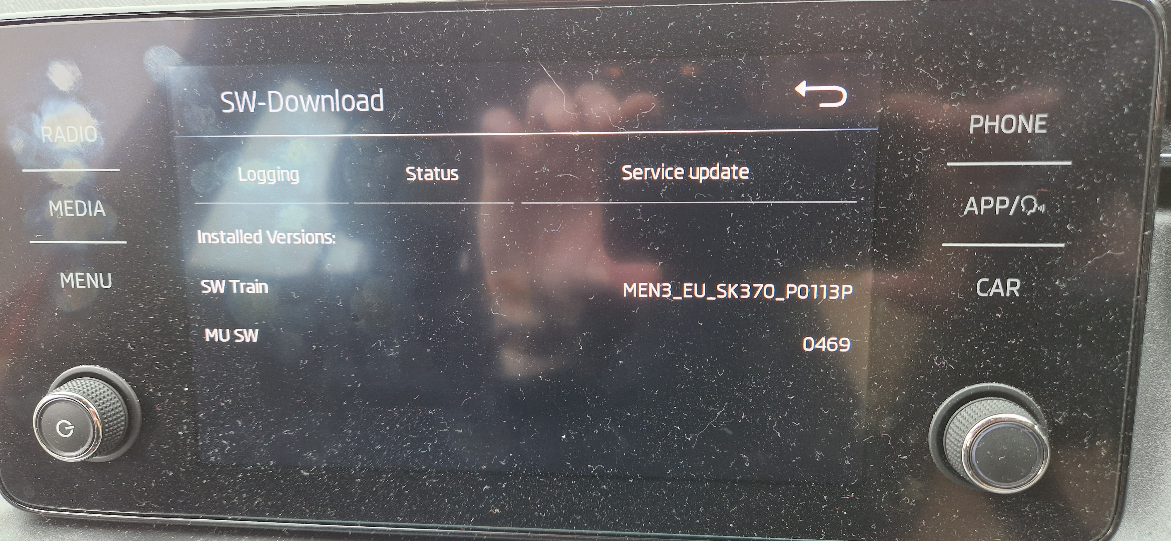

Hello. First post on this forum... I am a Scala owner who recently got a shiny new S22 and am thus having exactly the issues described here with Android Auto. I'm happy to have a crack at updating the infotainment system if a) there's a relevant update and b) someone can walk me through the steps required? I've hopefully attached a photo of the current firmware etc.
I can send you a possible update, it will either work or not as their updates are weird to say the least.

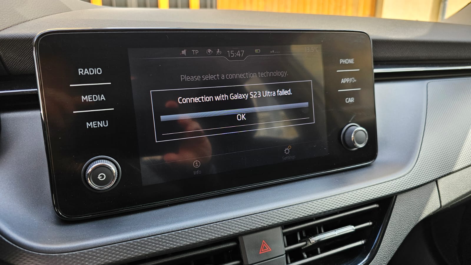

Changed phone yesterday, same issue on Samsung Galaxy S23 Ultra 😞
Not that i was expecting it working :).
New update AA, issue still the same AA on phone says car is connected, car says connection with  S23 Ultra failed. 😞

AA got updated today, still same message on S23 Ultra, phone says Android auto is connected, car says connection failed.
