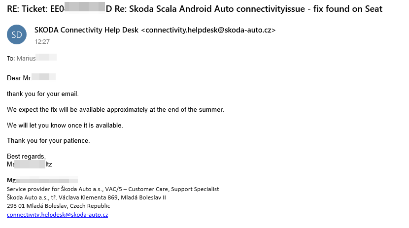

On 15/05/2023 at 11:24, MGV said:

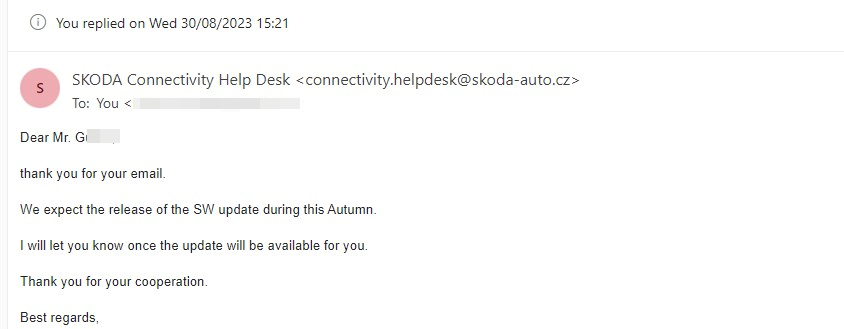

Answer from Skoda CZ
"We have confirmed that some Volkswagen, SKODA and SEAT vehicles are not connecting to some Android OS mobile phone models and Android Auto.
 We are working on updating the car kit's SW to resolve the issue. Once this is completed, we will share details on how affected users can update their SW.
 Actually, we are not able to tell when exactly the update will be available. We expect the release this year.
 Thank you for bearing with us while we work to resolve this issue."

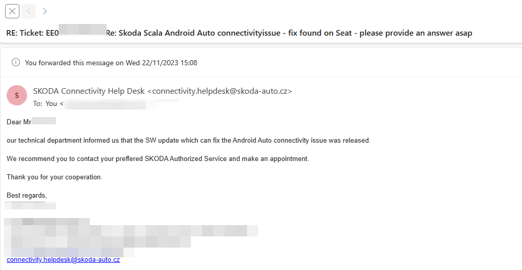

BIG NEWS
Should be fixed :
On 22/11/2023 at 15:12, MGV said:
BIG NEWS
Should be fixed :

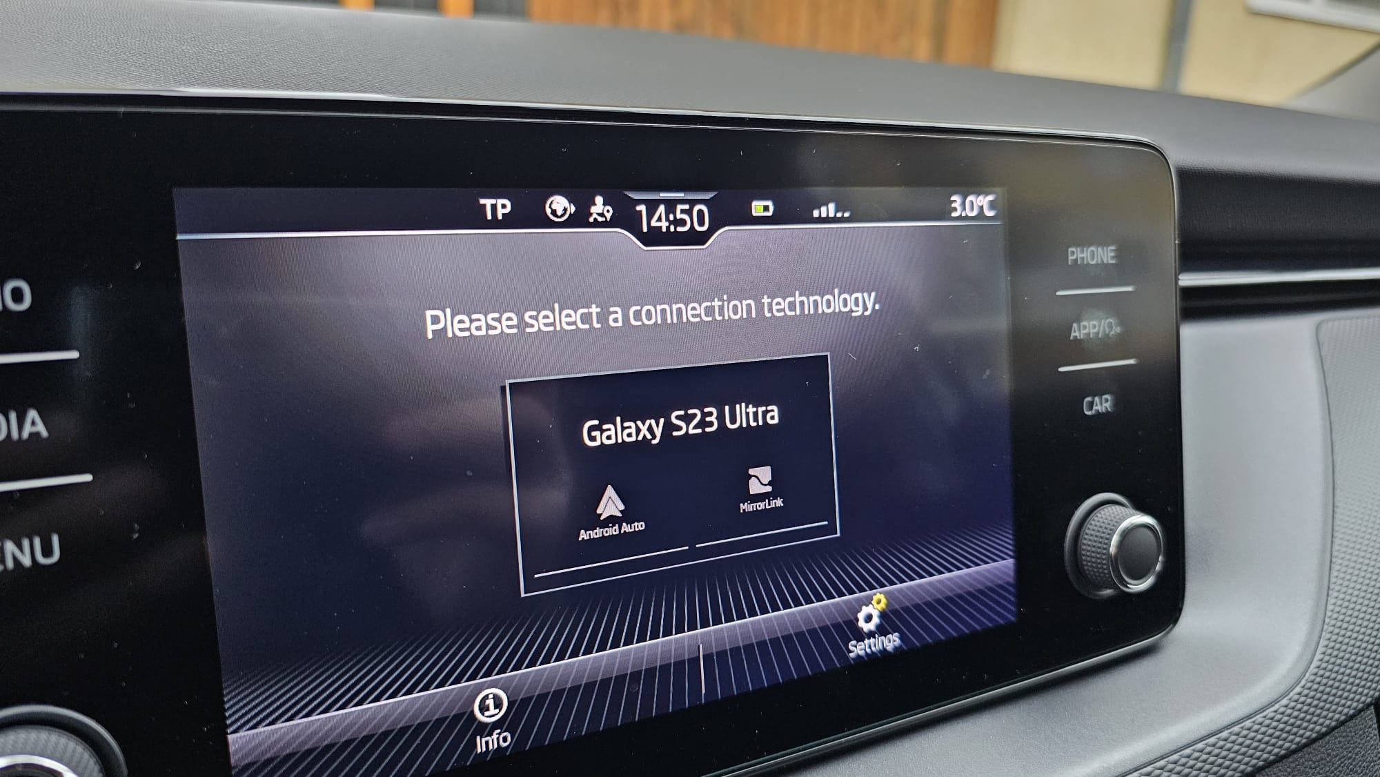

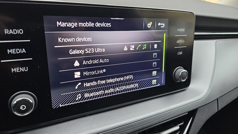

So do you have it working on Android ? First image if i click to connect wireless i get an error, second is from phone menu, with phone connected only via BT,

Fixed wireless as well, needed to pair phone again, I got a prompt to use Android Auto and it works flawlesly :).
