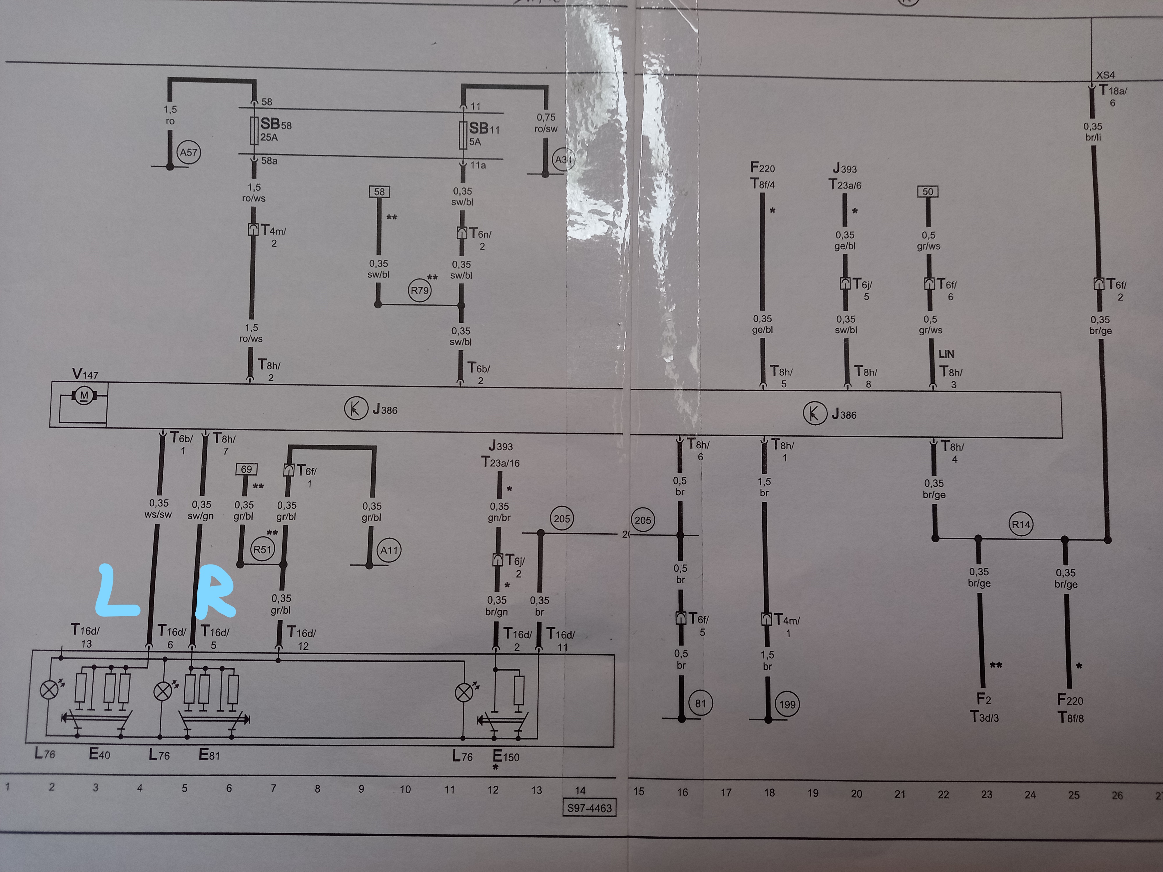

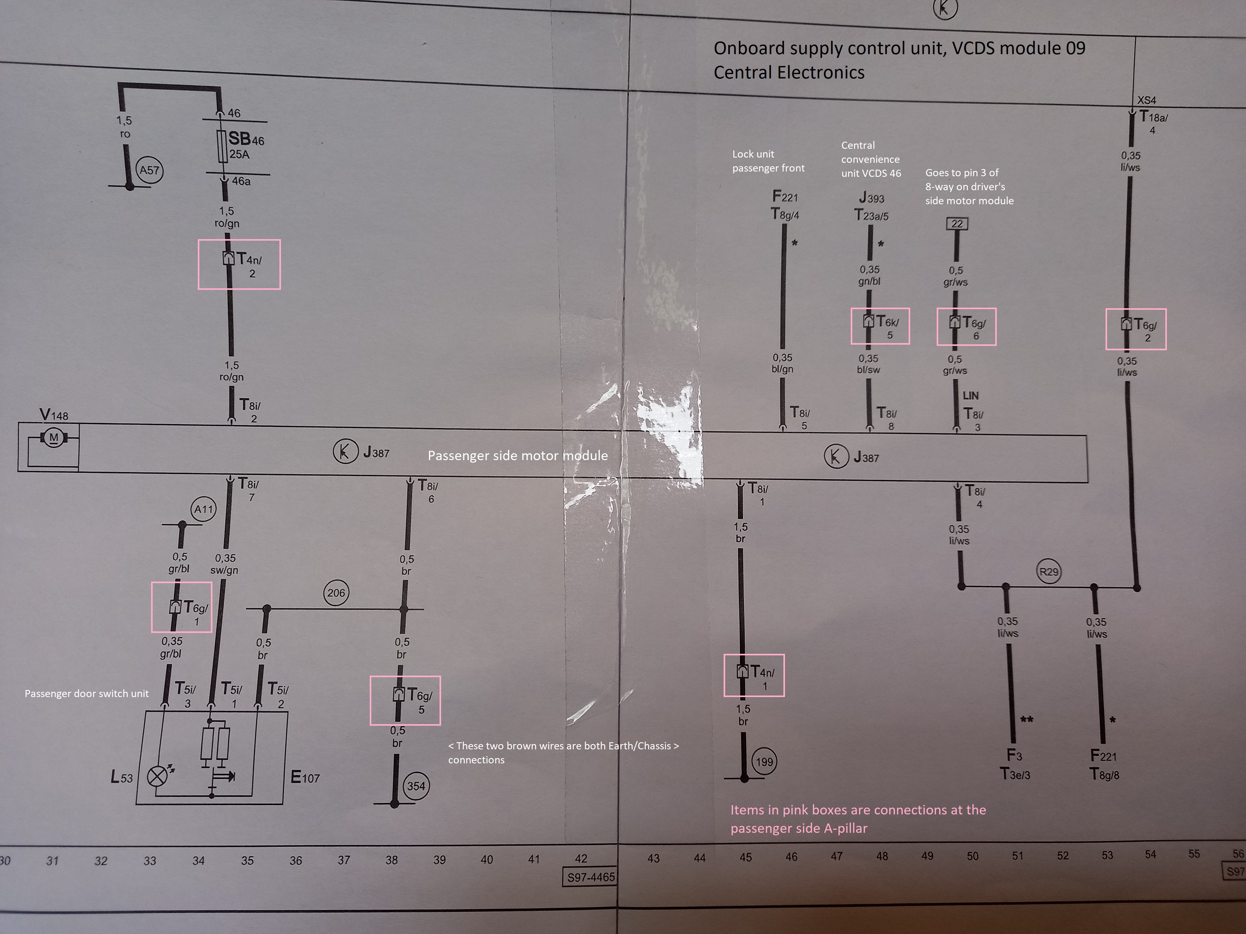

Pass side wiring, annotated
Driver's side, not as annotatedDSideWiring_2.thumb.jpg.816e80d72970a949552d2f1982d49cea.jpg:
The only connection between the two is the LIN data wire which goes from pin 3 of each 8 way to the other, and nowhere else.

Sadly that's a pre-facelift motor module you've acquired, and won't play nicely in your car.  You need 6Y2959801.
