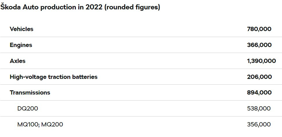

all new octavias come with new transmissions  DQ200 that apparently require no maintenance. Which I really doubt it. image.png.21021c3382b4a8bcc87d04d1e7af1949.png
@bolixYou are right to doubt it.
If they are no more than 250 Nm of torque and FWD they might well have a DQ200 /DQ200-e.
But no 2.0 TDI or TSI or PHEV has a DQ200, they will have DQ381,s or DQ400-e's.
Edited by toot
All E-TEC, or Mild-Hybrid, vehicles has DQ200 transmission box.
Because no more than 250 Nm & FWD, and not 2.0 TSI or TDI's or PHEV's.
