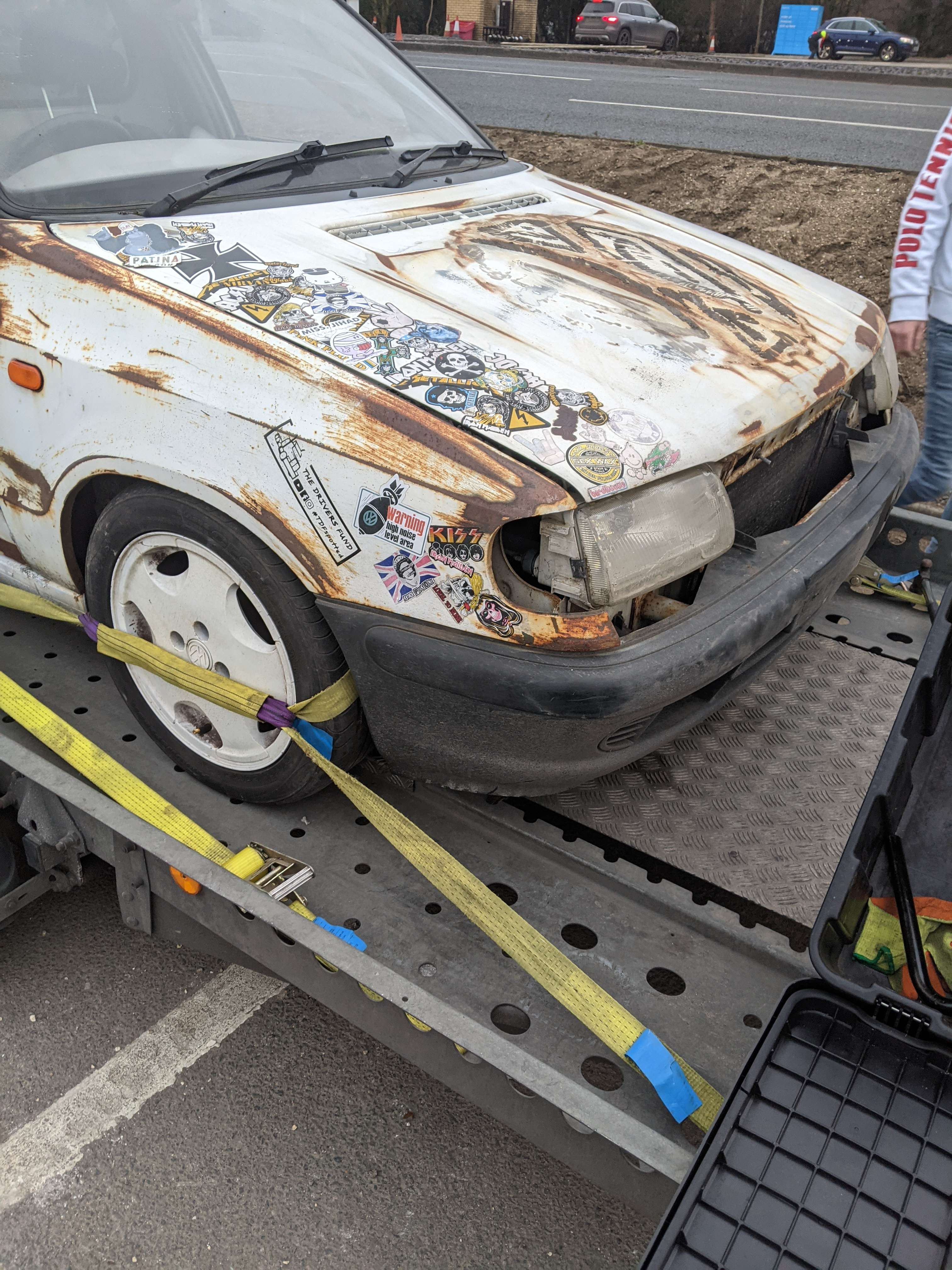

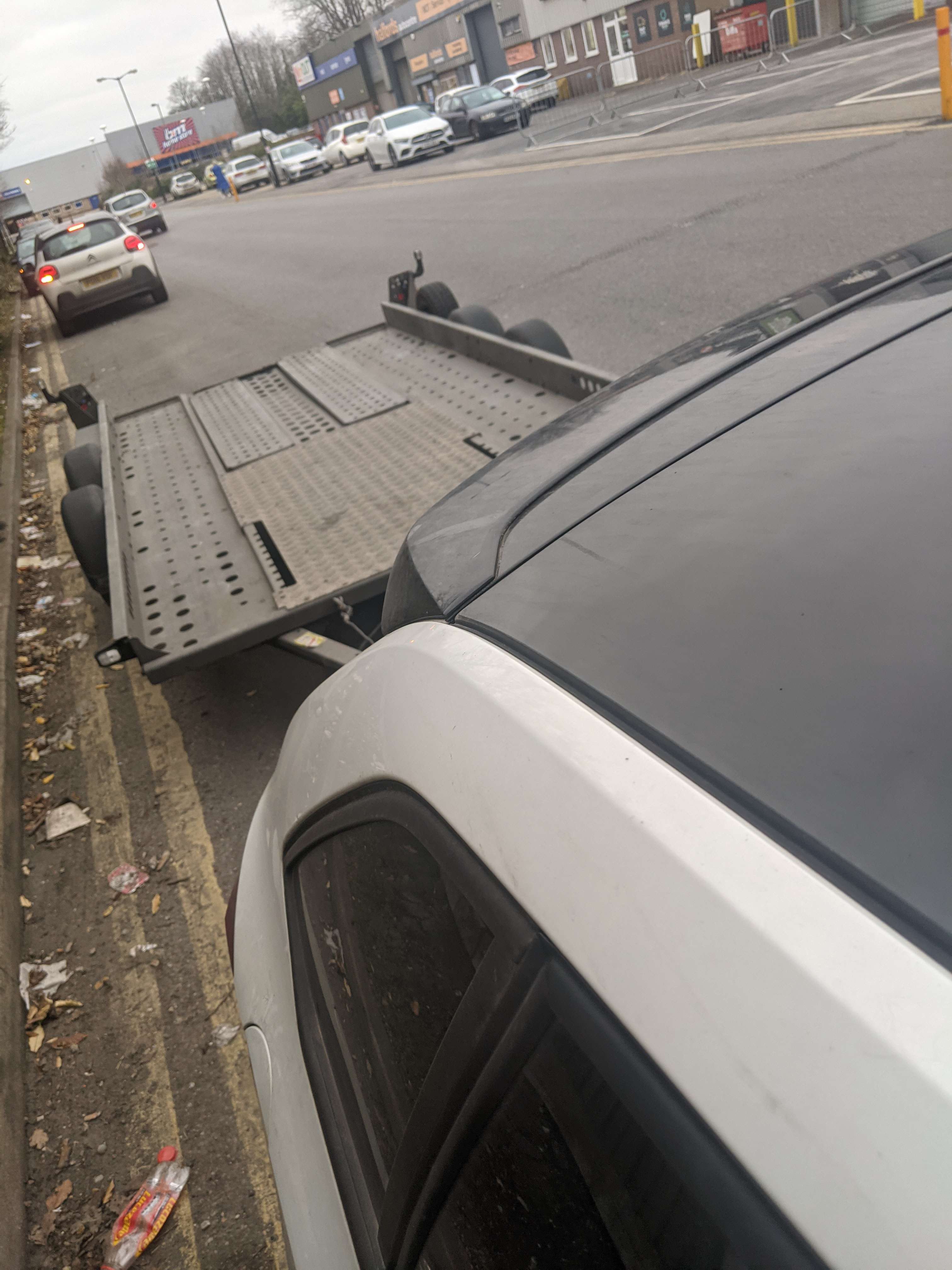

Decided to go a bit further and rented a car trailer 500kg & towed a Skoda Pickup 1000kg, car trailer alone was like driving the car power wise, once the car was on you could feel it, but it still wasn't as slow as say a mk1 Fabia 1.4 auto (cough).
Driving was  entirely fine, cruise control at 50/60 just keep it in manual mode since it'll upshift and kill your momentum, I kept it in 5th and used my retrofitted paddle shifters.
Hill starts were painful, there's a steep bridge near me where I had to hill start and I could smell clutch. Otherwise just acknowledge you'll take a bit longer to get started and position yourself accordingly.
Total economy around 8.5L/100m over 400 miles round trip, 200 towing full load.
All in all I'd do it again but plan my route properly, no detours, as few stops as possible, and pray they don't put roadworks on steep as hell bridges!
