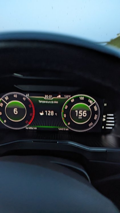

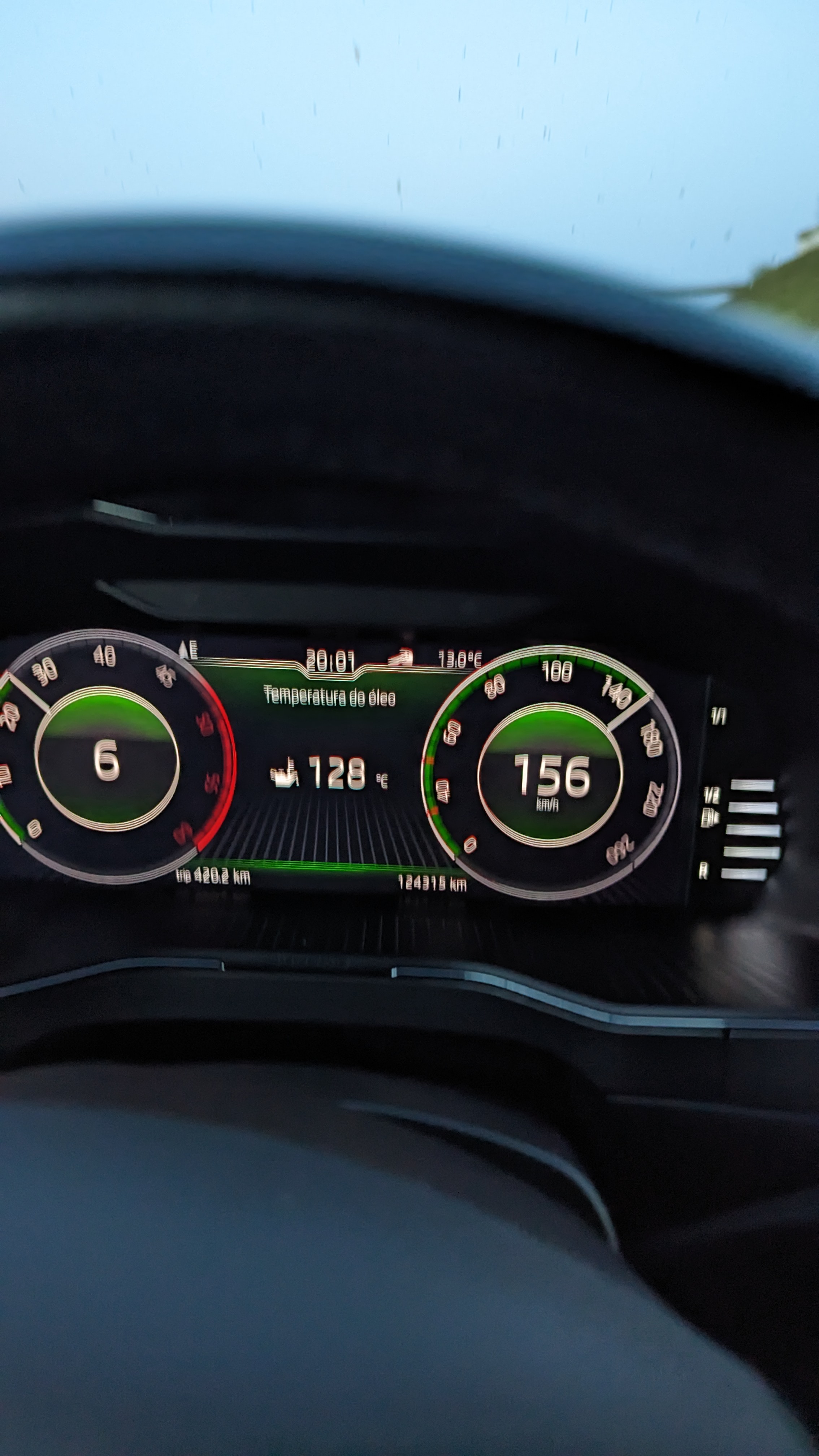

The temperature that the oil might be at when the ambient temp is in the high 20's degree celcius.
Plenty will have a 2.0 TDI's oil  at the likes of 110*oC even in cooler weather and sticking to 70 mph maybe.
