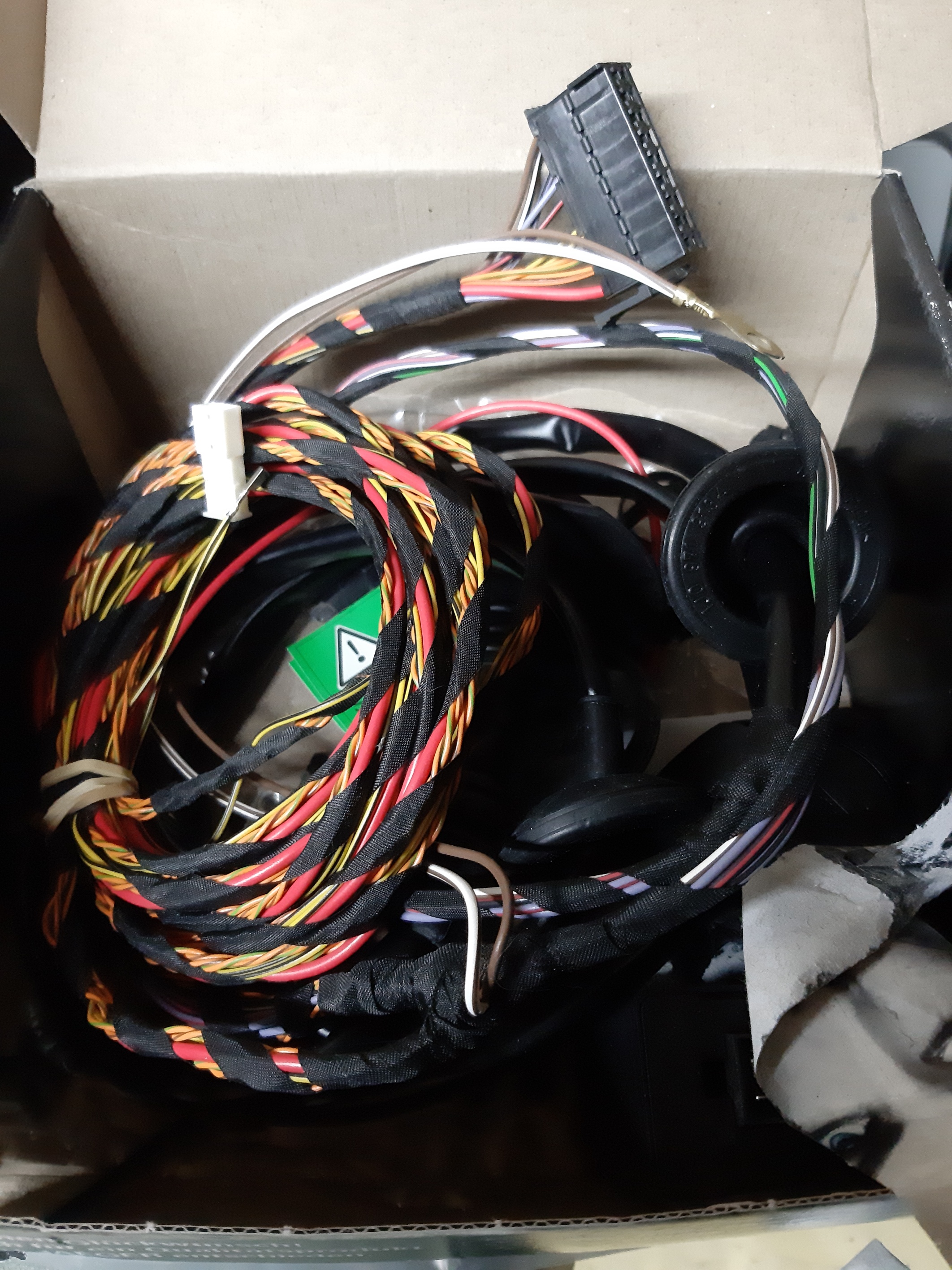

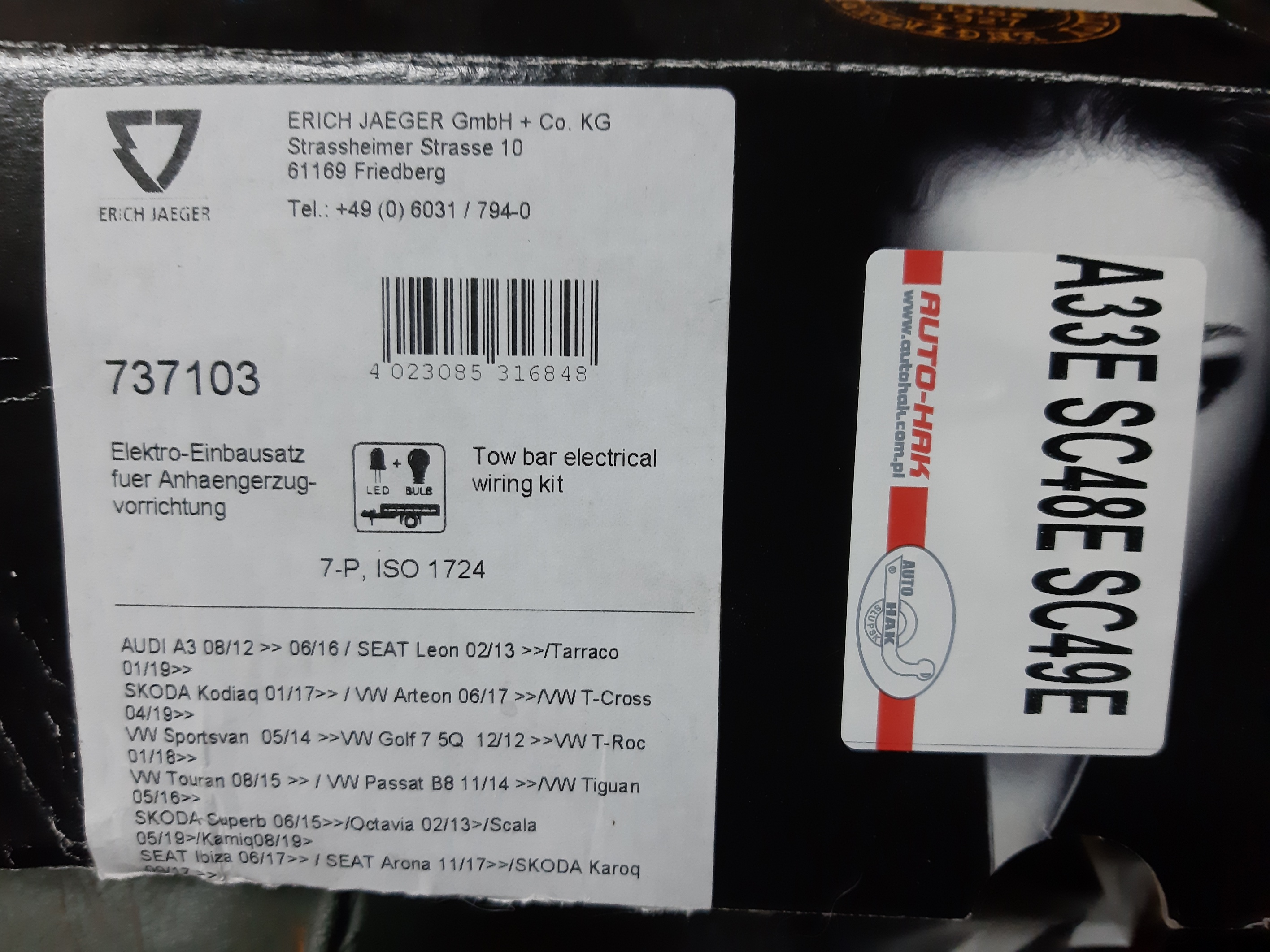

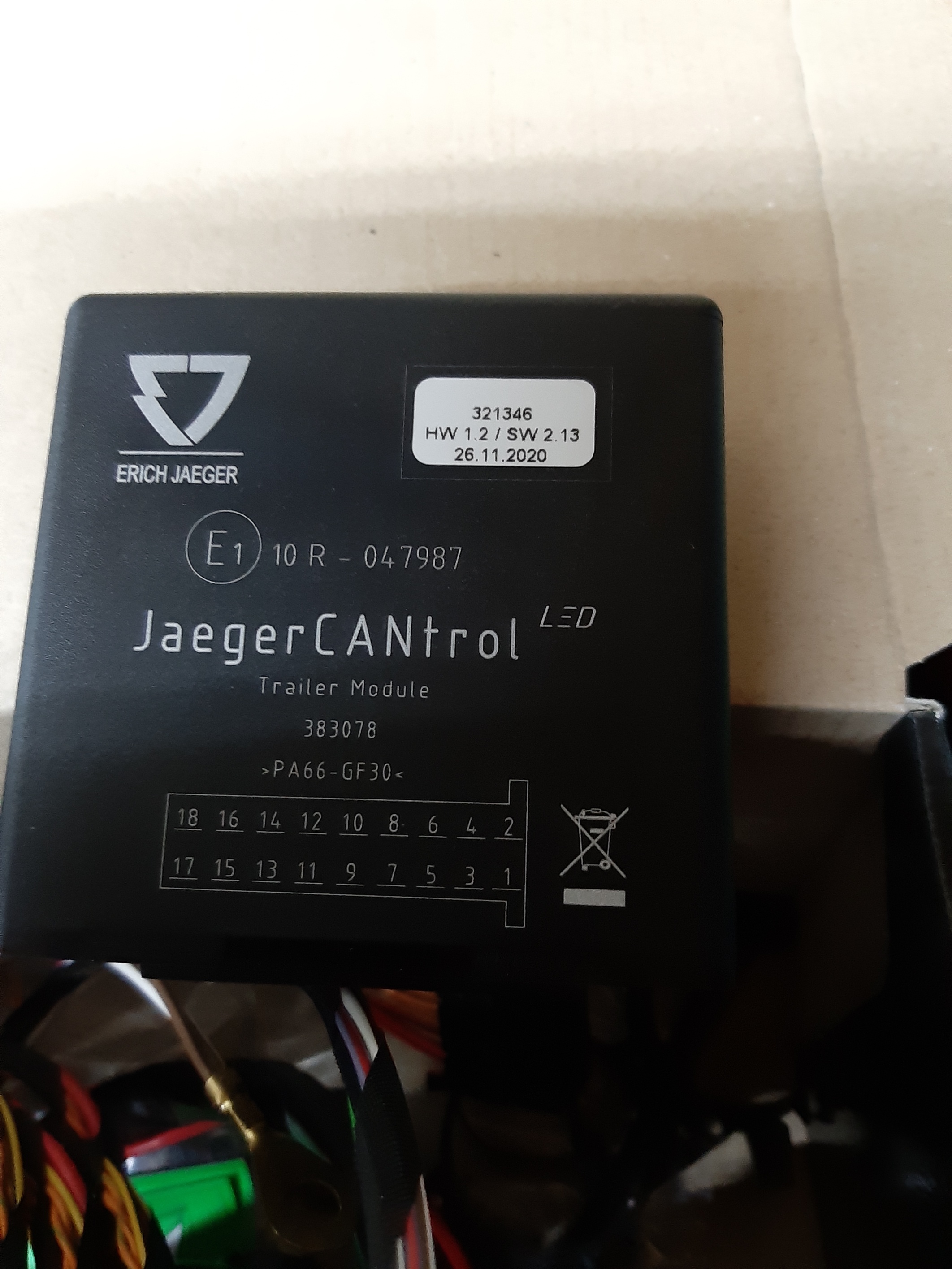

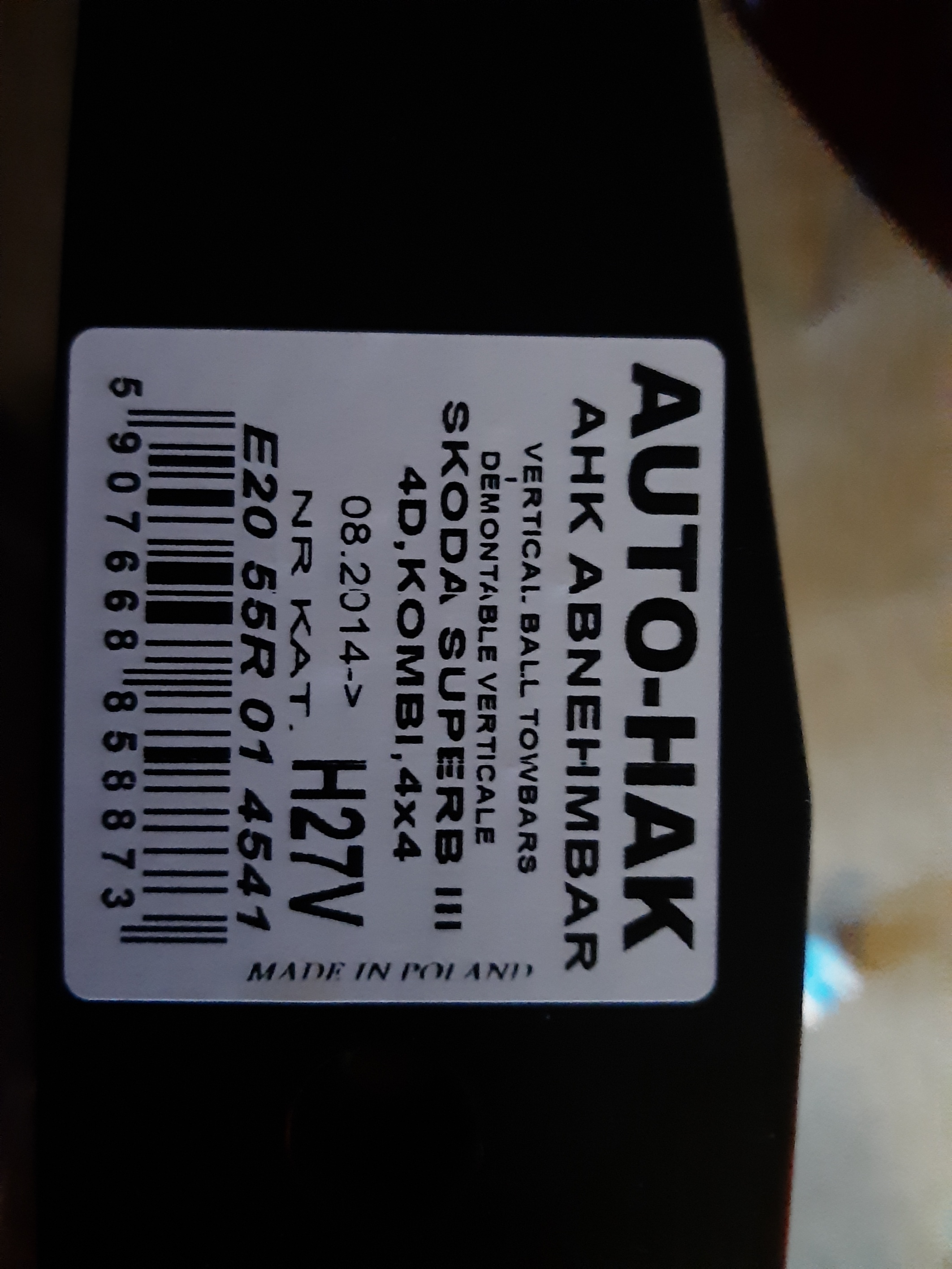

Please tell us exactly what tow bar has been fitted including details about what wiring kits have been fitted.
When you say he has the 'correct scanner' what do you mean by this? What diagnostic tool is he using - if any?
Do you have a copy of the fault codes at all?
What coding has already been carried out?
This is what I previously posted re the kit.
The garage owner told me he had the scanner and spent a lot on the regular updates requried. He comes highly recommended. I did not ask him what kit he had. He had a list of codes that were required to be changed but there was no code for Lane Assist or Cruise control on that list. I suggested I come to the forum to seek assistance as I know people have these problems. I just have the dash error lights.

In this thread, (https://www.briskoda.net/forums/topic/509380-towbarstrailer-lightsleds-and-cruise-control/) it's suggested that ACC is disabled if the car detects an electrical anomaly such as a blown bulb.  Might be worth trying a different trailer or something with a 13 pin connector if yours has the older 7 pin connector.
Maybe there's a potential issue if there are LED bulbs on your car and filament bulbs on the trailer's equivalent circuit or vice versa.
Good point! I will test with my trailer with LED's.
