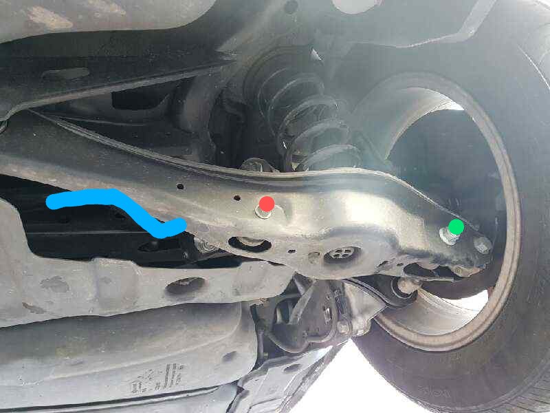

Yes (green dot). You may need to undo the roll bar links (red dot) depending on the clearance of the roll bar (blue line).
