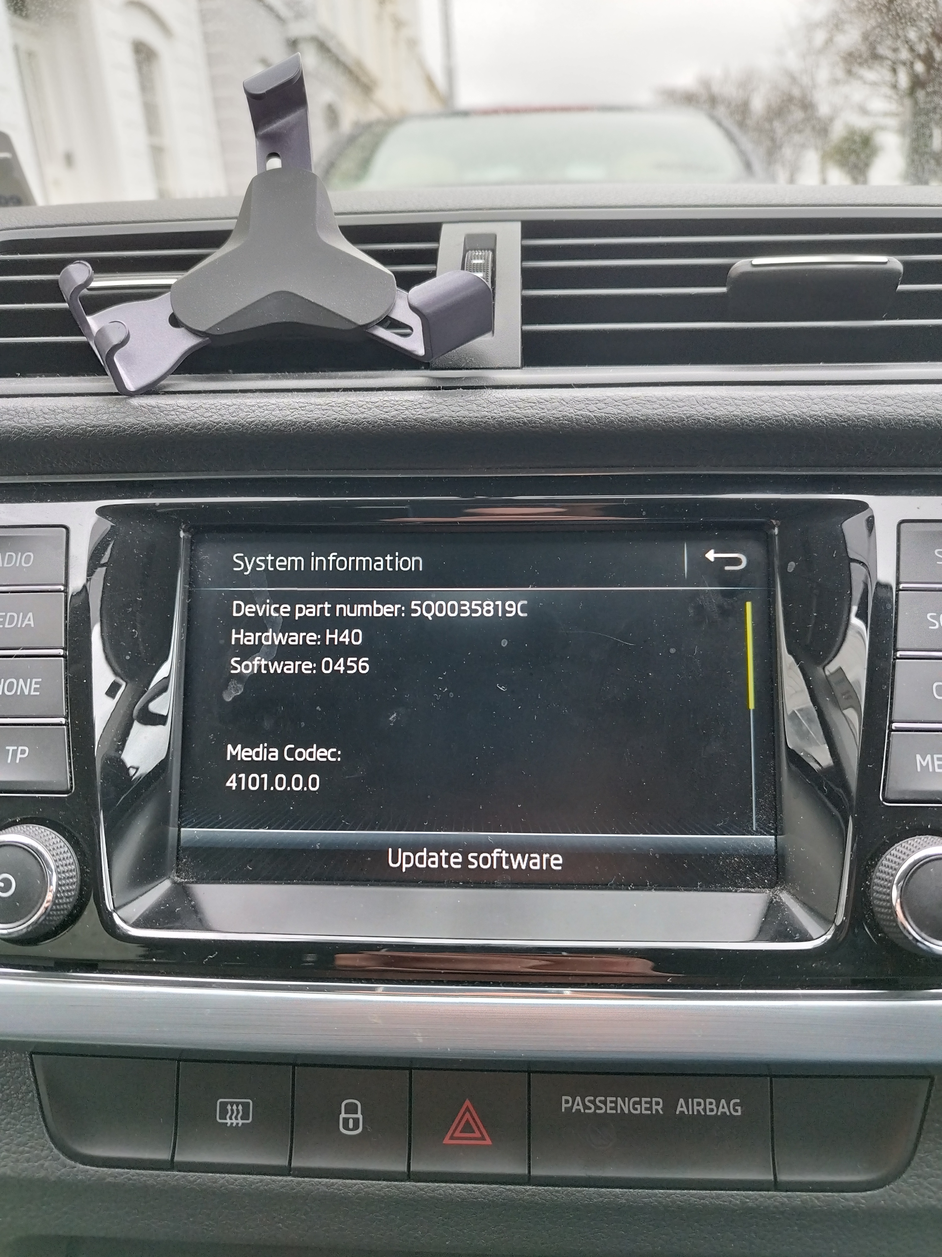

So the system is the Amundsen.
Device part number 5Q0035819C
Software 0456

Yes you can update to 0480 version, I will PM you a link

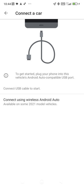

So I updated the firmware ok, but when I plug my phone in to try and get android auto working it still won't recognise my phone. All I get is this ...
Any ideas on how I might get this working, using the super fast cable that came with the phone

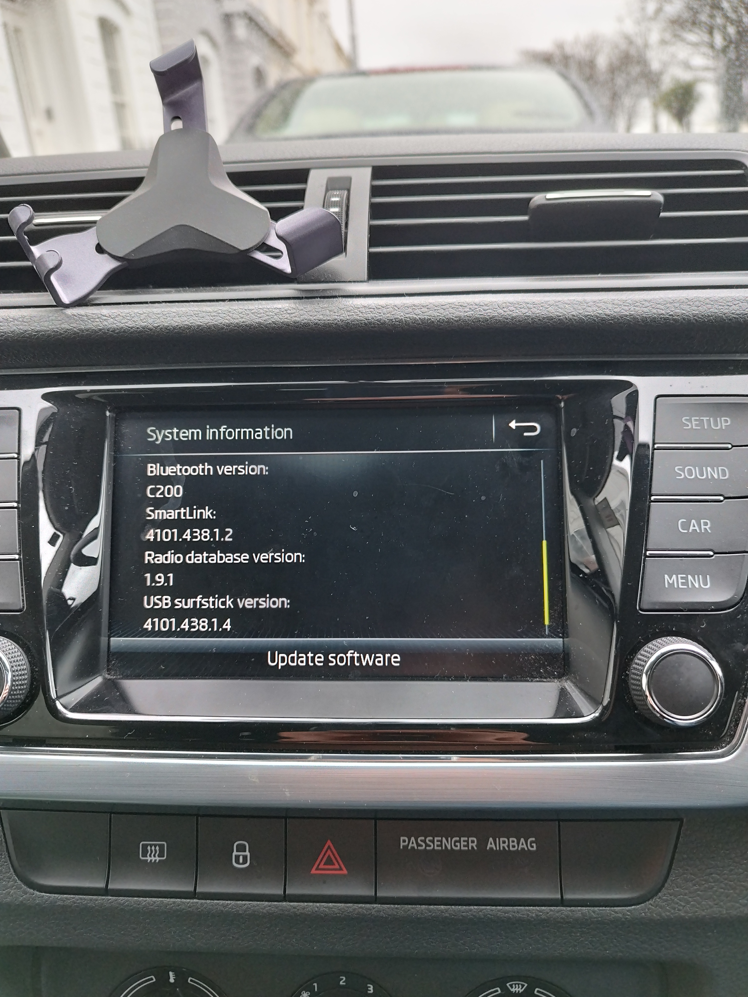

If you are talking about your infotainment system, then it's via USB or SD Card (depends on the system)
You would need to hold down the Menu or Setup button for 10 seconds to enter the engineering menu, and locate Software Train, then post image if this is the update you want.
