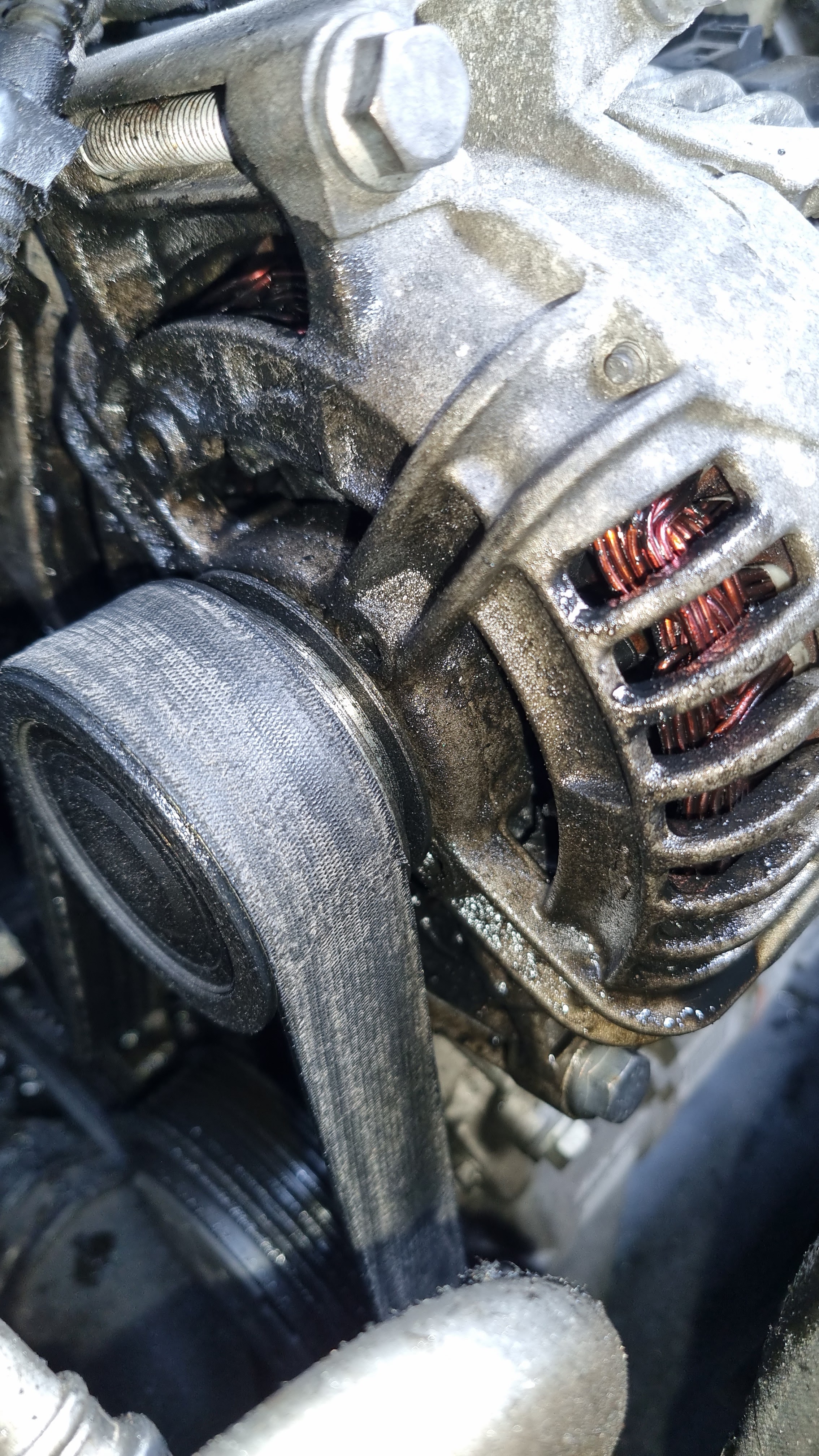

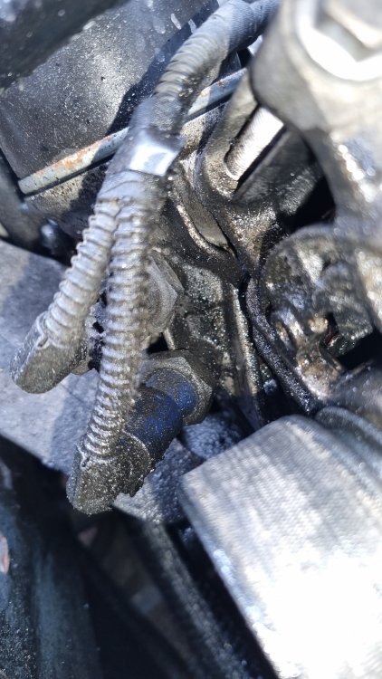

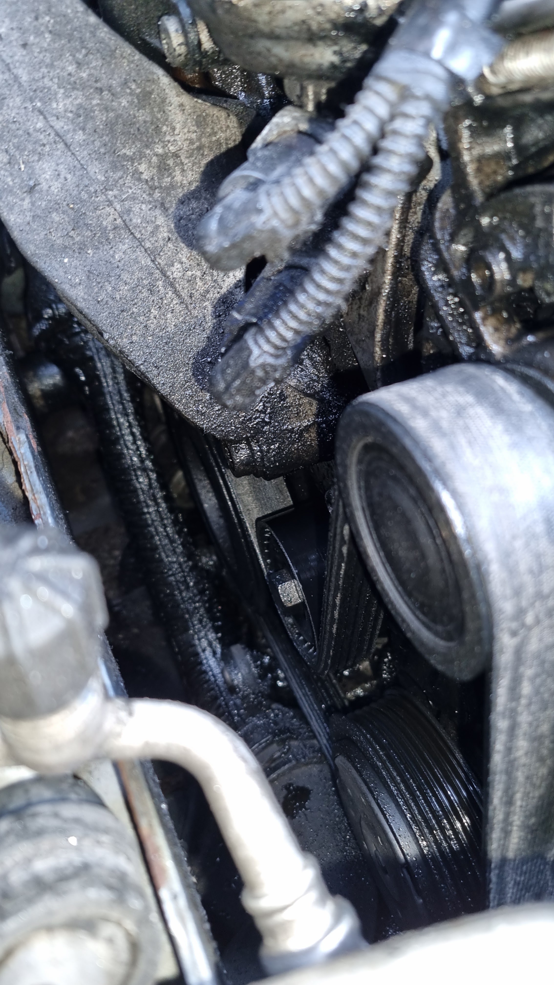

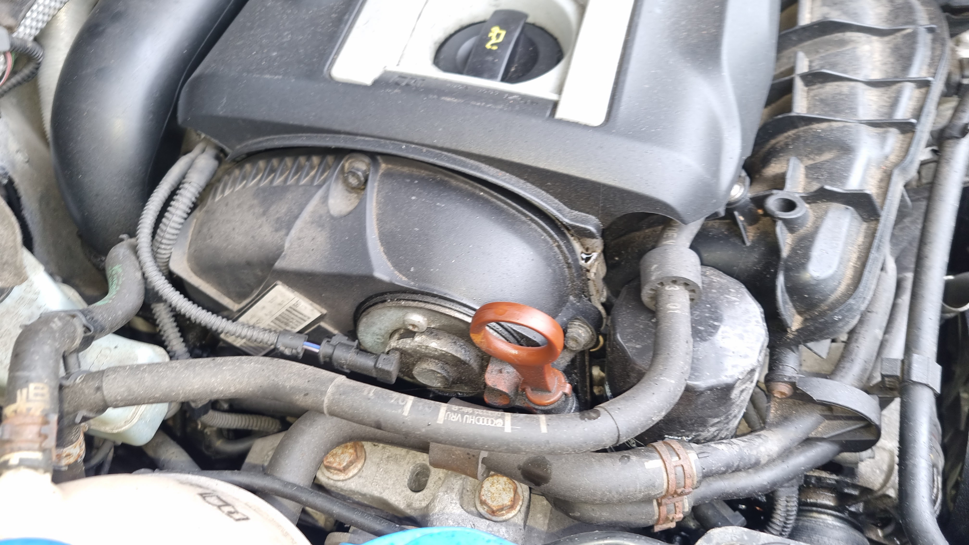

 Have a 2011 1.8tsi. I've had a slow oil leak for the last few months on the left had side (as you face the engine bay) of the engine. Its leaking around the belt and being flung all around the left hand side of the bay. I've had it into two separate garages who've either said it was the sump plug leaking or the filler cap needing replacing. So far none of these fixes have rectified the issue. Its not leaking a massive amount of oil, I'm concerned about the damage and further issues it may cause.
I've included some pictures hopefully to illustrate. Anyone any ideas as what is likely to be the culprit?

Looks like it could be the oil seal on the crank shaft behind the bottom pully, mine was leaking not as bad as that but with similar effects.

Bearing in mind mine is a different engine to yours, you should be able to get to it from the wheel arch, you may have to remove a splash panel to get to the pully, and the wheel, that's what I did.

I managed to sort the majority of my issue by replacing the crankshaft oil seal as described above. Followed a YouTube tutorial and replaced the seal. Took a good few hours due to getting the wrong seal initially.

Good work. Looking at the photos, I was going to suggest checking the oilfilter housing and bracket and oil cooler connected to it,  as they are in pretty close proximity to the alternator and drive belt and higher up (so oil can drop down). You know how oil splatters once it gets near a drive belt, it can be hard to locate source without cleaning up and monitoring. Anyhow,  may help the responder asking how you got on, I'd their problem is not the crank pulley seal.
