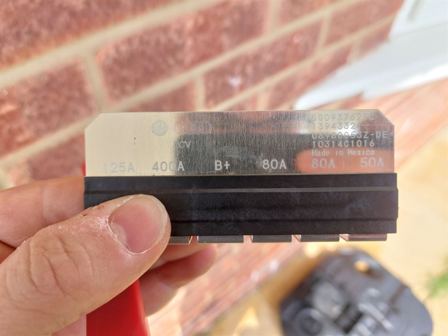

There are some high-current fuses at the front of the under-bonnet fusebox, with heavy cables bolted to them.
No. 2, the second one from the left as you look at them connects alternator output wire to battery positive.
Check that with engine off you can measure the same voltage on the wire going to that fuse, as there is at battery positive.
It's a huge (400Amp) rated fuse, but if that had cracked or something, it would mean the alternator could not get any charge to the battery.

Located the main busbar style fuse/relay that you referred to Pete. With the engine off this was also giving 11.5v as per the battery level. Ended up taking it out and checked it with the multi-meter, putting one lead on the main metal bar and then the other on each of the terminals of the fuse (125A/400A/B+/80A/80A/50A) and each one showed good continuity, so im afraid its not that (which is a shame as it looks a fairly straight forward and cheap thing to swap).

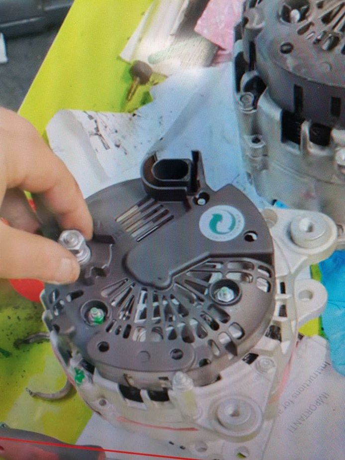

Just for future reference for anyone wanting to know where the main fuse bar is, I've attached a couple of images. Its a combination of 10mm and 8mm sockets required to undo the captive nuts (one is a bolt) and its a good idea to note which cable leads to which terminal as though they are labelled, some of them are duplicated (there are two "K" cables, one red and one black).

Can you see enough of the back end of the alternator to be sure they reconnected the other end of that cable to it?
Properly dangerous if it's just floating about loose down there!
Edited by Breezy_Pete
Hello Pete,
From what I can see online and elsewhere there looks to be only one connection to the alternator (the attached image isn't from mine, its from a youtube video) which is to the right side of the alternator as you look on the engine bay, within the plastic section (im guessing that's the voltage regulator). Fortunately I can confirm that's connected.
  • Sponsor
Yep, that's good, assumingyou mean where his fingers are?
 The plastic two-way connector also needs to be connected, but I think you said above that this is also true.
The plastic two way connector is definitely plugged in.
Purely coincidental that I happened to take a screen grab just as his hand was on the threaded connector without realising the significance of what it was....
From the top of the engine bay i cant make out at all whether that is or isn't connected up - might have to get underneath it tomorrow and have a look.
Cheers for the help Pete
Edited by BigJakk
