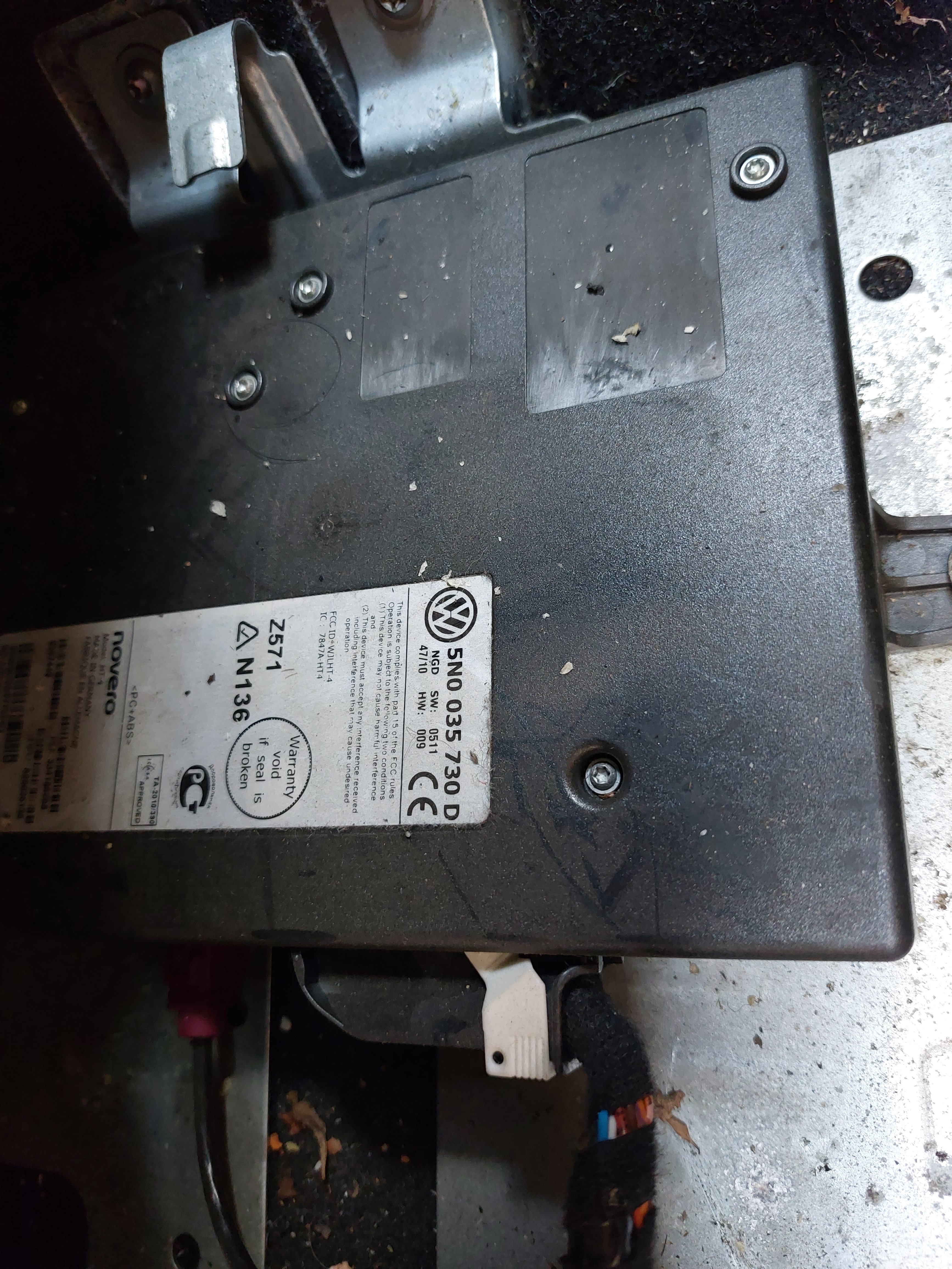

Not in this one - must be replaced, e.g. to 3C8035730D or 3C8035730E
Replacement bt module  ?

no. that is an earlier one, the letter at the end is a revision number and you need D or E or later

Hi thanks for the reply.
Will the updated version you mention allow Bluetooth streaming and will it stop the car taking over the phone  ?

I dont know what you mean by that, i stream music from my s20 over bluetooth and still have full control of my phone, perhaps you have allowed the wrong type of connection, i use hands free protocol (hfc) not sim direct (premium) on a C revision bluetooth module.

I've ordered a new upgraded one from eBay so hopefully it'll work now. Cheers
