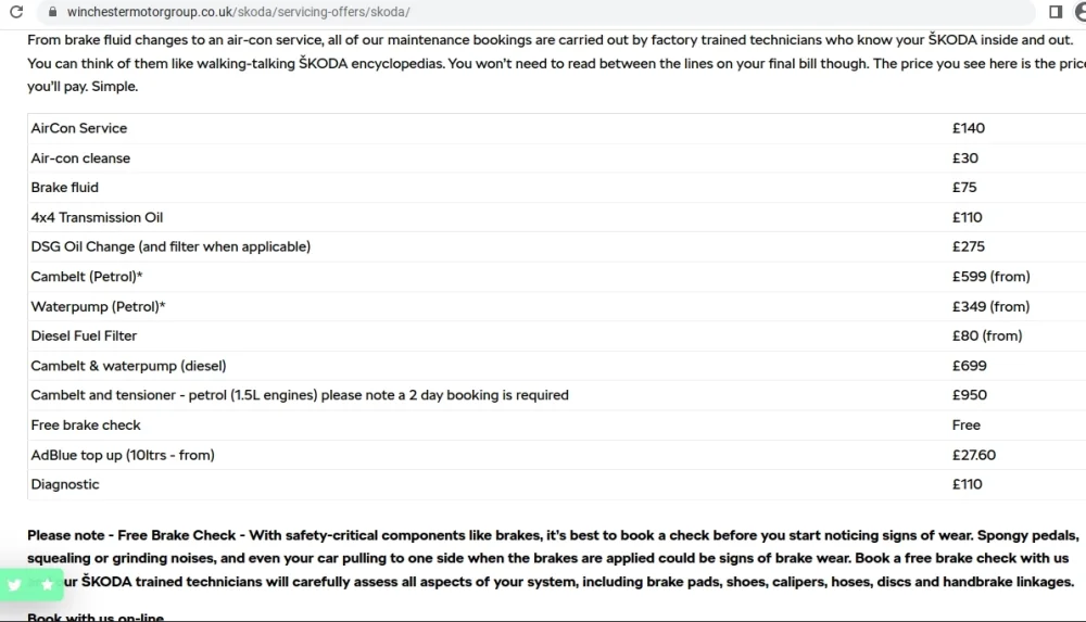

That member of staff might well have quoted the Skoda Fixed Price Service and maintenance cost for Spark Plugs at a Service on 4 or 3 cylinder cars.  A rip off.
Actually the 'Citigo'  is not the same fixed price if they had actually checked properly.  But then they never.  Still a rip off though.
UK VAT @ 20%.
If you supply only 3 spark plugs and fit and charge the same as supplying and fitting 4 spark plugs and charge VAT then HMRC are being cheated and so is the customer being robbed.
This fraud has been going on for ever with VW Group and others.   Same with Oil and filter changes with a fixed price on under 2.0 litre engines.
Some need 2.8 /3.2 litres oil and some maybe 4.8 litres.
Small engine capacity car owners being robbed.  HMRC / Treasury cheated, so Tax payers.
in 2023 the prices of 2021 or 2022 have risen, and the bottom prices are becoming common.
