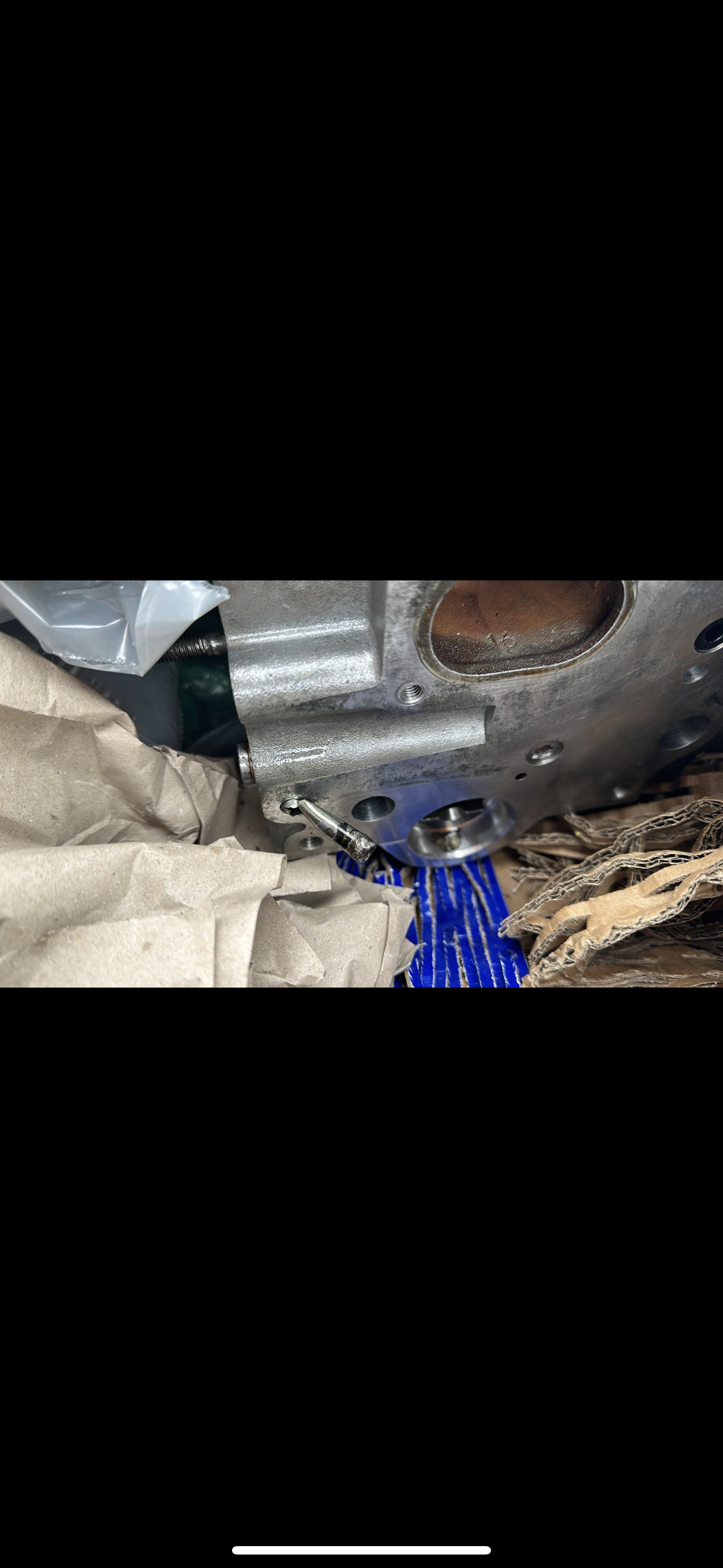

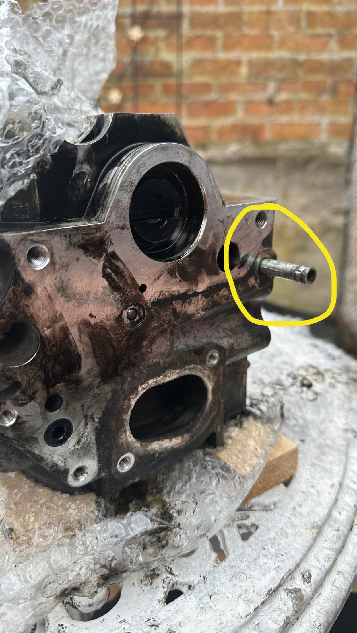

Hi, can someone please tell me what you would call this part, i need to order a new one. Its for a coolant line to be clamped onto.

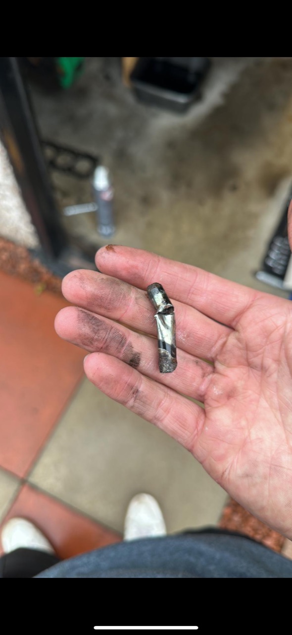

Are you sure? I bought a head online and it was damaged during shipping. I managed to pull it out.1997D47A-6A7A-42D0-A874-0F1CC469FE8B.thumb.png.cf565e4626b0ca4cf7e101dec65702fe.png5F3A8B90-7B14-45CD-B43C-E2185C59FB27.thumb.jpeg.012d9a4525c4f86e917592a9258907cc.jpeg
I daresay you'll be able to find a hose barb that'll fit since it's almost certainly a standard metric size and a hose barb is a generic part.

 @Thompa021 I think it's 044103499B
£5.51 + VAT from your friendly local Skoda parts counter. Likely to need ordering in!
Compare google image results for this number and what you have removed.

That looks promising! Thanks very much
