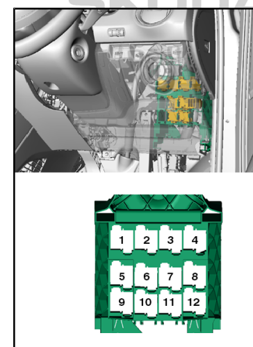

I think the Citigo compressor may have a clutch, judging by ebay pics of what I think your compressor part number probably is (1S0820803B). That is pretty unusual for modern Skodas though, most have instead a solenoid valve that varies the displacement of the pump from some minimal figure of say 4% up to max.
Not sure how to go about fault-finding, but the relay associated with the compressor is in position 10 of the relay holder in front of your right knee when sitting in RHD driver's seat.

Great, thanks for the info. I'll take another look when mother pops over for a cuppa - it's her car and I thought I'd take a quick look at the A/C whilst I was changing the oil and filters etc. Couldn't see any relays nearby when I was checking the fuse though.
