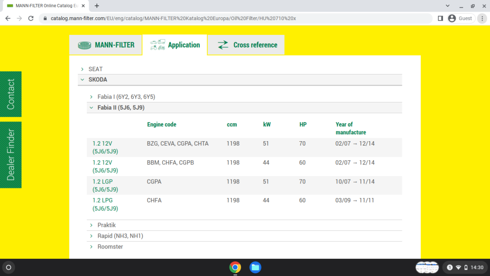

I removed the old seal....here is the box for the filter...
Is that correct?
Thanks Toot.....Im trying to decipher what I'm looking at😂
I think its showing that I have the correct filter??
You are looking at the Filter info for what you showed with the Code on the Box.  So all well there.
