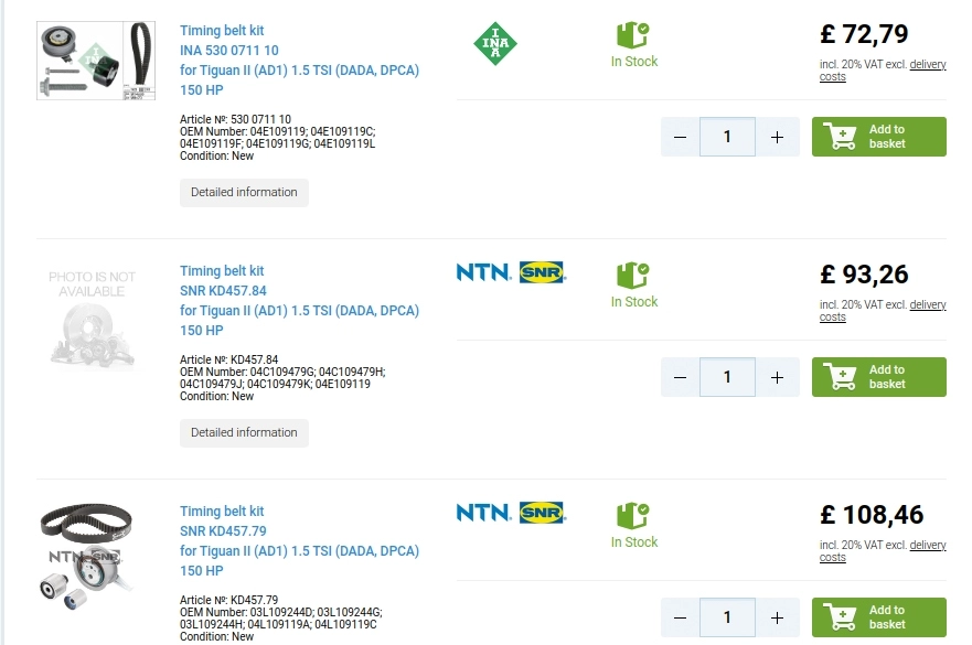

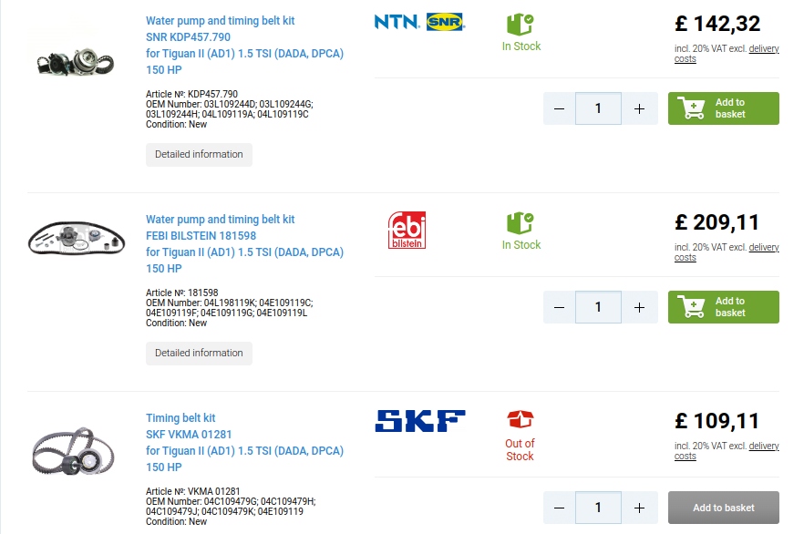

You have a very expensive Cam Belt change next year if you have that done at 5 years old.
I would find a good VW Specialist Independent and not get ripped off with Main Dealer Servicing @ Maintenance.
1179912860_922218293_Screenshot2022-09-2115_58_57.jpg.3711dc86397a804fc83f268add4ae736(1).jpg.606196879c2532f67305f1ec411800c6.jpg
22190367_575794279_Screenshot2023-03-1822_35_35.jpg.f1eafd544592c6770c8a17f54f93155c(1).jpg.0b06f1d5d5d159b07d3d237fd672b0c1.jpg.c2a4c8259a371d28308c221400827bd2 (2).jpg
