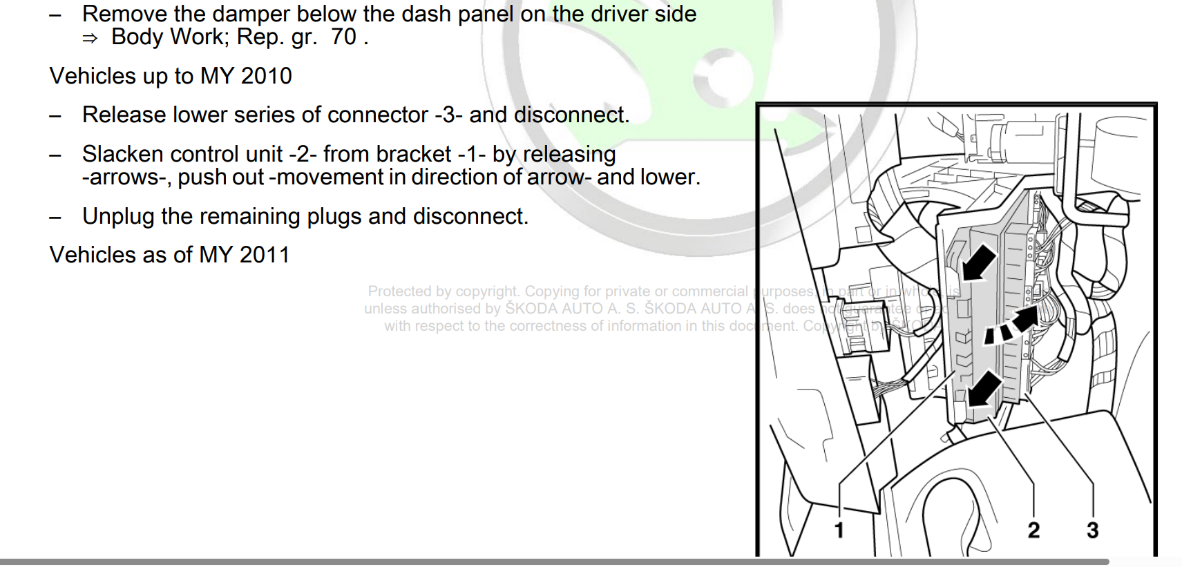

Duff info, sorry, looks like it mounts like this (bearing in mind this is a Left Hand Drive depiction, so mirror everything).
You can probably refit it without unplugging any connectors, so ignore stuff about that.

Seems like I didn’t clip it in properly as the mechanic recently noticed it was still loose.
https://imgur.com/a/DU5xYxT
from this video (see link), is the control module the correct orientation? If so I will try again to clip it in to place.
  • 3 months later...
I thought I would use my bank holiday to have another go at fixing my control module issue. The module seems to be in the correct position but it wont clip in.
See video here.. https://youtu.be/IE5NAaIqxoE?feature=shared
Has anyone got a Roomster or a mk2 Fabia and can share a photo or video to show how this module is oriented and the positioning of the cabling?
