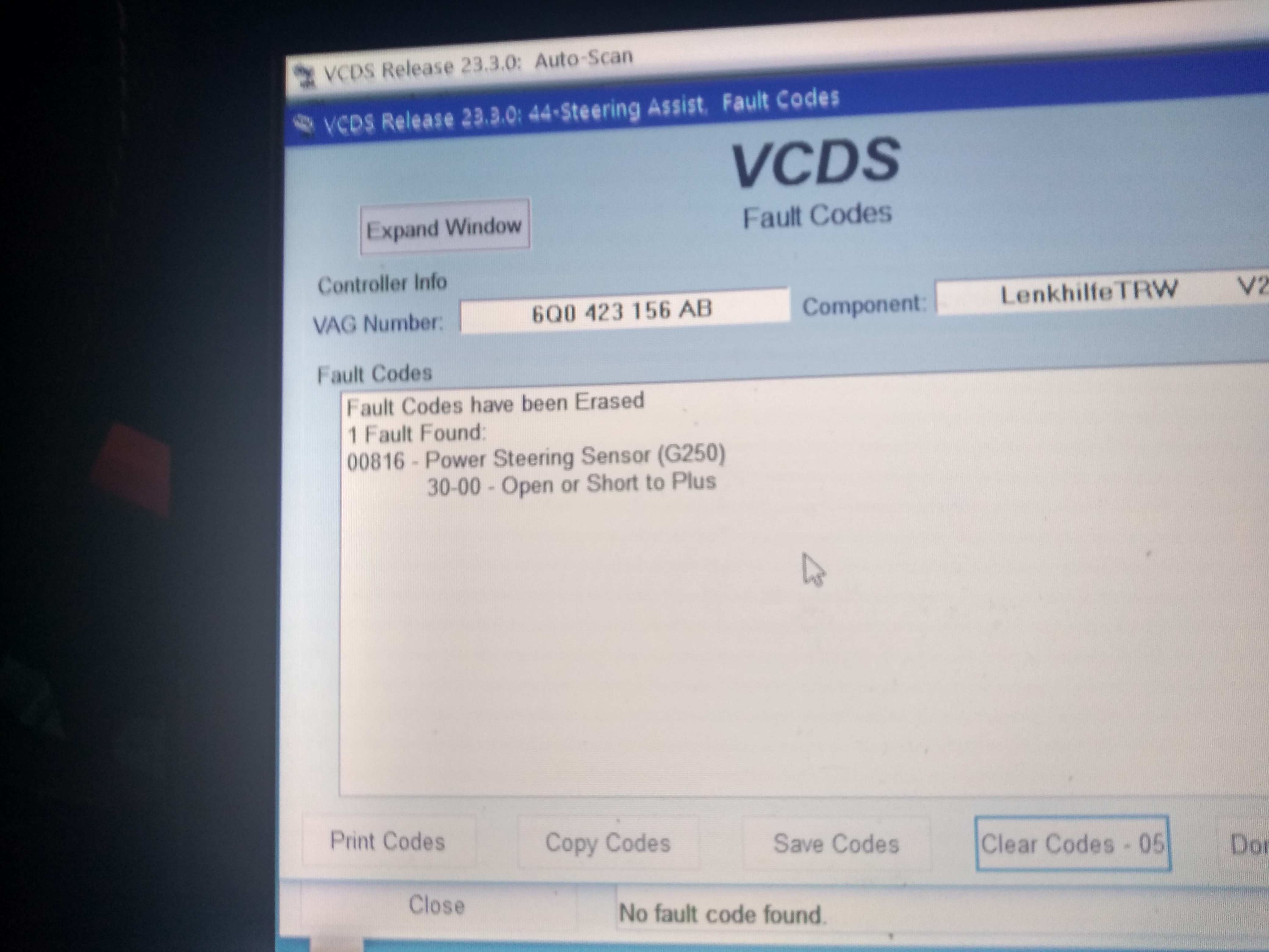

No connection between scanner and pump ,steering pump would come on then go off intermittently so checked wiring could see no fault changed battery was still the same .So changed pump and have connections to pump but fault showing IMG_20230515_150102248_HDR.thumb.jpg.d483f4d6a6a44b198b2d6a6e019423ae.jpg
This is what the scanner shows when engine running.
Do I need to recode the new pump as I have no reading off the old one as my VCDS could not connect with it .

The only coding for the pumps is the 'steering weight' which is adjustable within a small range. Nothing that would make it not work, nor generate a fault code relating to the angle sensor.
The simplest explanation of what you're seeing is that there is a fault with the turn rate sensor (G250) or the wiring to it, or connections at either end thereof.

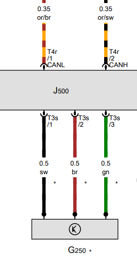

Hmm, having looked at wiring diagrams, I'm now wondering if your car even has an angle/turn rate G250 sensor on the rack. Can you have a look please? It'll be on the driver's side on the bit that goes up towards the steering column. Or is there a cable connected to the 3-way connector on the pump?

The asterix * is defined as "According to equipment".
This might mean that your car has instead a G85 sensor on the steering column, nearer the steering wheel.

Hi an update on my vehicle saw a video on yt of guy with same problems.The solution was code 11250 . Seems the three connection pump looks for sensor g250 on cars which only use two of the connections and have g85  hope this help someone in the future and thanks for all your assistance 👍
