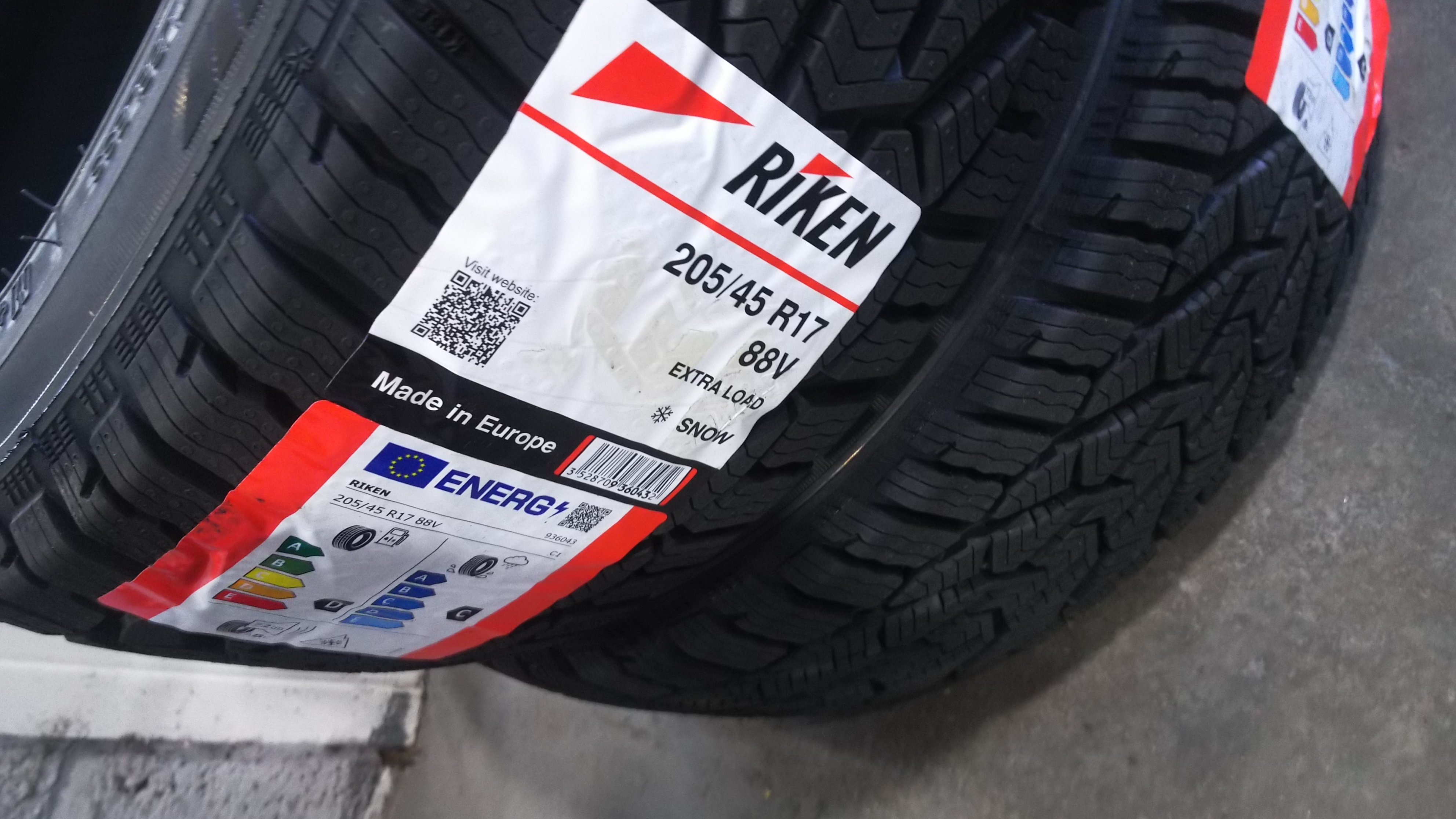

Have I bought XL tyres?
@jemjemyou have the tyres, do they have XL on the sidewall?
No big deal if you have.  I run them on my Corsa Electric which came on 205/45 R 17's.

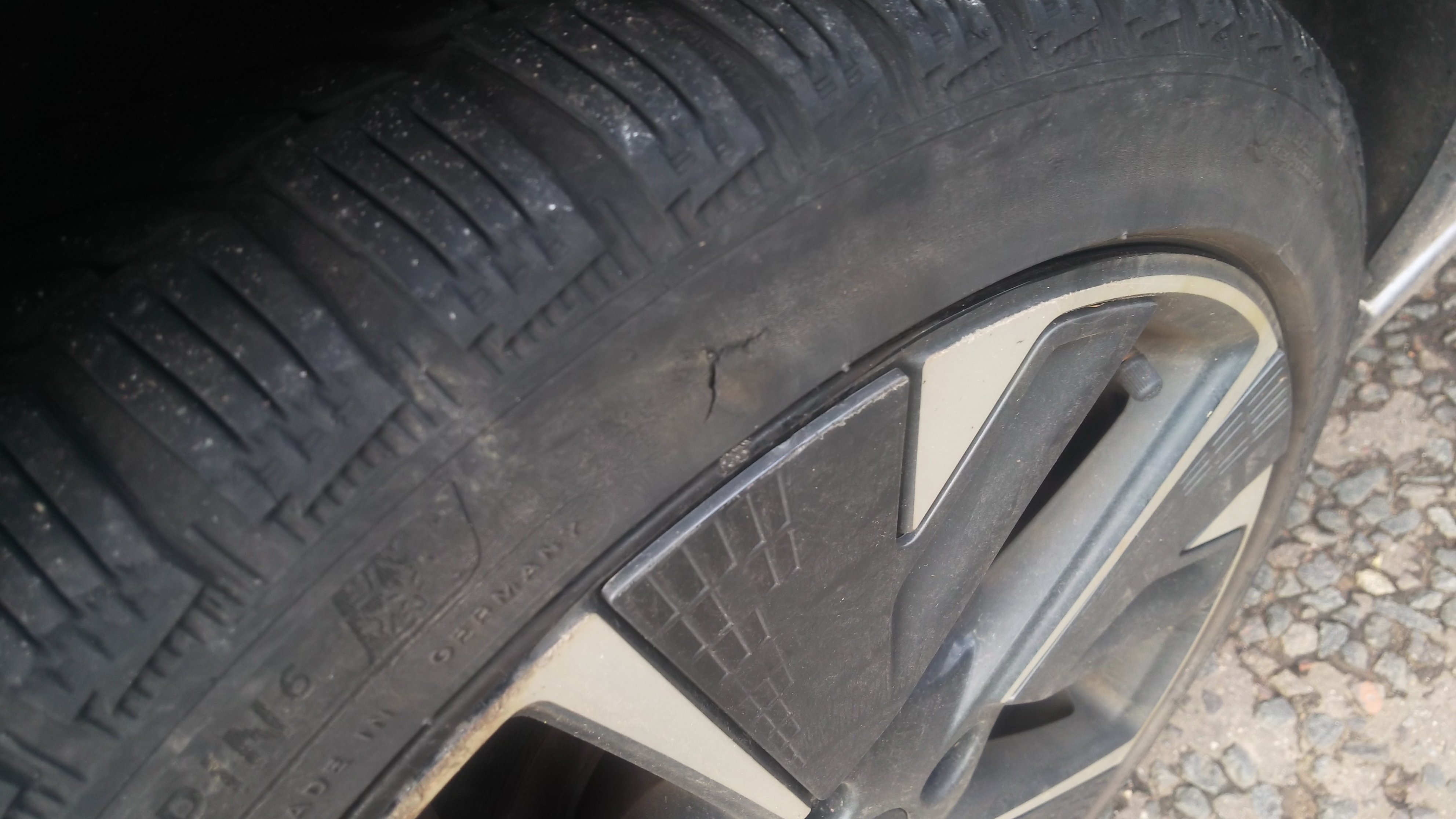

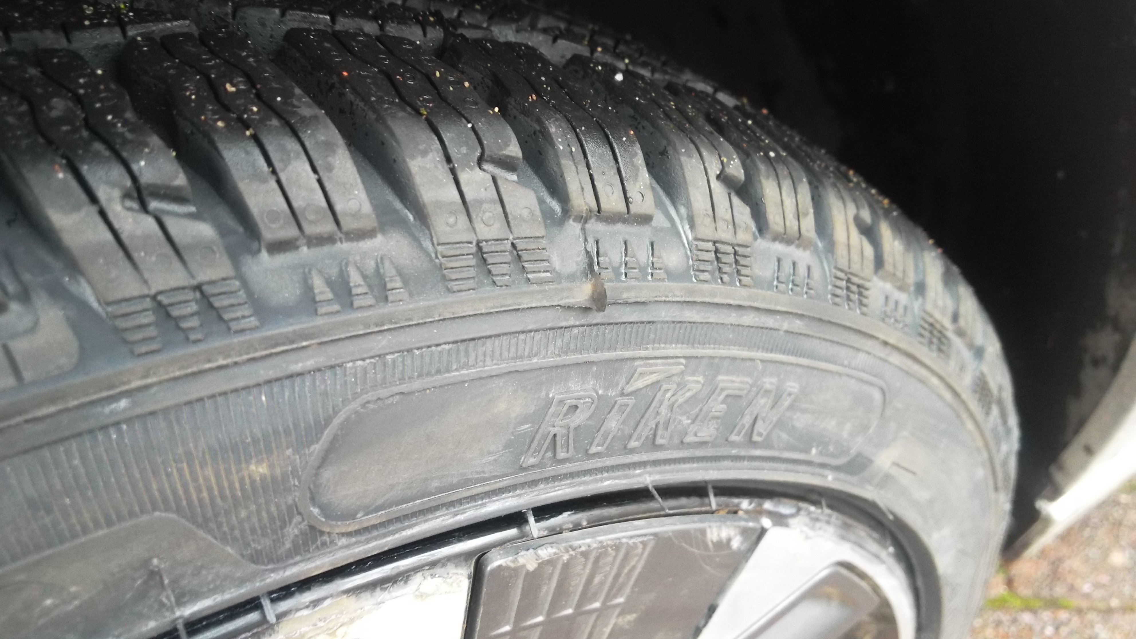

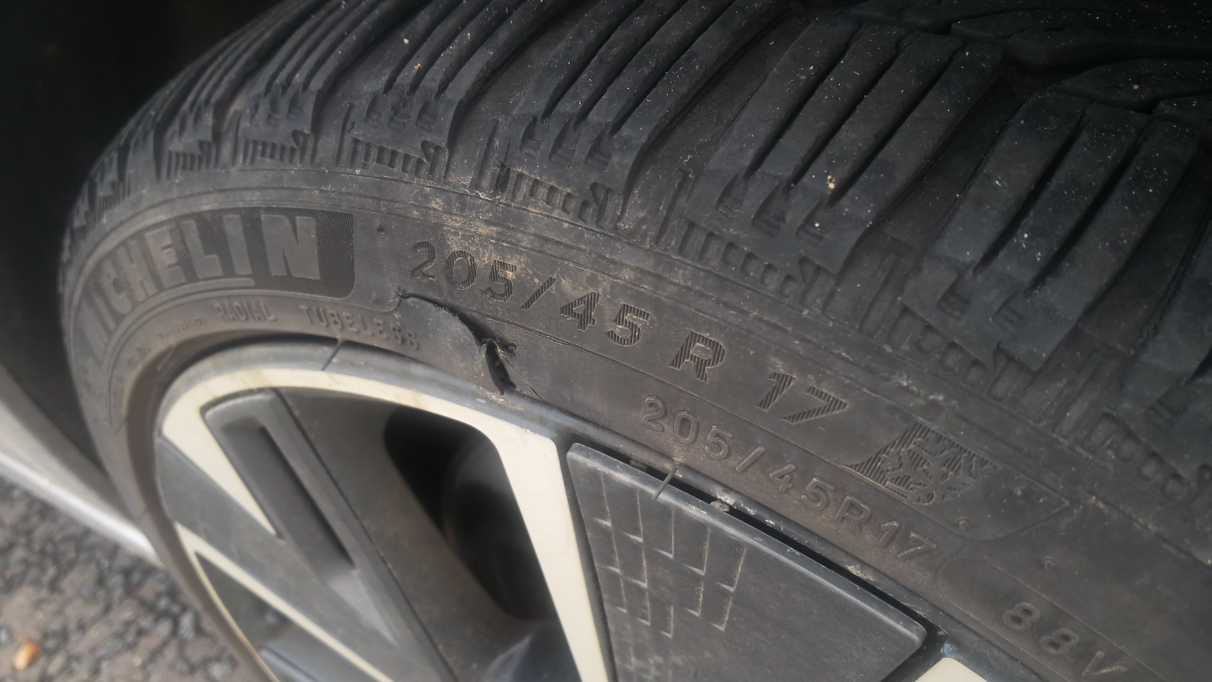

Just got a bulge on winter tyres i put on to replace the last winters i wrecked on potholes.  (I will keep one incase needed as a spare in the future, otherwise they are scrap.)
