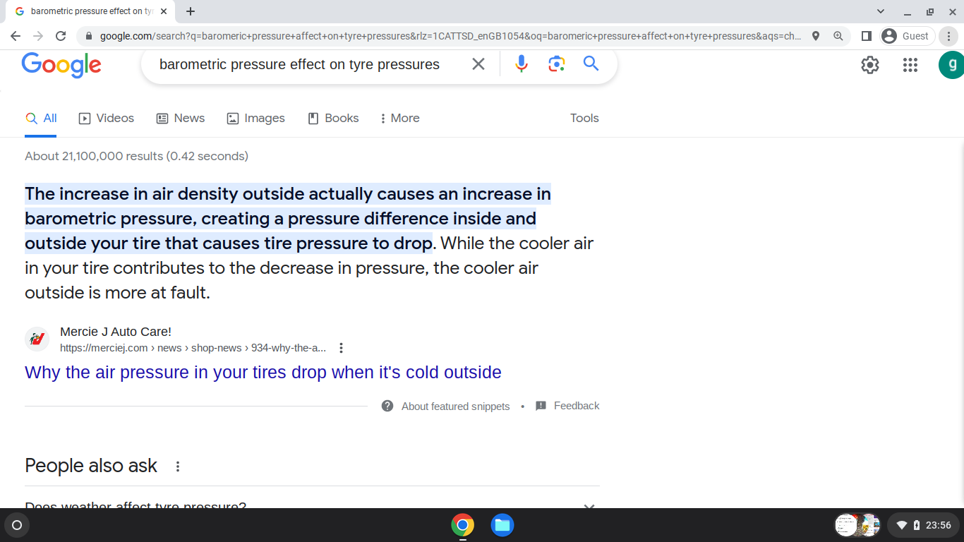

For example, if a car tyre's air pressure goes down from 35psi to 32psi in two weeks, how much the car is used or how many passengers the car carries is totally irrelevant. The air pressure will still go down from 35psi to 32psi after two weeks.
Some people incorrectly think that a car tyre will only lose air if it's driven. They say, why has my car tyre gone down when I haven't driven it much. They don't realise that a car tyre loses air pressure all the time, and that the rate of lose of air pressure isn't affected by how much they use the car or how fast they go or how many passengers they are carrying, etc.

Some peoples tyres lose no readable amount of air between each time they adjust pressures or check them.
Some cars sit for years going no place and the drop in pressure in the tyres is minimal.
But that the real world and not what some wish to have anyone beleive.

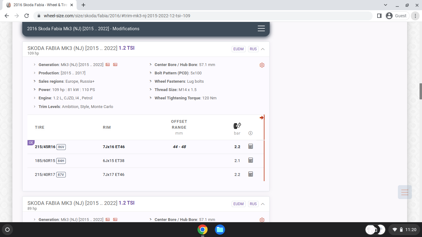

I think you might be getting a bit mixed up with sizes because of the silly mix of imperial and metric.  The wheel rim width (in imperial) may well be show on the inside side of the wheel.
XL tyres and normally for extra load, heavier vehicles perhaps load carrying passengers or commercial loads like vans, can be small car sized vans.
Some links to perhaps help explain.
https://www.performancealloys.com/tyre-sizes-information
https://haynes.com/en-gb/tips-tutorials/beginners-guide-wheel-sizes
https://tiresize.com/comparison/
Edited by nta16

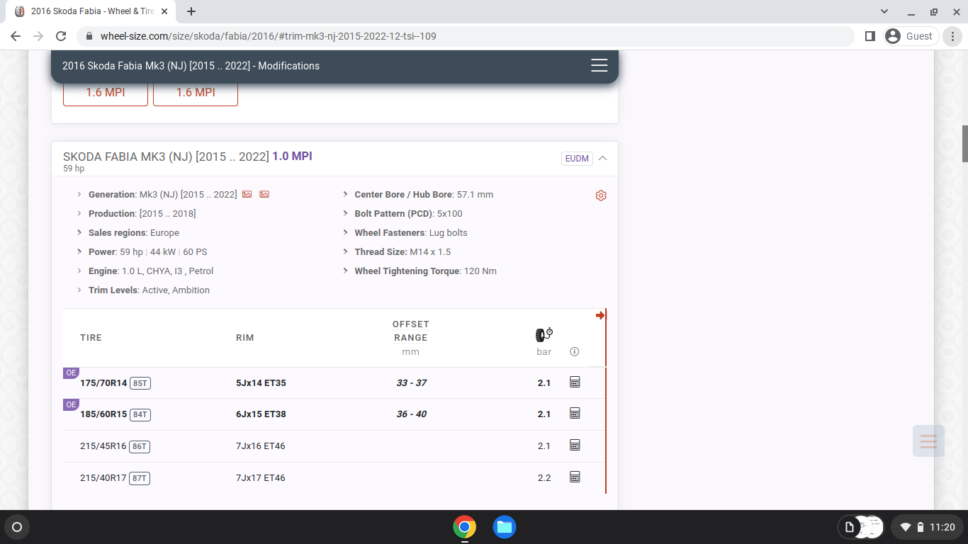

XL Tyres were fitted to Mk2 Fabia vRS or Monte Carlo including TSI's as standard.  All of 105 ps.  205/40 R 17's/
Mk3 came in 15",16", 17" and even the option from the factory of 18". 215's on 16 & 17" ones.
Edited by toot
