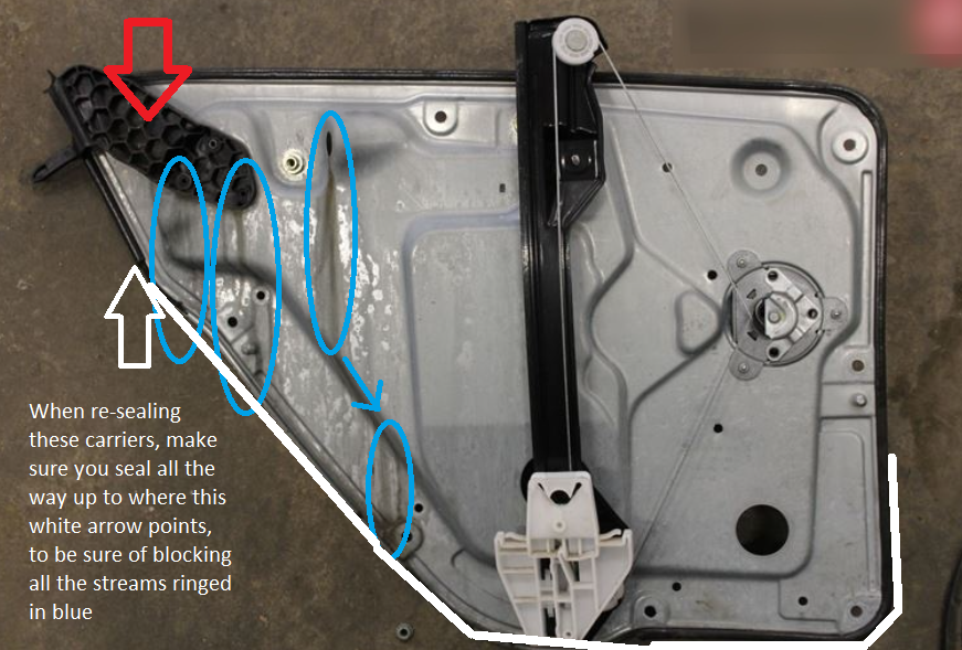

It'll mostly be the door carrier seals leaking, as per the link I gave you on Wednesday last week. The water slips under the carpet in the rear footwells and soaks the sound insulation underneath.

Remove the door cards and seal the rear door carriers as suggested by Pete. They are notorious for leaking.

If the rear doors are letting in water, then chances are they are needing sealed around the carriers. Mine had the work carried out under warranty in 2009 (for all four).

Take some photos of the sealing that has been done if you have the door cards off; going a long way up the rear edges is more important than most people realise.
See image below for explanation.
You don't have to remove the carriers to do a good job, it can go on with the thing still in place, just need to do a really good clean-up of the surfaces with isopropyl alcohol or similar to make sure the Plumber's gold has best chance of adhesion.
