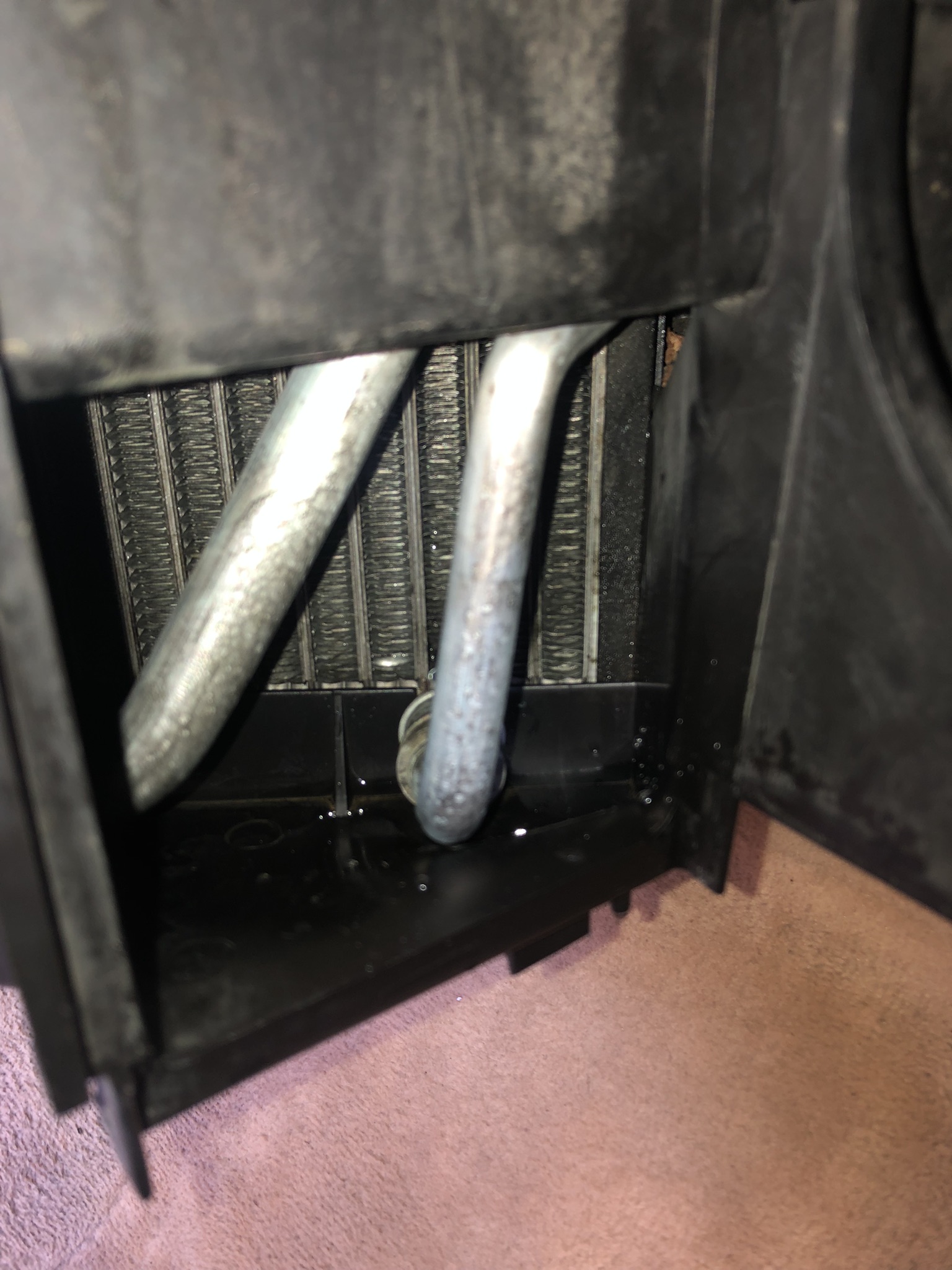

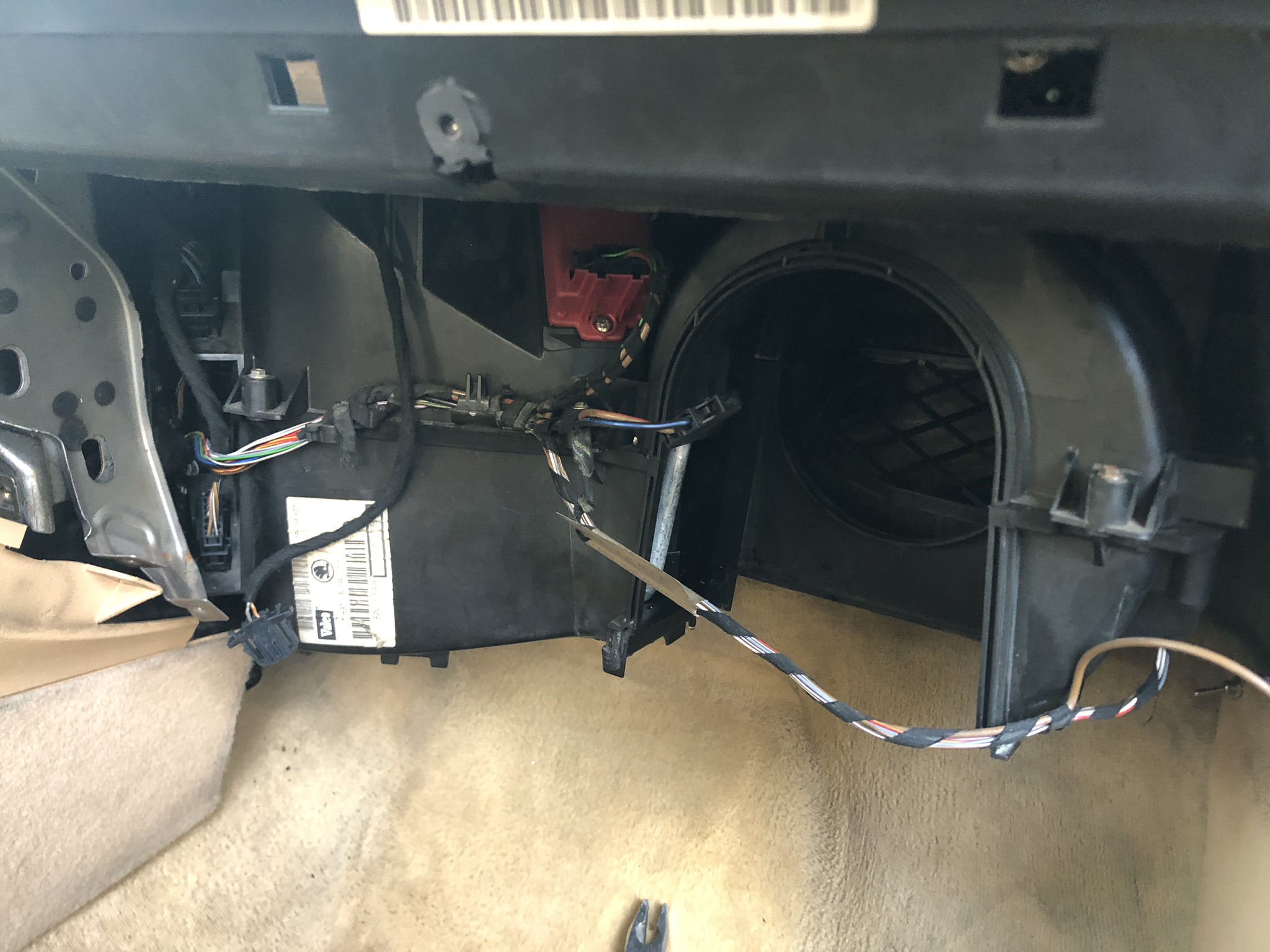

Does anyone know why i have condensed water here? Every time i use climate control and this is full with water. Thank you!
Check images:
  • Sponsor
Cos the evaporator is doing what it is supposed to, getting cold.
Cold air can hold less moisture than warmer air so it condenses out as liquid water.
If it isn't draining away, then find the drain pipe/hole and unblock it.
Normal function. As per @Breezy_Pete above, you may need to find and clear a drain hole. It's normally left of centre with the usual convention of left and right being when facing in the sirection of travel.
Yes, thank that helped me. I clean the drain.
