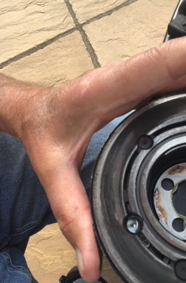

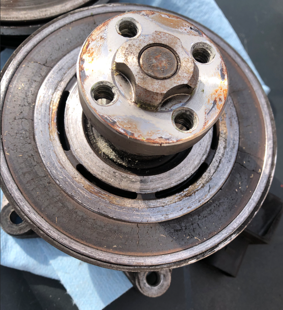

I recently (2 weeks) noticed a low rev rattle on the engine, we decided to investigate further yesterday and found that on the clutch plate for the supercharger compressor the rivets were loose allowing vertical movement circa 6mm
image.thumb.png.6ca16962563f355038c66a06d21e2458.pngimage.thumb.png.df45996dc2c3b12f59c3c661305335f7.png
This in turn had allowed metal to metal contact hence the rattle, changed pump, tensioner and belt, Alternator belt and both Tensioners now all good, car has covered 89900 miles
You can also see it was time to change the clutch (worn and cracked)
