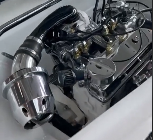

I have found something, take a look that black tube Γ style.
I wonder, he made it of bought it?
exactly the same as factory geometry

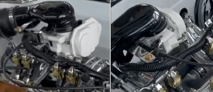

I removed that plastic cover today, i had to make an experiment.
This is the parts code in case that someone may needed in the future.
I also noticed this prominence inside,
i didn't want this to end-up inside the throttle so i remove it.
More about the experiment (..which failed) soon.
yeah thats from the injection moulding process
I hate that cover but i had to keep it.
After all these years in the left side has a small gap and makes a noise (like something is uncliped) which makes me extremely nervous but i can not ''copy'' the factory desing whith something else.
The experiment was i tried to ''simulate' the factory hose and the Γ shape of the factory plastic cover (Yellow line)
with a tube like this
which is very flexible, and IF the experiment was successful i would replace it with something more robust as a silicone or plastic hose.
After cut it in proper length, make the curb above the throttle and seal it in the bottom to be tight with the throttle body i slowly lowered the hood but there was a touch so i stopped.
For sure i didn't want to lower the hood, squeeze the tube and let it like this, someone may say: yes that's the factory design look, at a spot it's a bit compressed but there is no comparison to a hard factory plastic and a squeezed cheap tube plus every time i was lifting the hood the look of that tube would be bad.
So for now i will keep that plastic cover although i don't like it.

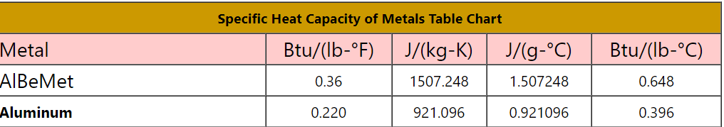

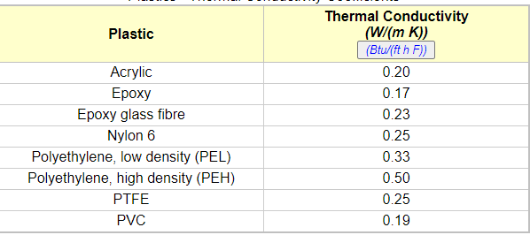

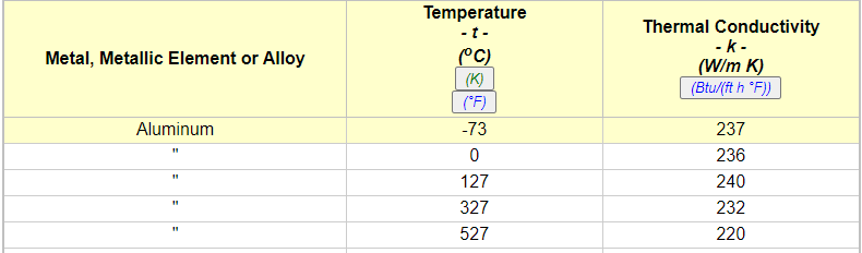

The plastic absorbs heat from the engine and preserve it
plastic does not absorb heat nor preserves it, it has way higher heat capacity and way lower thermal conductivity
So aluminum is 1000 times more thermally conductive
and plastic has a higher heat capacity which means you need more energy to heat it up per same unit weight, in fact approx 2 times as much!
I meant comparing to a chrome tube that some air intake systems use.
Supposed that reflects the heat and gets cooler sooner.

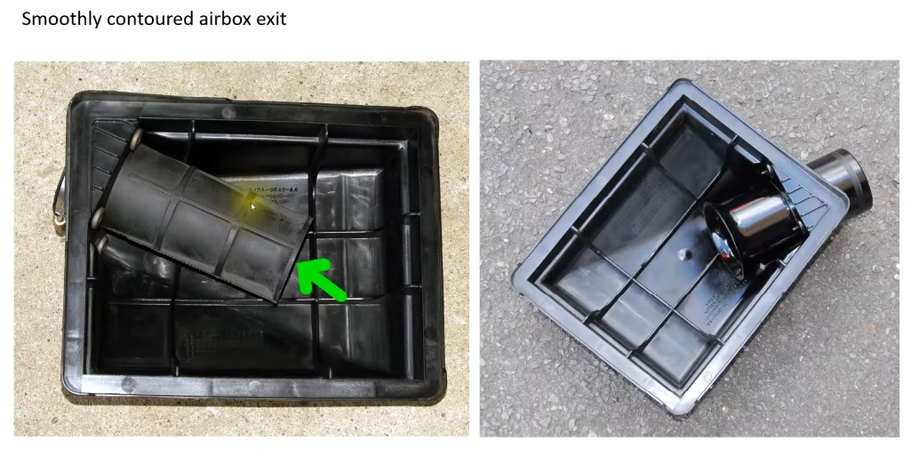

On 26/06/2023 at 13:42, Thefeliciahacker said:
The venturi in the airbox is to create a helmholtz chamber.
Other than that you want to let the air to travel as slow as possible to have the least amount of losses and then accelerate it near the inlet.
I want your opinion, pay attention to what he says in 9:50
On 26/06/2023 at 09:07, Papez said:
It was just best one to show the Venturi tube.
That's before and After, no cone shape just cylinder, is he right or there is a mistake?
