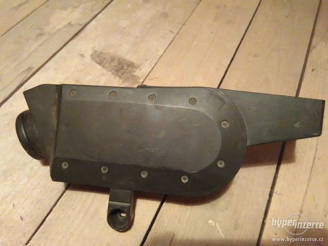

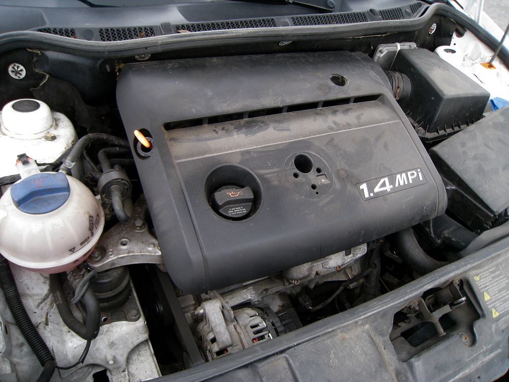

There's no engine cover on the 1.3 engine. It barely covers the throttle body. It's an intake pipe. The extra material is there only to create some structure between the mountings.
If it was intended as an engine cover, it'd look more like this.

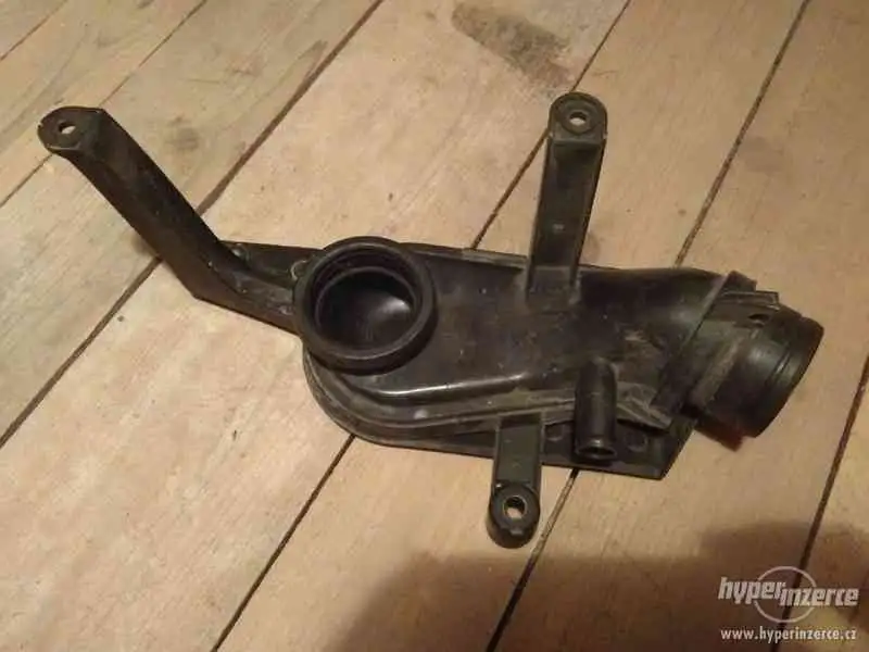

The throttle body is about 56mm wide and the end of the plastic tube of the air filter is 65mm wide, so there is some kind of ''funnel'' which is difficult to replace it with a hose.
The end of the plastic box has a gasket but even there is not possible to tighten the clamp of the hose.
I don't want to start a project making an aluminium adaptor to make the throttle body 65mm and the connect it with a hose with the air filter box.

Also, there's not much space above the throttle body, which is the reason why the factory cover is shaped in this way - I'm not sure whether would a normal L bend pipe fit.
But I've seen people cutting off all the extra material, leaving only the pipe - like this. But you can see that there's not a big difference.
I wonder why 56mm from one side and 65mm on the other, has something to do with the pressure that the incoming air is driven into the throttle?
One thread of the air intake manifold is damaged (has 3) plus every time i want to inspect-lubricate the gas petal wire-check the sensor-clean the throttle etc i had to remove 3 bolts plus the air filter hose.
Plus the plastic absorbs heat and takes time to cool off.
My guess is that it slows down the air before the sharp turn. It's more like a small plenum chamber with a 56mm outlet than a bent pipe.
Its going to speed up the air.
Its just an adapter as the filter box is designed for higher volume engines, needing more airflow and is adapted to the 1.3's tb

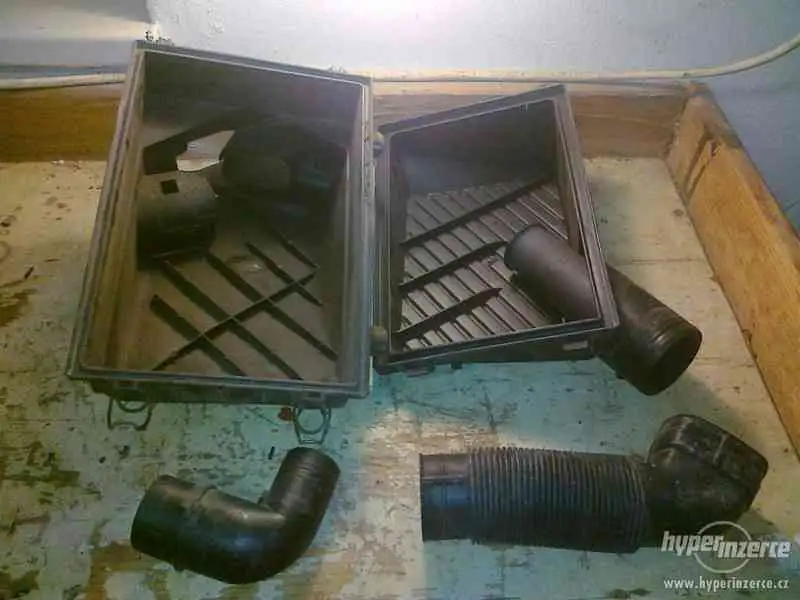

No if you open the airbox and look on the top cover you'll understand why.
I have seen has something like adaptor which narrows down the exit perimeter a bit, i haven't measure it if is about 56mm as the throttle.
It's a velocity stack used to tune the system
Something is missing at the exit to the throttle or not?
Yes.
