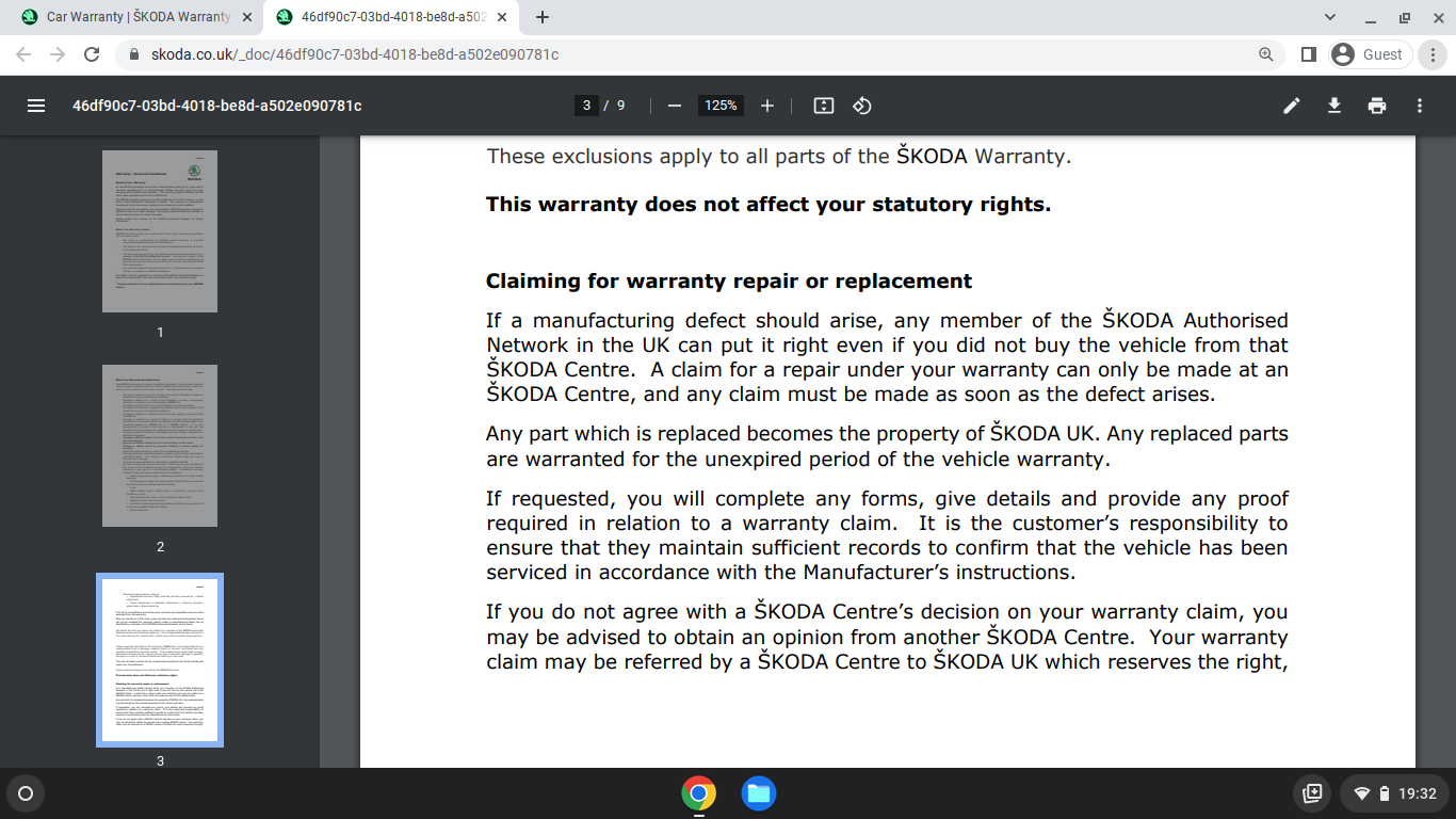

SKODA_Warranty_Terms_November_2021 (2).pdf

I did, particularly "This warranty does not affect your statutory rights,"

Parts replaced within a new warranty are guaranteed up until that warranty expires so not at all sure what you meant by your statutory rights? It doesn't just apply to Skoda or the motor industry in general, it applies to all goods you buy in the UK.
