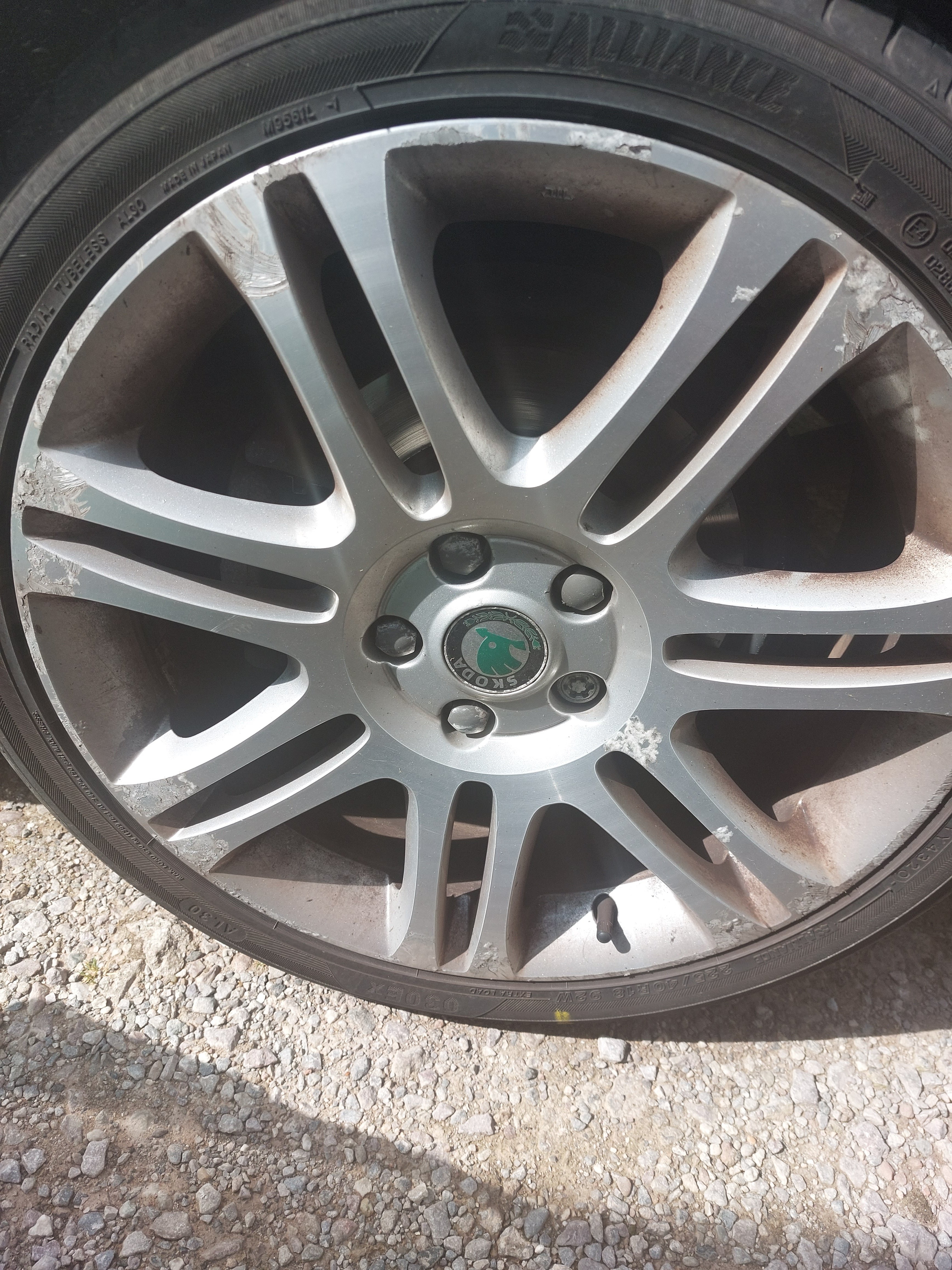

Currently have what I believe to be Themisto alloys on.

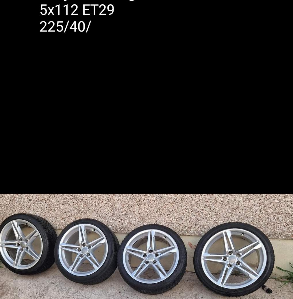

Looking to replace with the following Audi style 5 x112 ET29 225/40
Would they fit please folks.  ?
The elegance came with 18" wheels as standard with 225/40/18 tyres.
That picture is the standard wheel fitted to the elegance.
Are they 18 or 19" wheels?
Hi yes I thought that was the case.
Any idea if they're the same fitment  ?
18
18 inch
18 inch mate
They should fit fine then.
The offset might be slightly different but that shouldn't matter too much with them being an OEM wheel.
Standard 18" wheel on the Superb is ET40, so ET29 will be a bit further out towards the wheelarch. It'll increase steering castor a bit so you might find the steering heavier than you're used to.
So it's probably better to find some closer to the original offset ?
I doubt you'd notice any difference on a superb with electric power steering
