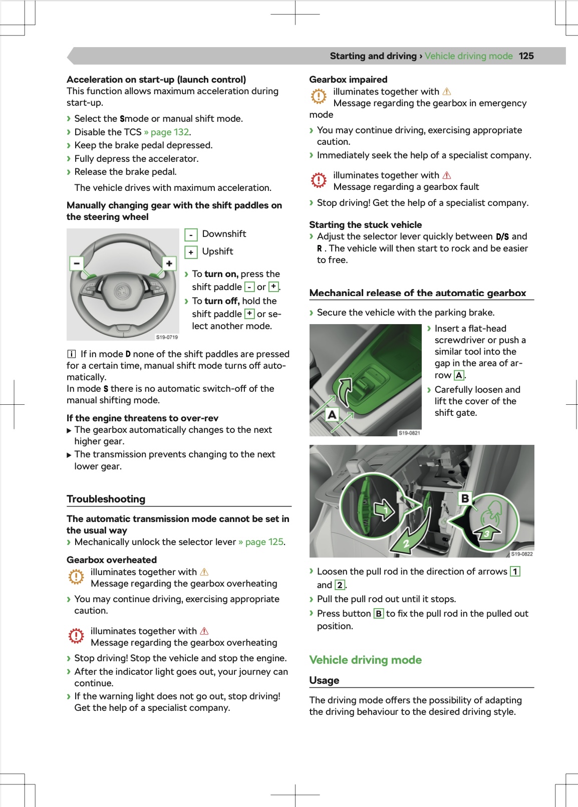

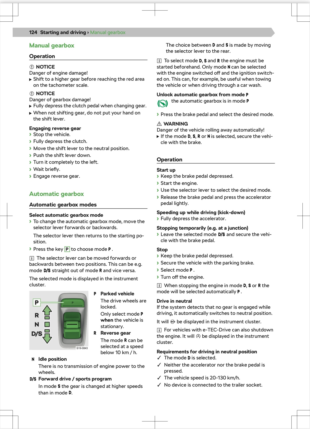

Mine is a manual, but I did drive a DSG Octavia Mk4 for a few months.
In S mode, if you use the paddles it stays in ‘manual’ mode. In D mode, it returns to auto after a little while.
Heres a couple of pages from the digital user manual I downloaded a while back…
