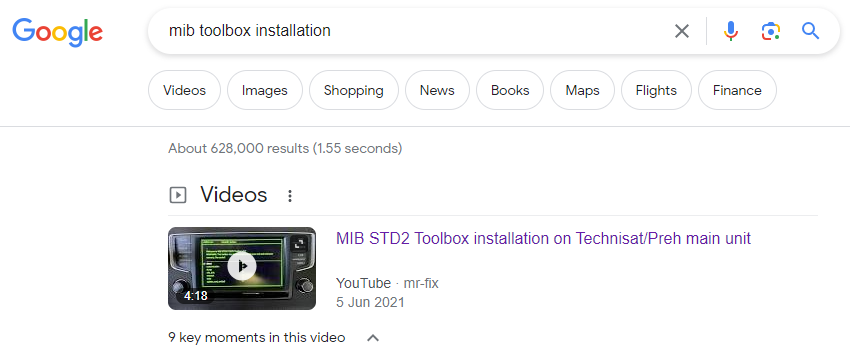

cool so that is a tutorial on how to use the toolbox to enable smartlink, now I just need a tutorial on how to install the toolbox
If only google existed to help folk find this stuff :D
Same chap as the other video.
Cheers, I'll make a written tutorial and post it here once I've done it
