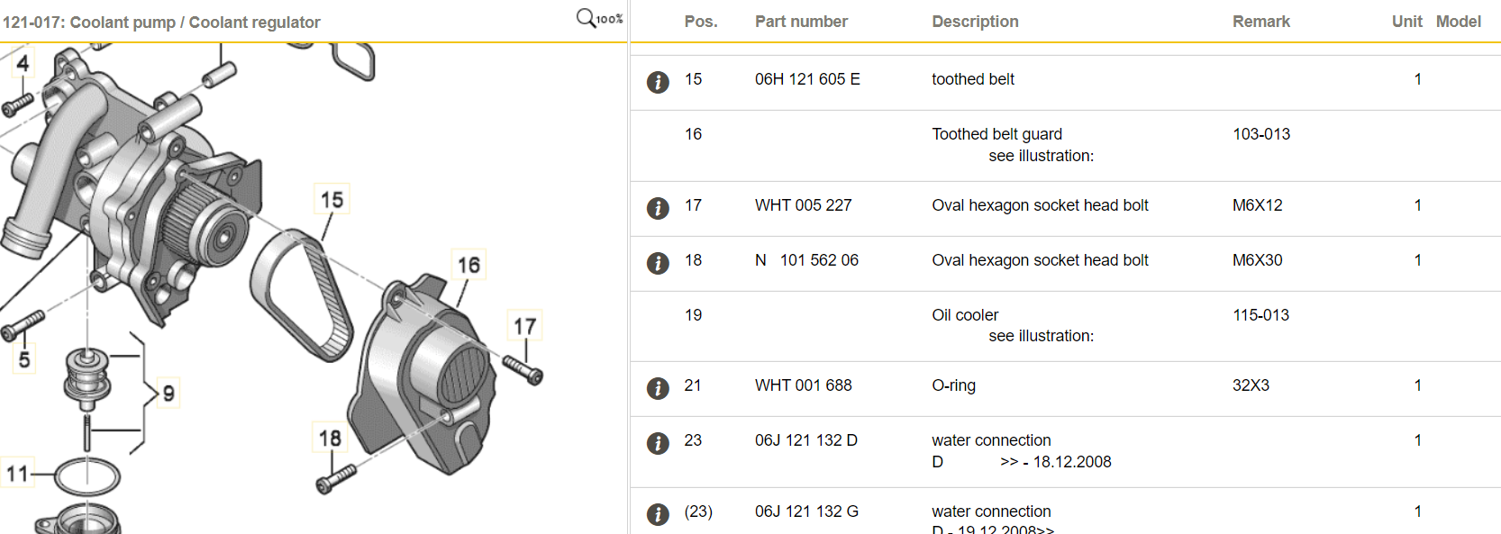

The last image shows a horizontally slotted plastic part just to the left of the thing you're holding; probably where that assembly is designed to be held?
The screws that are loose and missing appear to be items 18 and 17 here, but as it appears to be only a belt cover, I'm not 100% sure this will solve your leak, unless the belt runs wet?

Thanks. By the way, where can I find these diagrams?
