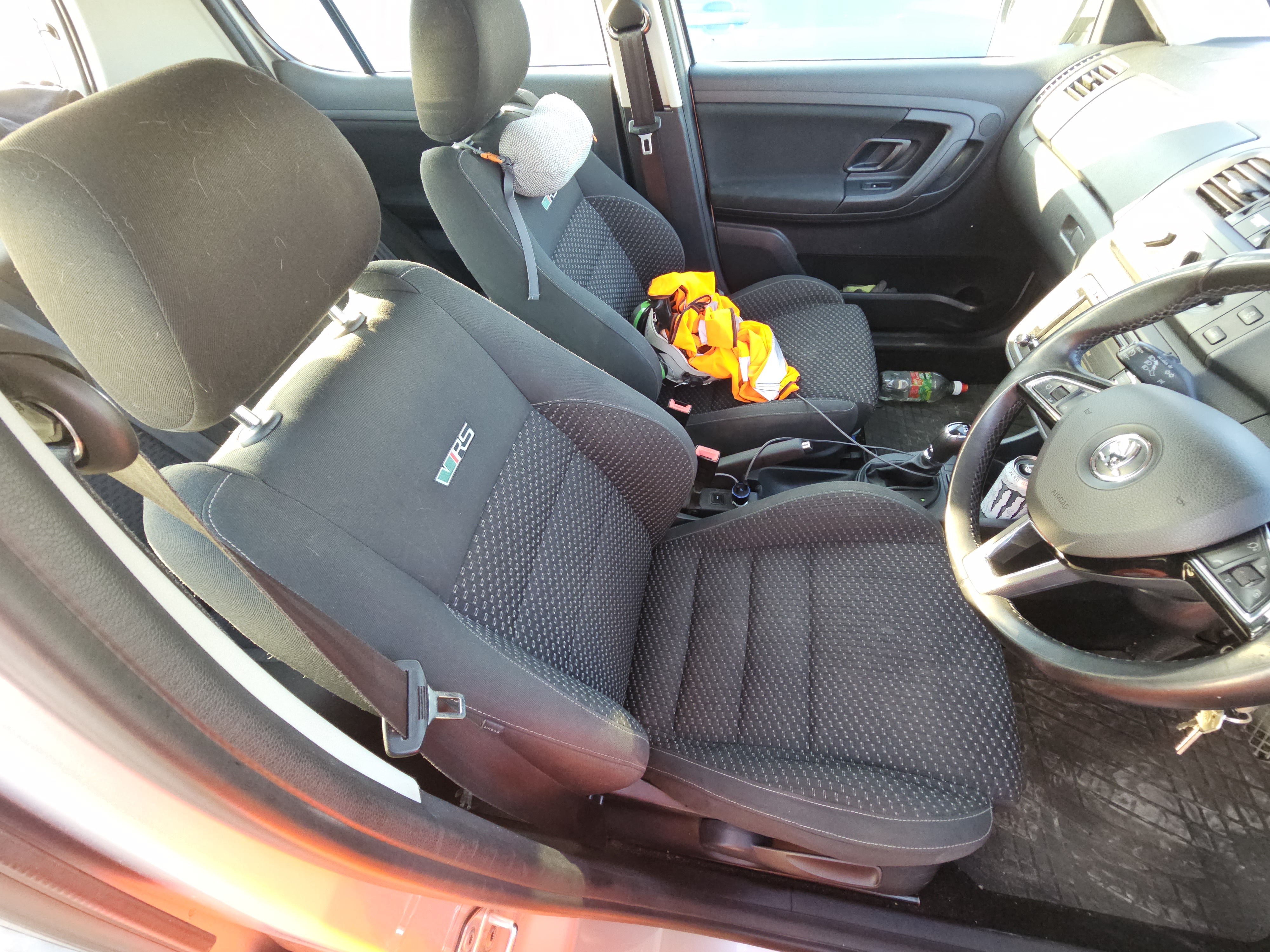

Vrs seats are pretty nice, very different feeling than the gym benches it comes with normally. Mine came with the under seat storage and heat pads. New drop links and i'm colin McRae in the twisties now. LED interior lights and auto switch for headlights are the next easiest things to do btw

Yes the standard seats are quite flat but the car is just a work mule on mainly A roads so not much chance of having fun lol. Still not a fan of the red tho I'd have the mk1 vrs seats but I doubt they fit and apparently the white is a pain to keep clean.
My mk2 vrs seats are the same black, but with white stiching and a vrs logo. Nothing in the "hard to keep clean" territory.

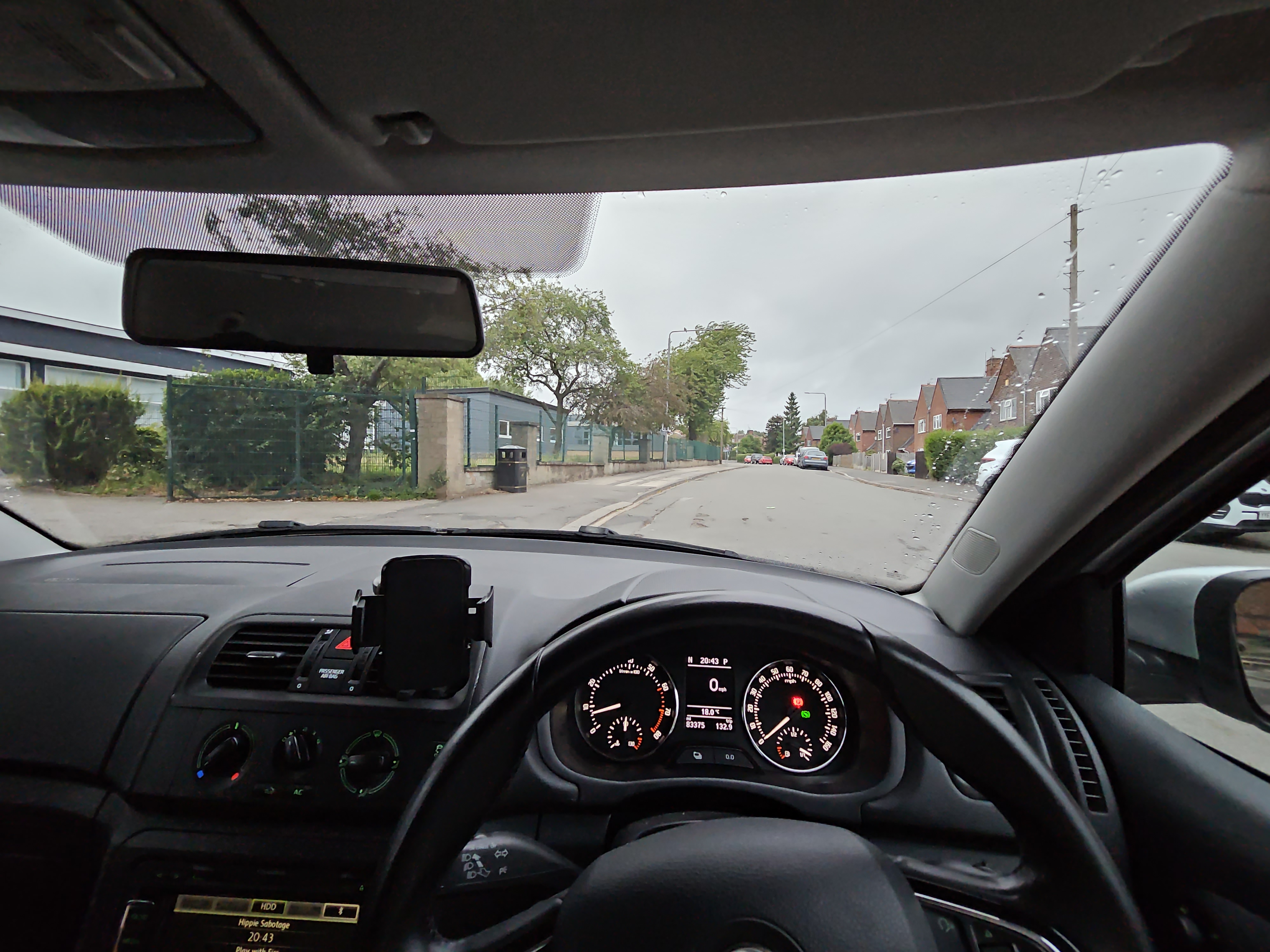

In this pic you can just about see the cable from the light sensor in the corner. Discreet enough for me
A nice install I just brought mine up in the corner it's hidden behind my phone holder. Also I installed my dashcam but I can't hide it behind the rear view mirror in this car as its so tiny lol.
