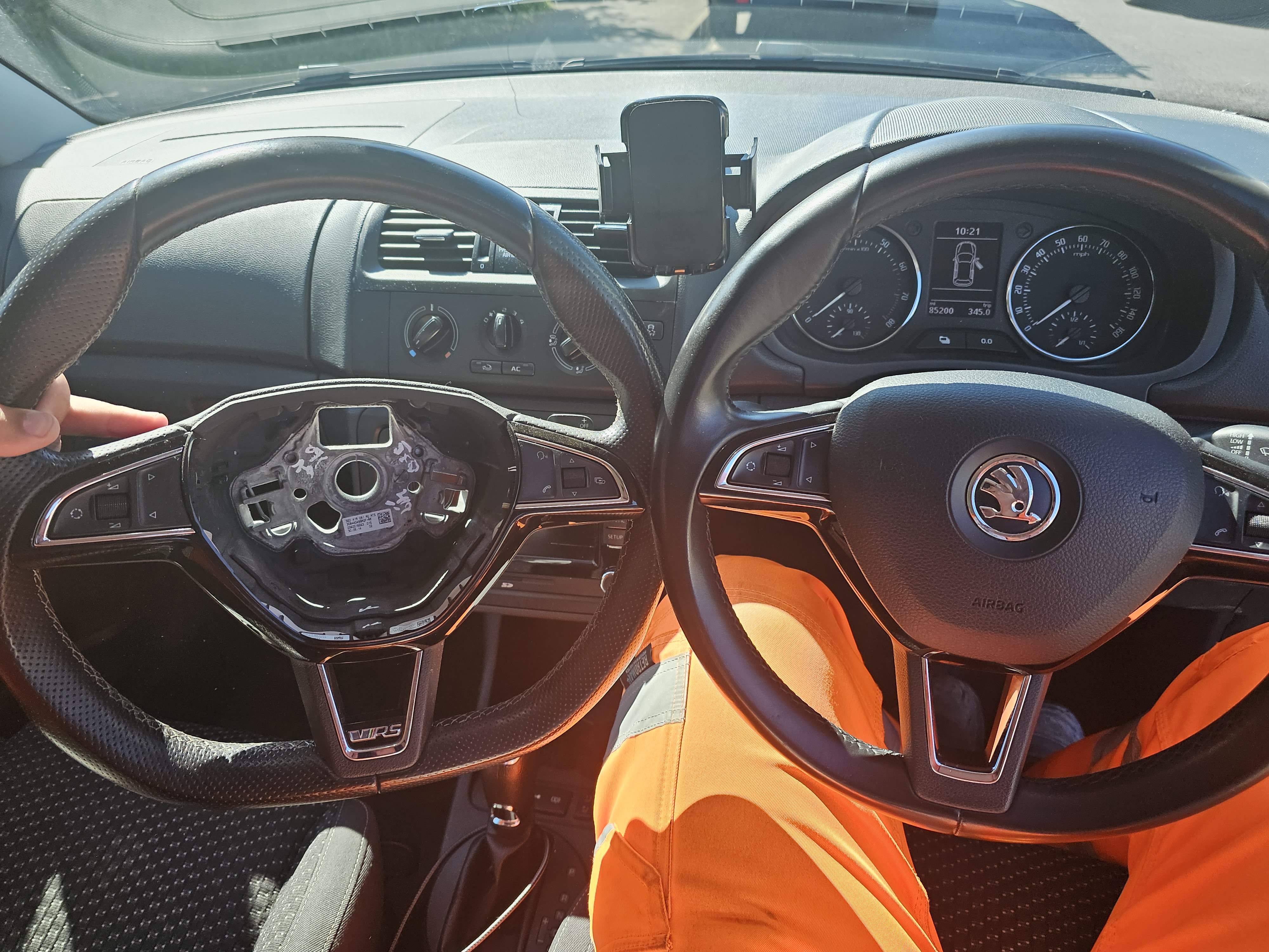

It doesn't but it can take advantage if they're present. For a low line cluster at the very least you can scroll through information shown and reset, then adapt the phone and voice command buttons to do something on an aftermarket radio
Oh I see that would be great I have seen a few of those wheels and I thought they were all for the mk3
Right one i have no idea what it came off of, but all buttons work and has no dsg paddles. Left one is from a skoda octavia mk3, buttons don't work (need a version ending in G to replace them soon) but dsg paddles work a treat. Swapped them over last evening
Oh very nice the right one looks like an elegance wheel.
