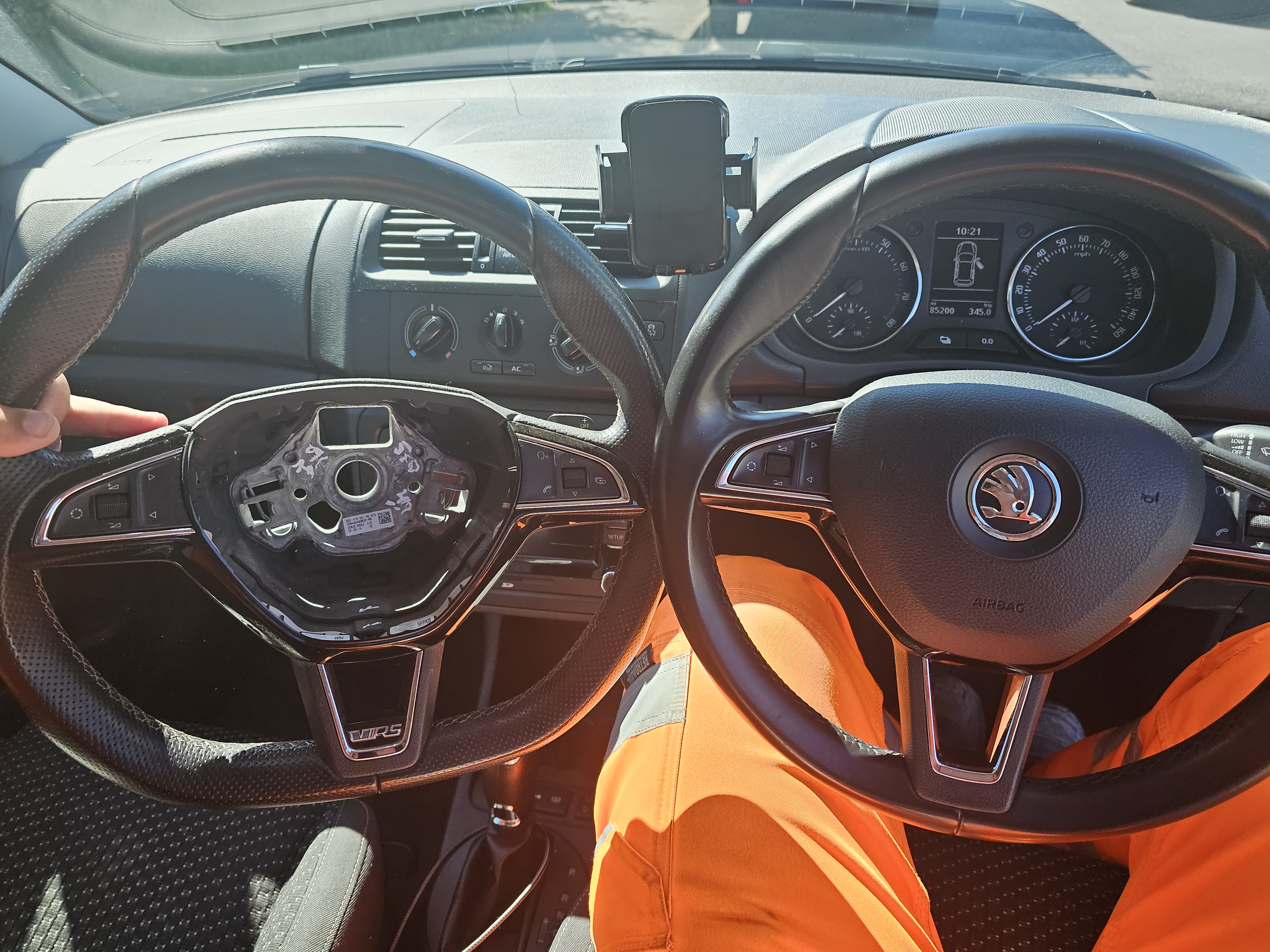

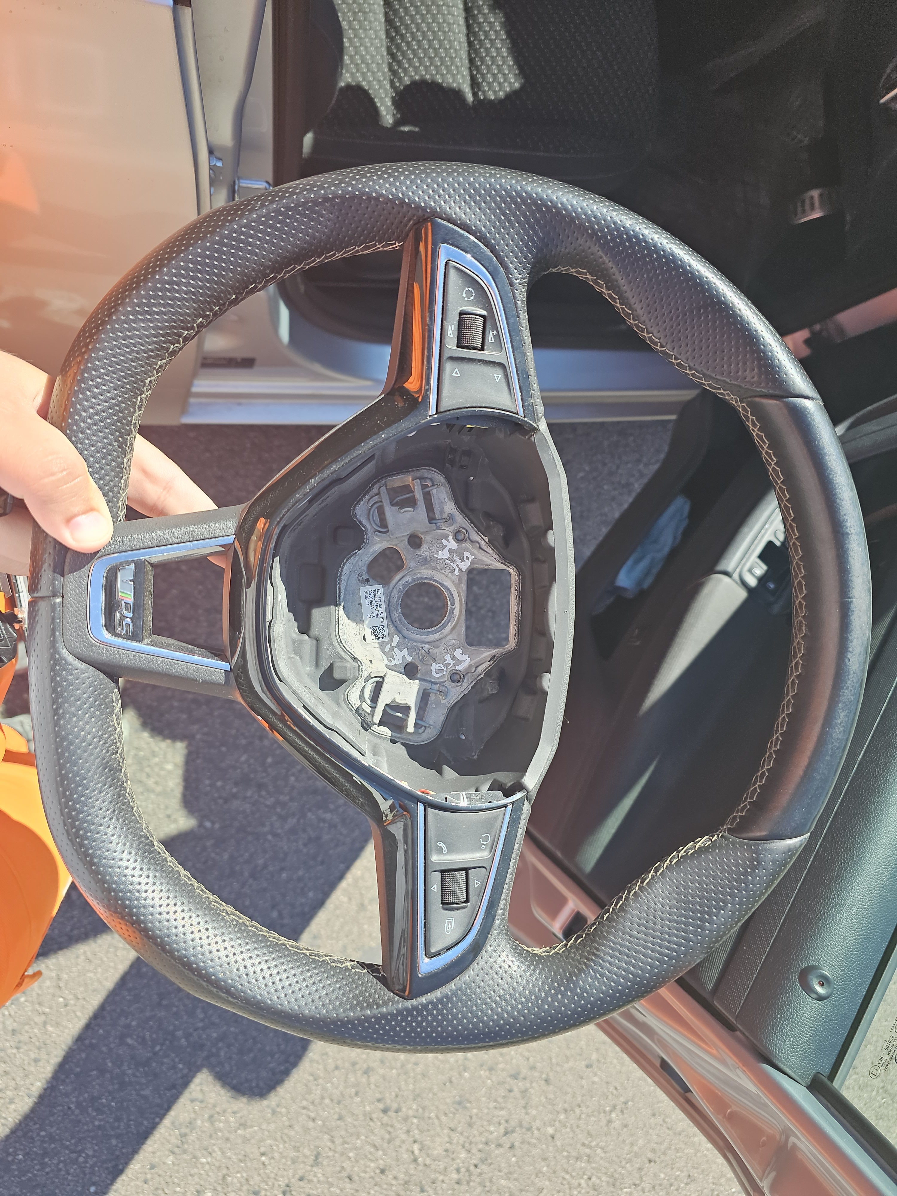

Upgrade 10.999?
This beauty, with dsg paddles. Unfortunately i seem to require a different set of buttons to make everything work, so not quite done yet.
If anyone has a set of 5E0919719G buttons, i'll be interested in buying them asap
