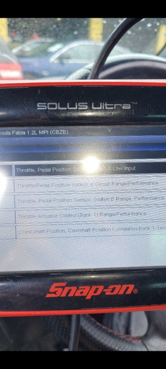

Hi guys/gals,
Does anyone know if the throttle pedal from other fabias will be fine in a 1.2tsi cbzb engine code monte carlo I know they look different but I cannot find a replacement for mine with the correct part numbers unless it has been superceded mine is 6r2721503d most I can find are 6q1721530a though m
Will one of these work?
Cheers

6R2721503D is a current part number that hasn't been superseded. I wouldn't bet on an older (6Q) variant working right, and a 6Q1 part will be a LHD pedal I think, so probably not going to even physically fit.
So I need to be looking for a 6r2 does the end letter have any significant meaning?
  • Sponsor
Yes. Match everything.
Why do you need one?
Ecp light is on and the codes are related to throttle pedal car is in limp mode and is Jerky clear codes and is fine for 1 to 10 minutes ignore the timing collation, timing chain has now been done.
