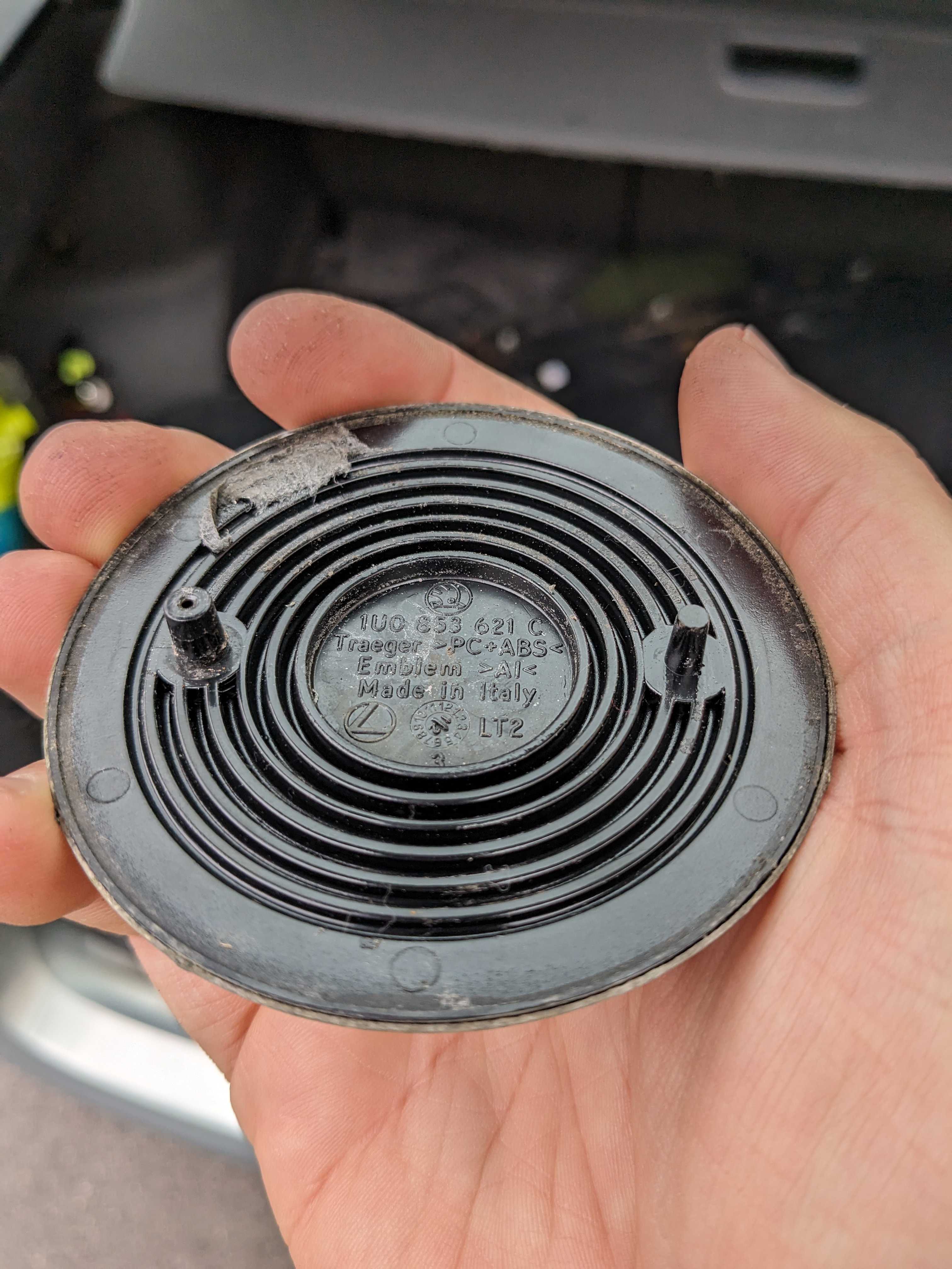

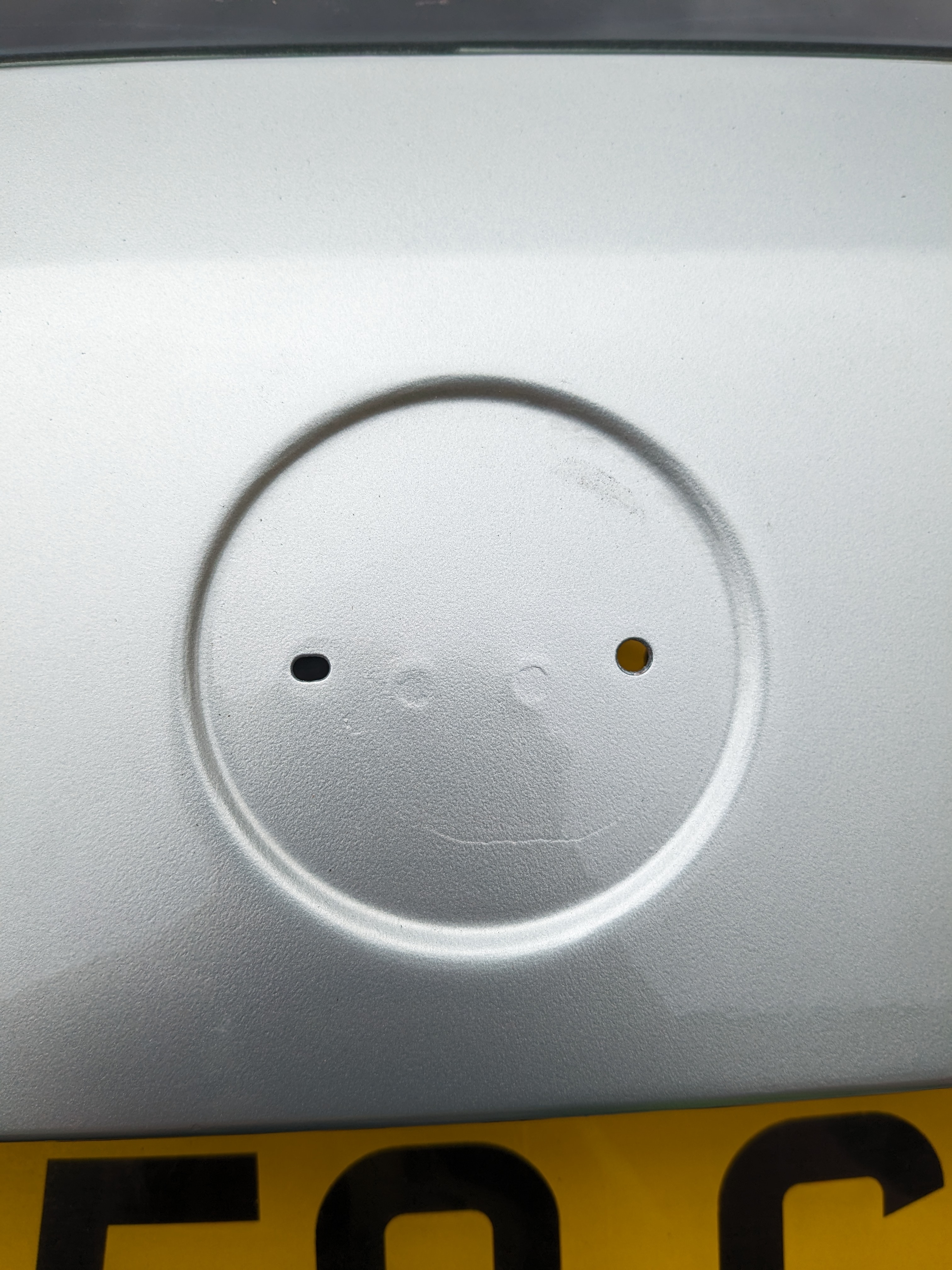

I've just had a new tailgate painted and have fitted it, but not sure how to approach remounting the badge.
As seen in the pictures, it has two prongs to fit the holes: PXL_20230809_150259678.thumb.jpg.5f2b8ed37bc7c743b7b664dc335f8b3b.jpgPXL_20230809_150248547.thumb.jpg.e3566f249e4baaea388c99490cc7e0ee.jpgPXL_20230809_150308156.thumb.jpg.00dafe47c8c47efdb00dbe7ab9706465.jpgdo I just use some double sided sticky foam to help it stay on? Obviously it need to be as waterproof as possible...
The prongs aren't threaded or anything and I can't see any screws left over to secure it at the back
Any experience or tips much appreciated!
Yes, a sticky pad is needed but I've always used double sided carpet tape to good effect, it's even stronger and stickier!
Best stuff I used was the number plate sticky pads cut them into the shape needed give the badge a good clean with alcahol and the same with the tailgate if it's a sunny day no problem if it's a cool one just warm the tailgate before sticking badge on with a hair dryng  NOTE get it correct as you will break the badge trying to get it off if wrong
